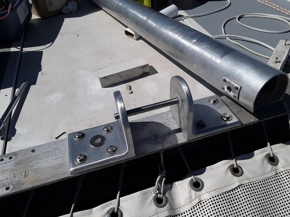

Hi,
Thanks for the reply! Elliptical is an interesting suggestion. The deflection is a third of an inch not 3 inches. I was thinking of reinforcing the part of the beam where the mast is stepped as well. The problem is, how do I fit some thing 6 feet into the middle of the inside of the beam.
I had an engineering friend suggest I weld a plate on top of where the mask goes to spread the load out. I like that idea.
Sorry, my mistake, 0.3" is also a big figure for let's say 3 feet.
Weld the plate but not on top but below the beam.
Good idea on welding it on the bottom. I believe it was .376” deflection over the full 12ft of the beam.

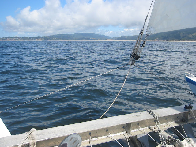

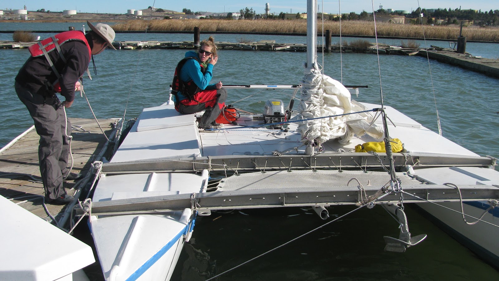

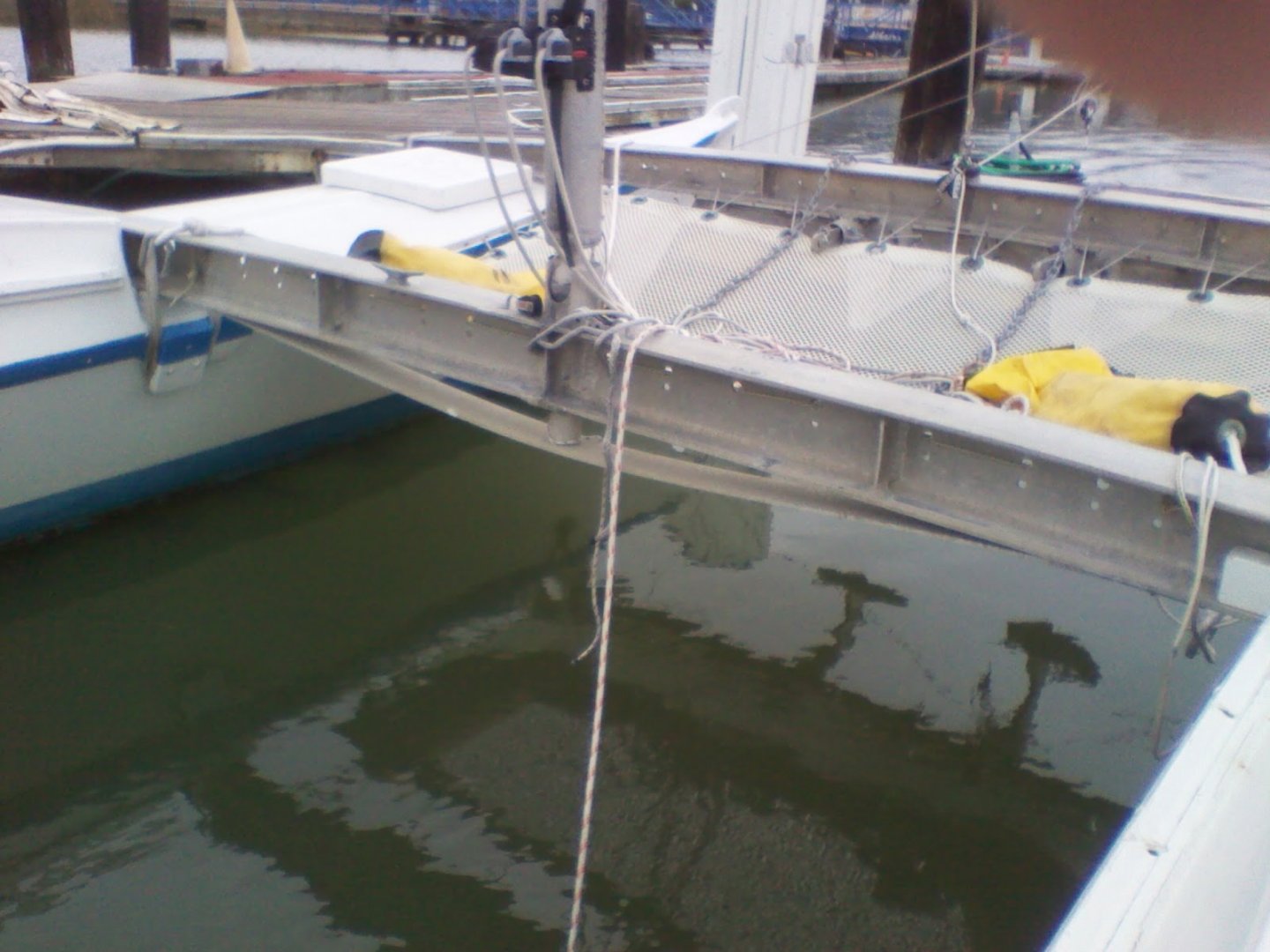

Hi,
Love that aluminum beam tiki out in the Bay Area. I studied that blog pretty well and I’m copying that mast base almost exactly for my boat.
Thanks for the link to the crossbeam question on the Wharram forums. I skimmed over that post previously, here’s my take: the Wharram community is wonderful. Like any niche community there are a lot of purists and naturally there can be resistance to change especially from wood to alum. Ironically the tiki 8m and several 21s and 26s have alum beams. As for as middle alum beams I know of there are 2 that have been sailing a while (Little Cat in the jpegs and a Norwegian 21). Then there are 3 that recently converted that race with larger than normal rigs consistently.
What was considering for the middle beam was 4x4x.1875” wall instead of .125” wall.
