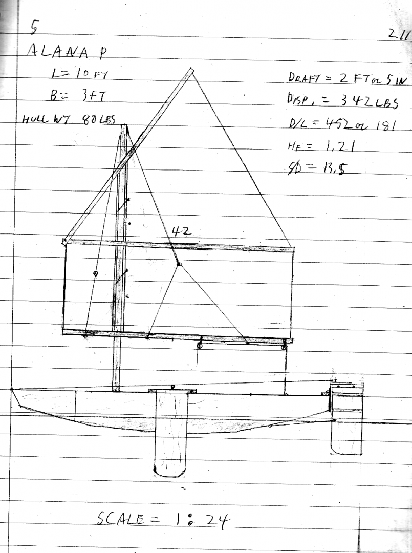

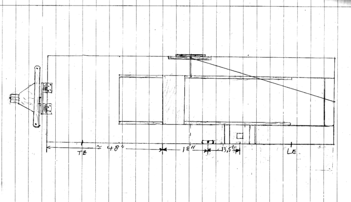

    I believe he sailed a Wayfarer. It is a very good boat. But I think a Bermudan fractional sloop is not necessarily the best rig for windy conditions. The reason for this is that, when reefed, a lot of bare mast is left exposed. And all of it is high up where the wind is strongest. In my book about working sailboats, I have noticed that the Bermudan rig was rarely used. When it was, The sail was usaully very low aspect ratio, or if of higher aspect ration, two were used. On some sharpies, two sprit boom Bermudan sails were used during the summer. During the winter, one of the sails was taken out, and the other was moved to a mast step near the center length of the boat. I can imagine the sprit snotter was tightened up in strong winds to the point that the sail was nearly dead flat.
    Now, I would never advocate deliberately sailing in absolutely crazy conditions (big, menacing waves along with screaming gusts). But I recognize that in some regions one either gets a lot of wind or almost no wind at all. And often this is on small lakes that don't develope big waves. The scow I designed and built was intended to sail on such a lake. The sail, when reefed, loses a little less tha half its area (which is on the low side of moderate to begin with). what is left is a sturdy boom Lateen sail, which I hope is big enough to still drive the boat to winward.

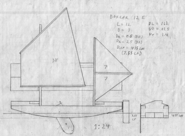

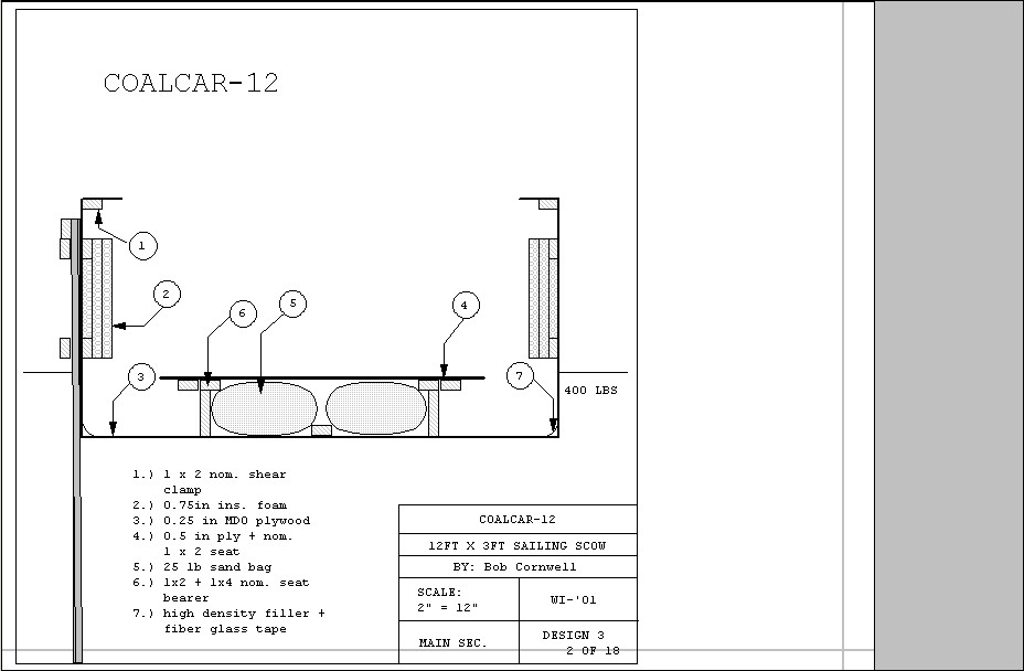

    Here is another design of mine. As I hope you can see, the hull is the same as the 12 footer I posted earlier. The main differnces are the deck design and the rig design. The deck has a considerable pitch, like that of a house roof. This is so that it will shed water very quickly if it should ever shunt under. This (I hope) would prevent pitch-poling. The rig is two masted to get the center of area lower and to have a good deal of control, even without a rudder. The yard is peaked higher, so when its reefed down to the boom, it forms a boom Lateen sail with a horizontle center of area pretty much where it was when the sail was full. The mizzen is really two sails, with one set below the boom and one above it. This way, the top one can be completely struck while leaving the bottom one full. This design was intended for the Everglades Challenge.
