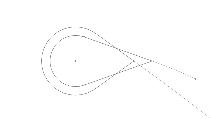

    I have just started building a 10ft Spindrift from B&B yachts. The sail has a luff sleeve of 100mm wide, constant from foot to head.
    The plans for the mast calls for a round wood section that tapers from 56mm to 42mm dia. Attached is a sketch that shows what the resulting leading edge will look like at the foot and head of the sail.
    Is there any merit in altering the mast section from a simple round section to something with a shaped leading edge profile, either parabolic or approximating the leading edge of some airfoil? I am only really interested in improving L/D, not so much on boosting CL-max.
    I have the option to either fix the mast to the hull and just let the sleeve rotate about it or let the mast rotate with the boom (as on the Finn).
    Could the blunt diamond section that Arvel Gentry developed for fixed masts perhaps also work with a sleeve?
    I have some glass braid and carbon UD tape so making the mast a little thinner is also an option.
  2. PAR
    Joined: Nov 2003
    Posts: 19,133
    Location: Eustis, FL
    PAR Yacht Designer/Builder
    Drop Graham an email or give him a call. He's approachable and knows the design well.
    A round mast will have uniform bending moments, while a tear drop or other shape will not, making getting uniform sets across all points impossible, if the mast was fixed. If it was permitted to rotate, bending moments will still vary, but because the bend would (relatively) come from the same angles, less a problem. If you elect to re-dimension the mast, you should do the math in both diameter and sectional area, to insure it's strong and stiff enough, with a reasonable margin, but able to take advantage of the weight reduction potential.
  3. Will Fraser
    Joined: Feb 2014
    Posts: 170

    Thanks for the reply PAR,
    I realise that there are a number of structural implications, at this stage I just want to establish if the concept has aerodynamic feasibility.
    The luff on foiling moths look like they provide beautiful leeward tangency from the mast round to the sail - do they use profiled masts or is the shape simply achieved through a wide chord on the sleeve?

    The Moth masts are all over the place in the approach and methods they employ for orientation and construction. The SpinDrift you're building wouldn't be able to take much advantage of an improved leading edge treatment. A rotating mast with the sail on a slide or a fixed mast with a luff sock will do well, given the limitations of the design. I'm fairly sure Graham intended the mast taper to save weight more than entertain sail top washout or other bend and set considerations.

    I've been sailing with sleeve luffs since the '80s, as well as with wing masts. On a boat like the Spindrift, the amount of performance you'd gain by getting a luff sleeve working perfectly would probably be about as much as you'd gain in the 26th week of doing hill climb repeats on a bike to improve your hiking, or during your 18th session of intensive roll tacking training if you were sailing 5 days a week for 6 months. In other words, the aero improvement would be so minute that you would only notice it if you were sailing the boat better than about 98% of people had sailed when they were having the best race of their lives in a class they had been sailing for a decade.

    I see no advantage and possible disadvantages to a tear drop mast as PAR said. Unless the mast and sleeve combination approaches a true wing mast shape, the simple round mast is a good one. Aluminum Spindrift masts are specified in a smaller diameter upper section so that does tend toward a taper.
    I built and raced one of the first Spindrifts in frostbiting and many other events, usually racing against Graham. It is a great little boat and the perhaps the smallest dinghy that sails well with an adult male aboard. Although we sailed against many of the other 10 footers and some purposely built to beat us, neither of us ever lost a single race to them. Needing to carry up to 200lbs, it is not optimum for either speed or pointing ability. A bit too fat for either so I consider it folly to spend lots of effort to mess with a good boat. While you are thinking about the minutia, you will miss tacking on a header and drop way back in the fleet.
    Build it as designed, shape the foils properly and go sailing.

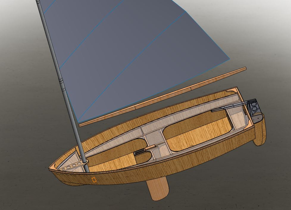

    Would you post a little pic of this famous Spindrift, it could be helpful to trigger suggestions.

    Tom I am glad you chimed in. Only 200lb, you say? I am 230, so now you have me hesitating. I had just marked out the hull bottom and topsides earlier today. I will be building out of honeycomb sandwich, so I hope to knock off around 20lb of the stock weight.
    I chose the 10ft over the longer options because the beam fits nicely on my roof-racks. For me the sensation of speed at a high-ish Speed-Length ratio gives me just as much thrill as outright speed, so a short hull does not bother me in principle. But if I am too heavy for it to ever really get going then perhaps I should consider something longer.
    I had already started a thread on the Messingabout forum about a 13-14ft Core Sound option and Graham has indicated that it is worth looking at, but that will be a bit more of a cruiser. I still want a light minimalist dink with the option of car-topping, so the beam is fixed (1.28m). I already have the sail, so there is no point in adding more sail carrying capacity. It also means SA/Disp is fixed at 68sqft and roughly 330lb. How much benefit would and extra foot of length be?
    I have a very complete CAD model so I can stretch, scale and tweak the hull shape as required. I guess now is the time for me to dust off all those articles about important ratios, pull the calculator closer and sharpen a pencil...

    At 330lb, these are the vital stats as measured on my model:
    LWL: 2.8m (9.2ft)
    BWL: 1.13m (3.7ft)
    Waterplane area: 2.4 sqm (25.8 sq-ft)
    Wetted area (clean hull only): 2.54 sqm (27 sq-ft)
    Wetted area (with foils, skeg): 3.2 sqm (34.4 sq-ft)
    Half-angle of entry: 28deg
    Quarter-beam buttock angle: 4deg (buttock tangent at transom: 6deg)
    Deadrise: 9.9deg (midship), 10.4deg (transom).
    Prismatic coefficient: 0.63

    The only dinghy-specific metrics I could find was more focused on sail-carrying capability, max beam for hiking power and low wetted area. It had no metric that took lwl into account, so clearly it is aimed more at hardcore racers with big asymmetric spinny's etc.
    I tried to compare SA/D and D/L ratios with the likes of the Laser, RS Aero, RS Tera and my own heavy 13ft Gypsy (a local class).
    With me on board, the Spindrift has a SA/D of 22.3 and DLR of 190. The short LWL makes it impossible to even approach the DLR values of all the longer boats. If I go on a bit of a diet the DLR will match that of an RS Tera Pro with a crew at the heavy end of their recommended weight range, although SA/D for the Spindrift will actually be better (the Tera Pro with 70kg crew has SA/D of 18.7)
    Another interesting metric that I found in an article from BCA Demco is called the Hull-planing-index = weight [kg]/(LWL[m] x Waterplane Area[sqm]). A value of less than 15 is desired for easy planing. The company is a key player in generating designs for the Italian Diecipiedi (i.e. 10ft) class. The point he makes in the article is that it is very difficult for a 10ft-er to plane with an adult. The Spindrift's index is 22, compared to 14 for the Tera with a 50kg crew and 10 for a Laser with a crew of 70-80kg.
    I think I will build the Spindrift as is. If it is a real dog with my weight on board (which I doubt, given our typical wind strength) I can always use it as a club trainer for the kids to sail two-up. It will also make a perfect intro boat for ladies, the sail even has a reef-point to keep things docile.
