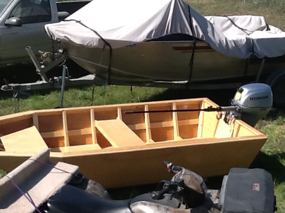

    Almost finished skinny water boat
    Well after 8 months of work, here is the almost finished project.

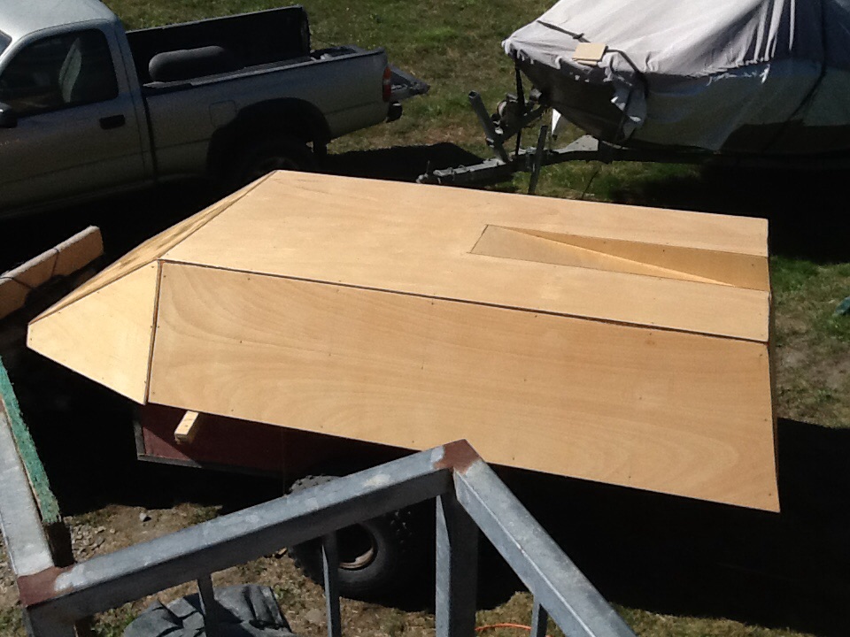

    Tunnel
    Here is a look at the tunnel
