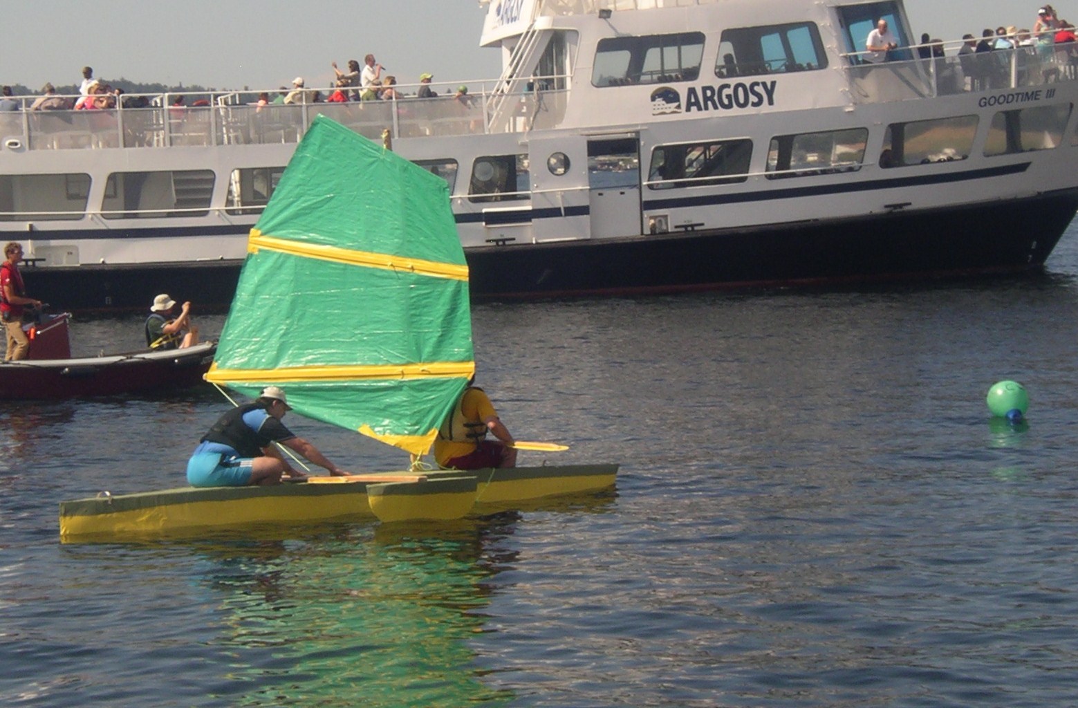

    to build a 16 ft skin on frame kayak it takes one 16 ft 2x10 carefully selected from home depo lumber stack (about $20). it is all the wood you need, it is ripped down on a table saw into stringers and ribs. The only other thing you need is some dowel stock (chop sticks work, but it only cost about $2 to buy one), and lashing cord (about $6), heavy nylon or polyester fabric, typically about $30 from on line suppliers, and than wood finish and oil based paint to seal the skin, about $30. Less on sale, or I like to buy the "mis-tinted" paint for $1 per gallon. Also, both lumber and paint is easy to salvage.
    You can buy a lot costly deck hardware, rudders, seats, and other crap you do not need, but I either make it from scratch or use webbing and cord for gear slings, carry handles, etc that costs next to nothing. It uses no fasteners other than to lash the frame with polyester lacing chord (stronger, faster, cheaper and lighter than metal fasteners), and it uses a small amount of glue in some of the joints, either Tight bond III or Polyurethane glue, epoxy can also be used but it is more troublesome and costly.
    where would the costs be higher? I have built perhaps 30 boats this way, some were as cheap as $35 out of pocket, using salvaged materials, the most I spent was about $300, an all plywood dingy (stitch and glue).
    Below is my wife's skin on frame kayak that cost about $80 to build. And two different skin on frame trimarans we built for a contest that cost less than $200, buying all new materials, including tarp material for the sail.
    Building durable boats does not have to be costly, you just have to get creative on finding suitable materials, and designs that are less costly to build.
