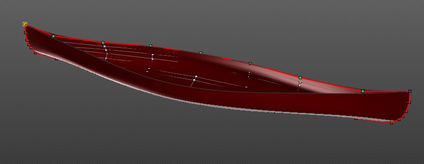

    canoe1.JPG canoe2.JPG What would be the noticeable performance differences between these two? (flatwater, average paddling speed, 3mph maybe)

    I don't think that the 'kink' in the hull amidships of the green deck version will do you any favours - if both boats are the same size and displacement, I would have thought that the brown one on the left would have slightly less resistance?

    Certainly it is optimal hydrodynamically but best fits the material I intended to use. Haven't learned much about boat design yet. Which properties are most relevant to the performances of a canoe? Thanks

    Preferable to minimize water movement turbulence / eddies that might be created by hull shape disruption to the flow. For example, square back canoes have additional drag from turbulence off the stern, is my understanding. Does SOF construction introduce some significant turbulance because of material flexing or possible faceted surfaces at 3 knots? Just some humble thoughts from a tinkerer...

    So cool that you have gone this quickly to real designs and modeling! And you are above my level on the latter.
    Looks like you have moved entirely to a flatwater design. I assume you know that on large lakes, as well as the ocean and bays, waves are not flatwater.
    The red one certainly looks a lot more like a traditional canoe, so would be the more conservative design.
    Have you attempted to assess stability with you and/or your partner and gear in the boat? Obviously, that depends a lot on what type and position of seating or kneeling arrangements you have planned. If the software you are using only takes into account the boat, and not what is inside, it won't give accurate results, especially since you want a lightweight boat. E.g., your bodies will effect the center of gravity, and the way wind interacts with your boat, and if it tips enough, your bodies and gear may shift to the low side of the boat.
    It is not uncommon for water to get inside a canoe, by a variety of means. E.g., if your boat tips, either of your designs will let in a lot of water. The movement of that water can affect stability too. One reason some people sometimes choose canoes over kayaks and surf skis is that they hold more stuff. The shifting around of that stuff also affects that stability, unless you tie everything down. Whitewater open canoeists often fill most the empty space with strong airbags, in effect creating a closed deck boat, but flatwater canoeists rarely go that far. Though if the boat fills completely with water, some airbags or foam are necessary to prevent sinking. In fact, I'm not sure it is legal in some jurisdictions to have a boat without some foam flotation.
    Also, if it tips, have you attempted to assess how easy it will be to tip back upright? If you are in deepwater, you can't rely on pushing off the bottom. You want to assess how many pounds (or newtons) of force you can exert, and determine whether that is sufficient - again with some gear and water inside. There are some obvious techniques that might help. E.g., if there is something at the sides of the boat to tie webbing to, you can place the webbing (or rope) over the boat, and use your body weight instead of your body buoyancy to pull it upright.
