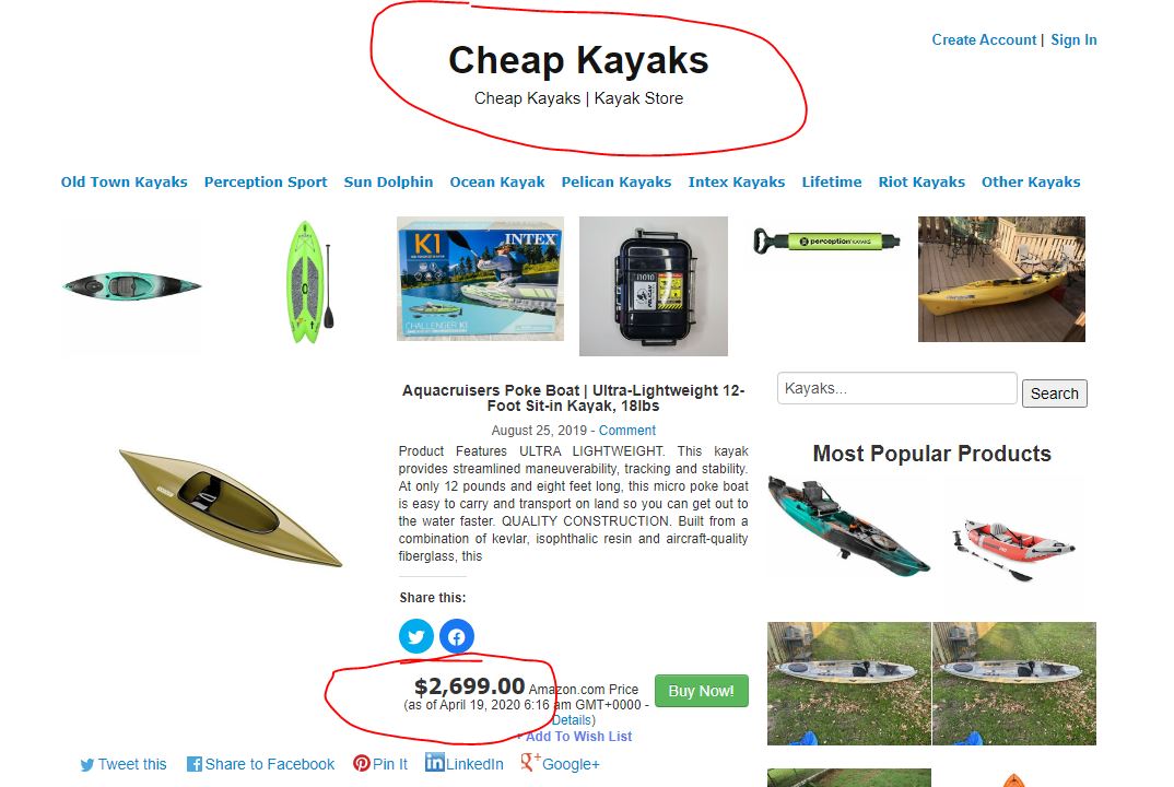

    One fairly comfortable solution to wet feet, is stocking foot featherweight breathable waders. Alternatively, wearing ventilated, quick drain and quick dry shoes like crocks produces dry feet in a few minutes each time they are placed atop an out of water crossbar or stirrups. Either might be more preferable to marinating feet in a puddle of muddy water or repeatedly sponging out, while sitting in a canoe shape. There is a a smaller version of the same 8' boat which is the 6' aircraft float tube and wt. around 3.5 pounds....
    Here's one of the lightest rigid boats I have seen, but they may have gone out of business in the last year or so?
    Aquacruisers Poke Boat | Ultra-Lightweight 12-Foot Sit-in Kayak, 18lbs | Cheap Kayaks https://cheapkayaks.net/aquacruisers-poke-boat-ultra-lightweight-12-foot-sit-in-kayak-18lbs/

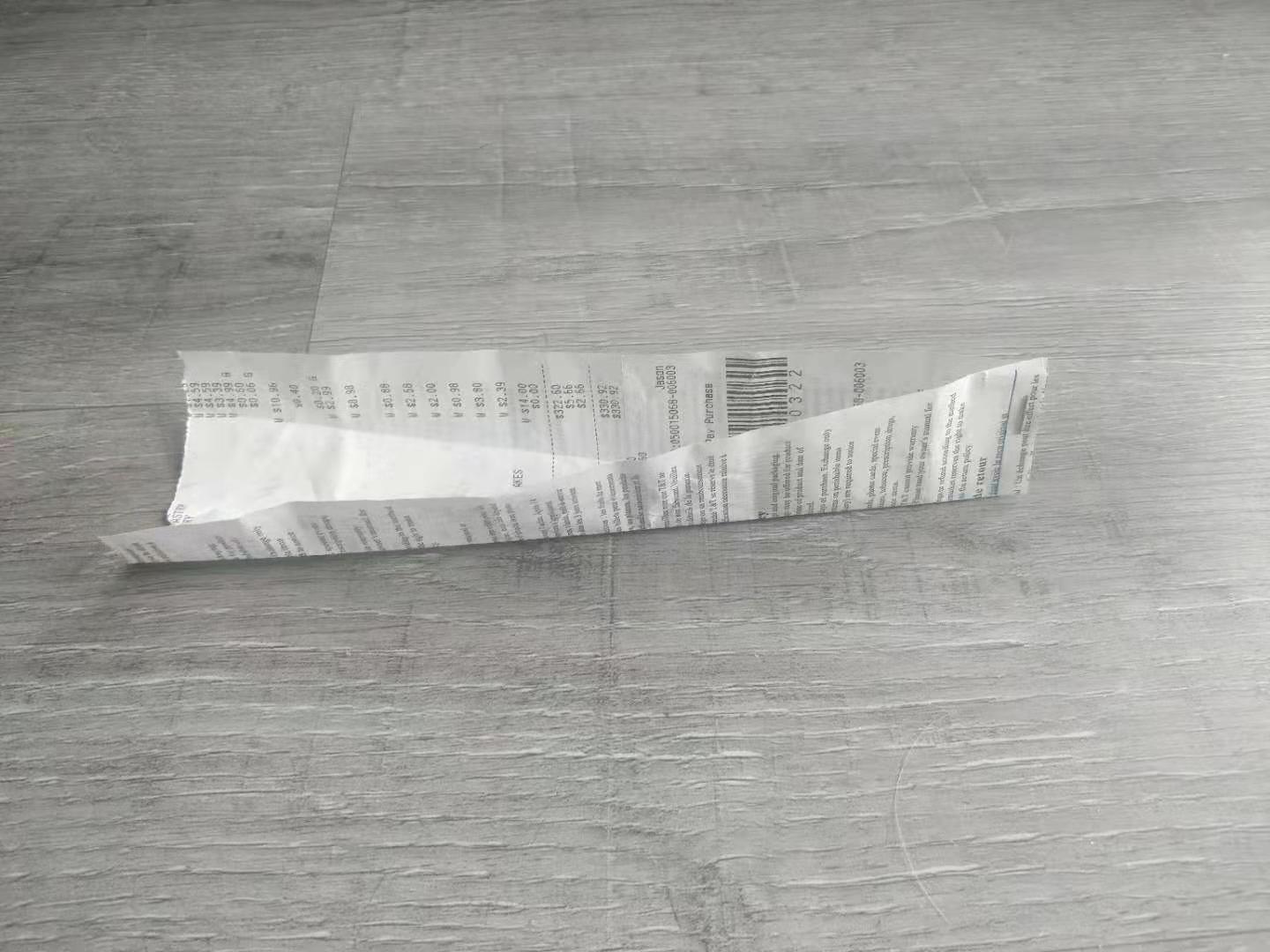

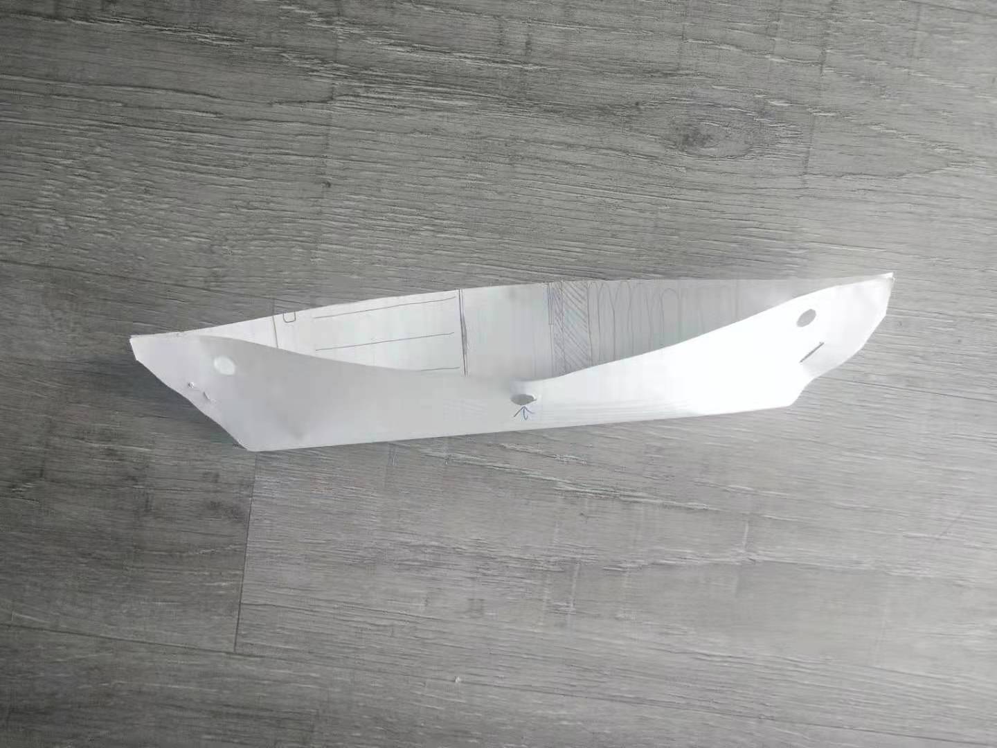

    Found the conditions it should meet: The skin can only curve in one direction at a time. It doesn't have to be chined, although it helps with my origami.
    Anyone can help put this into a canoe design? Thanks

    Paper is not like fabric or many other plastics.
    Fabric certainly can bend in two directions at once.
    Have you ever even seen a SOF in person?

    If you are now considering a folding boat, I suggest studying the oru kayak set up videos closely for inspiration. (the coroplast polypropylene is rated at 20,000 fold cycles, btw, and I'll guarantee you'll not be taking it out that many times ;) )
    https://www.youtube.com/results?search_query=oru kayak setup
    Making paper models is exactly the right way to explore the method.
