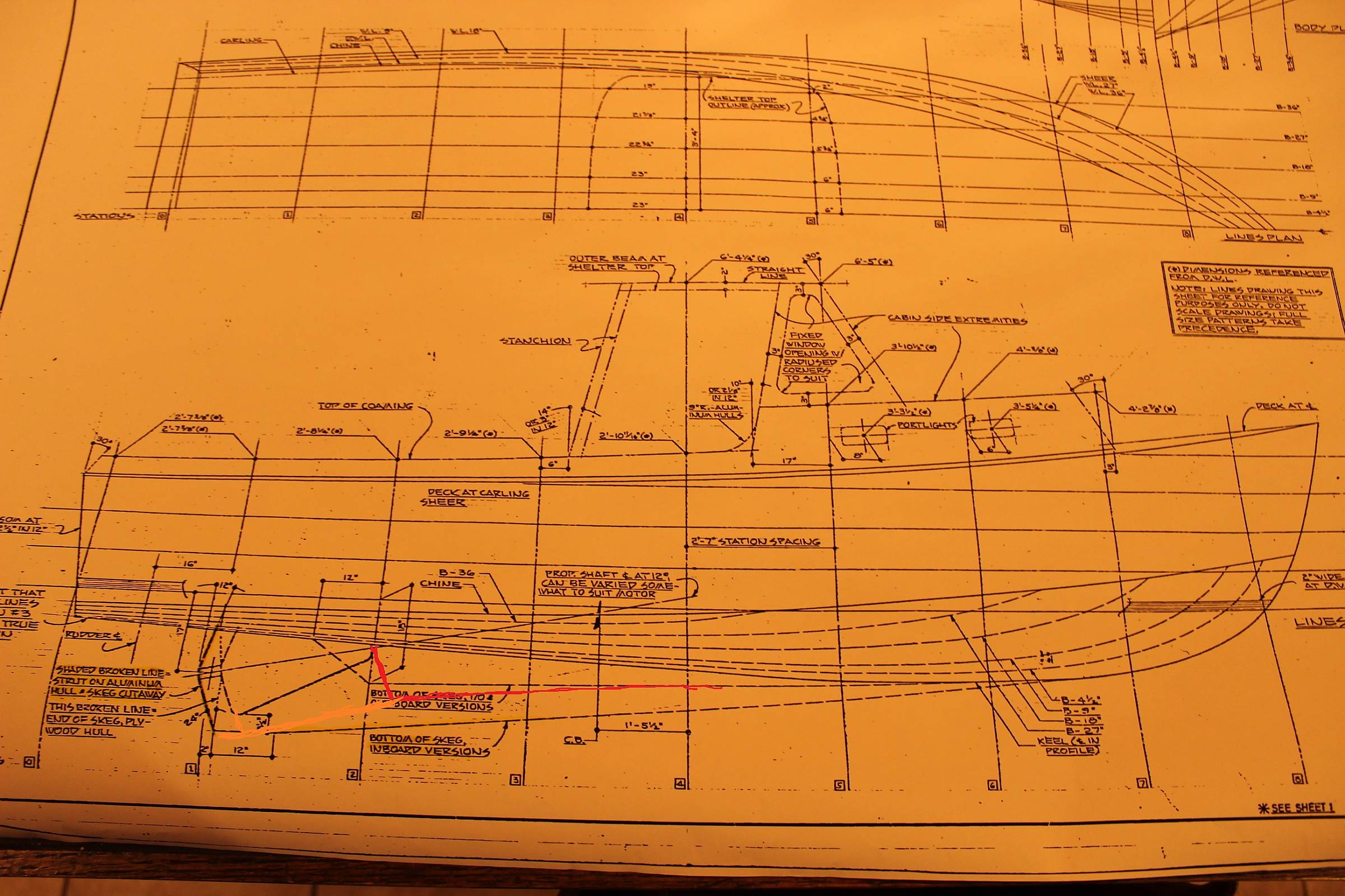

    Hi Adhoc,
    I have a few pics of my plans, but was unsure how much I could or should post without putting up more than the designer would want posted. Here are a couple of plan drawings, which I don't think would be too detailed to post.
    You will see different lines for full keel ( with cutaway per aluminum plans) as well as the smaller keel line for the outboard or I/O version. Finally a full pic shows the boat with no cutaway, as usually built in wood.
    Thanks for taking the time to look!

    The skeg performs several functions.
    1) Directional stability. With vessels that, in general, have a a shallow draft at the transom, and a deep forefoot far fwd, the directional stability can be suspect. The deep forefoot and acts "like" you have a rudder up fwd and therefore when you engage the main real rudder aft, it does not "bite" so much and you struggle to steer. Also in following seas the skeg helps to prevent broaching, same reason but in reverse.
    2) Structural. The skeg can add longitudinal strength to your hull
    3) Damage control. The skeg protects your prop and also the prop when grounding and also the hull when grounding. Also if the skeg is full, having extra stiffness at the prop boss rather than some distance from it, reduces any bending moment athwartships much easier, again reducing the loading on the structure from possible fatigue. An "open" or without as you call it, requires thicker plating/sections at the aft end to be as equivalent stiffness.
    Full skeg is easier to fabricate than having the cutout. Less labour.
    In either case, the most important aspect it to make sure that the training edge of the skeg is knife edge to promote good flow into the prop.
    Each method has its prop's and con's but, if done correctly should not influence the vessel too much other than your own build and maintenance. Since having a fully supported shaft and enclosed, can prevent issues that occur with a more exposed shaft.
    Finally, yes, add some additional long.ts iwo of the prop on the hull. You get a lot of pressure pulses from the prop so you need to limit vibration. Adding weight/mass to the structure locally increases the natural freq of the structure and thus helps to minimise any damage; prevention rather than cure. I would also increase the plate thickness iwo of the prop too, circa 1.5 times the surrounding shell plate thickness.
    Any of this help you to make up your mind?

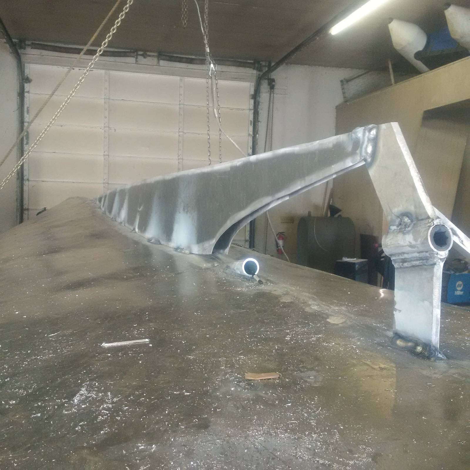

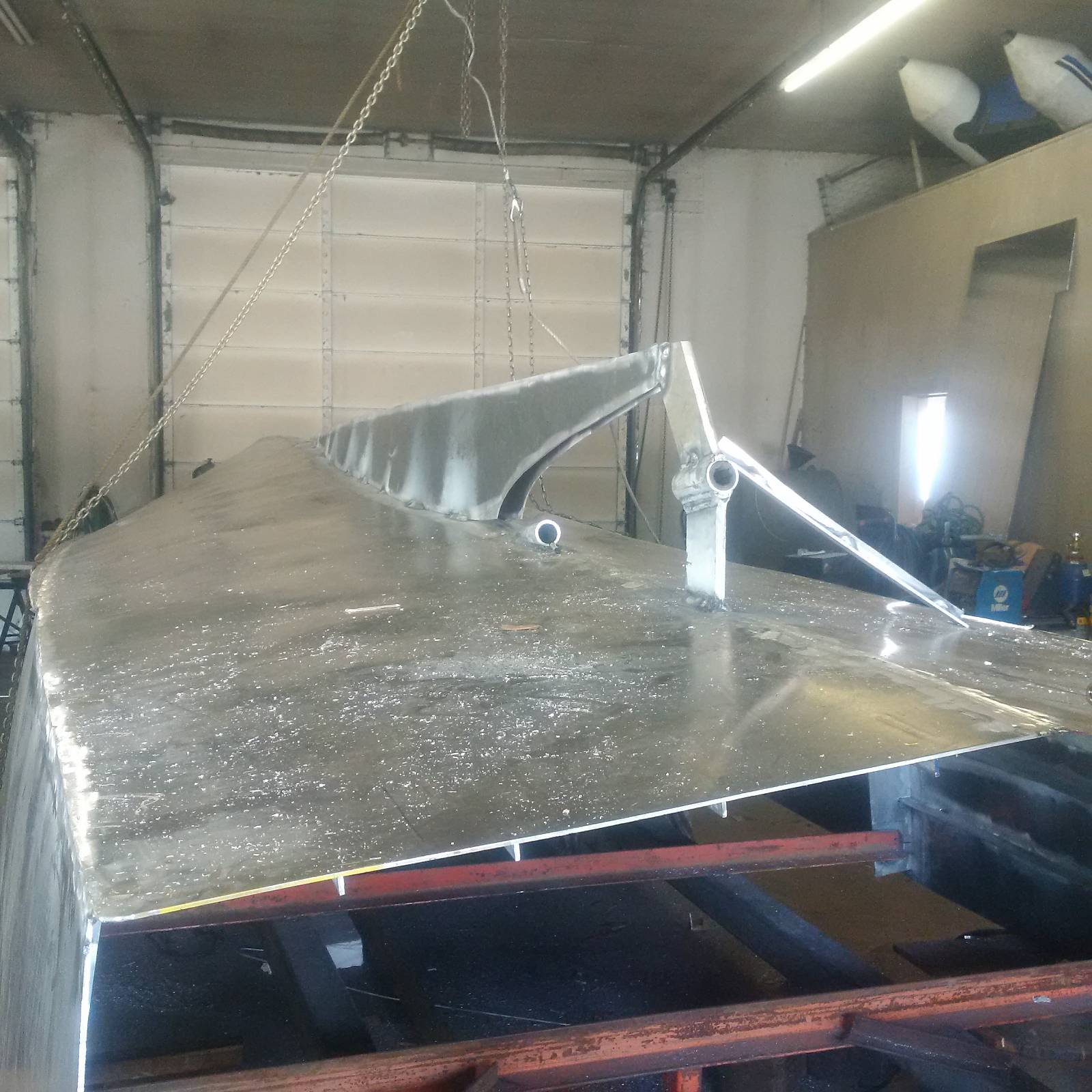

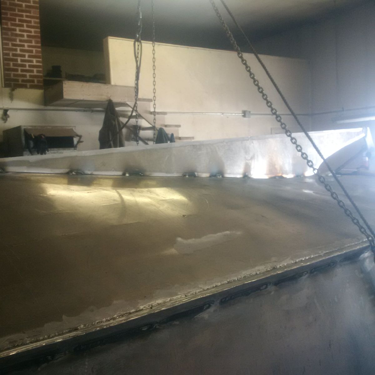

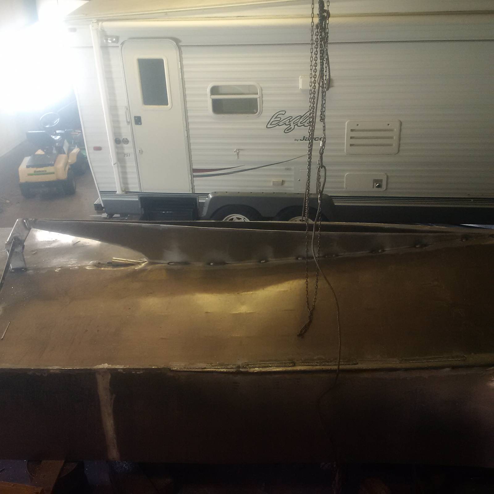

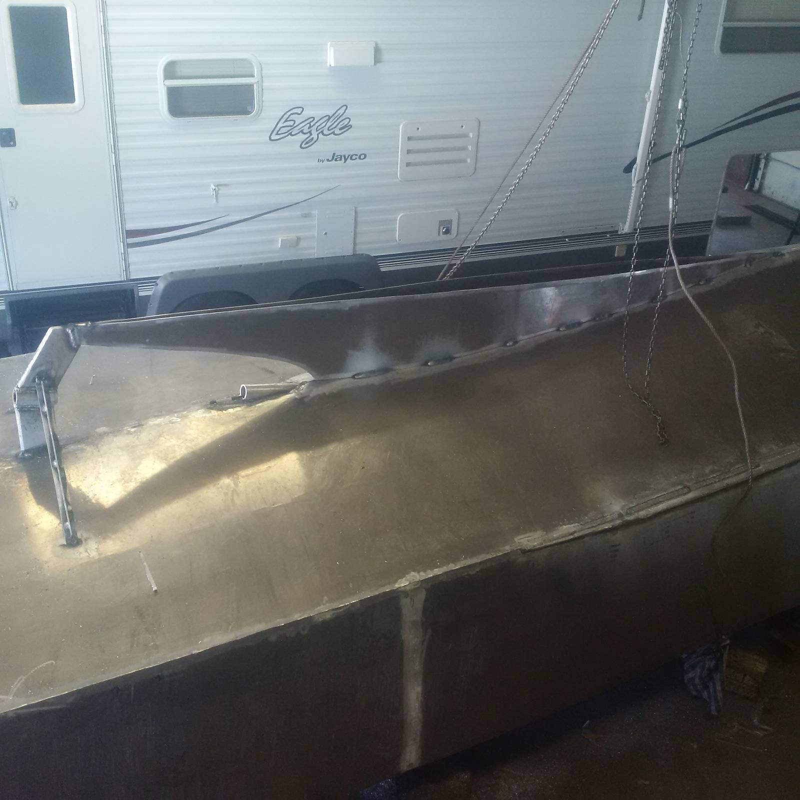

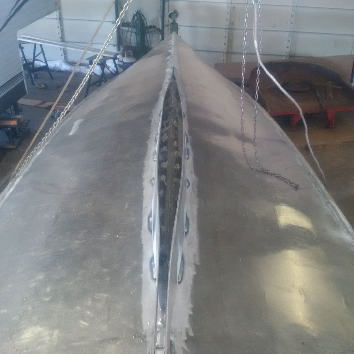

    hi Folks,
    Back at the (amateur) aluminum boatbuilding - likely should have asked for advice earlier, but here it is...
    I mocked up a full keel vs smaller skeg, both with a bar extending aft to lower strut leg, to protect prop and then extend further aft to become lower rudder support. I really did not like the look of the smaller skeg, with a then steeper extension to the lower strut leg.
    So, I decided on a full keel, and have "modelled" a cutout / cutaway in the keel, similar to what I have seen in images from the Shamrock keel drive boats.
    I plan on tapering the trailing edges of keel, strut, etc to as fine a point as practical. But, I wan't sure if that was required on the flat bottom of the keel.
    Right now, the keel is about 5" wide at the widest section, and I had planned on just cutting and welding in a piece of flat sheet.
    I did use a few clamps and easily pulled the open bottom keel sides in an inch or more, before the clamps started sliding off. To pull the sides closer, I could tack on a piece of angle, on each side near the edge, to prevent the clamps from slipping. But, I think that If I try to pull it much closer, the sides may start to bend/ buckle, as I would think they would be trying to move in two planes at once.
    Perhaps If I can get the opening to close to about 2 -3 " at the widest, without buckling the sides too bad, I could then weld it up and use either epoxy and filler to fair a knife's edge on top...or more likely weld a sharpened piece of heavy flatbar or a piece of angle on with the mid point making the "point" of the keel. Then fair where necessary.
    But, this would then add a couple of inches of depth to the keel, to go from what's there now to a knife's edge... So, what's worse, not having a knifes edge or adding a couple more square feet of wetted surface area to get to a knife's edge?????
    Looking for advice on best way to finish what I have started....relating to the keel bottom...i.e. flat, rounded, ground to a point....
