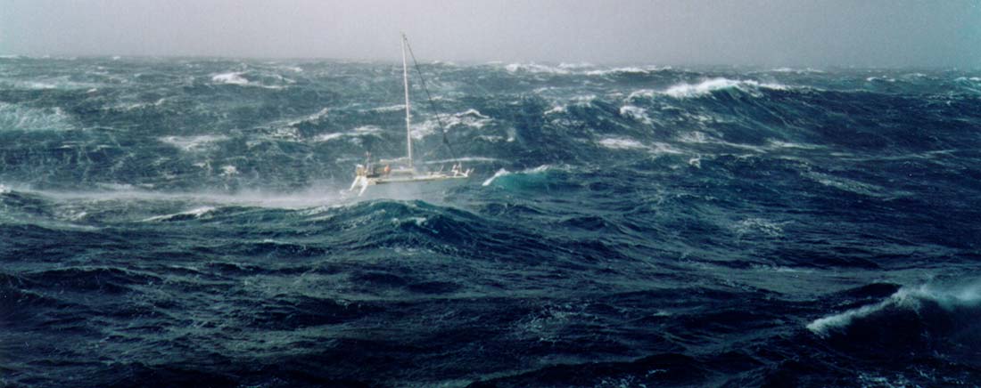

    Be careful of all advice about boats we haven't seen or sailed on - even from me. Although I did spend a bit of time wandering around a Slipstream at a boatyard. Balsa core can be well done, but check where fittings are attached. Bridgedeck clearance on Simpsons is usually moderate to fine - on the Slipstream is seemed fine. As for flat bridgedecks, that is what most cats (including mine) have and I can't see a problem with it. At least not in the first 20 years of me owning a flat bridgdeck bottom.

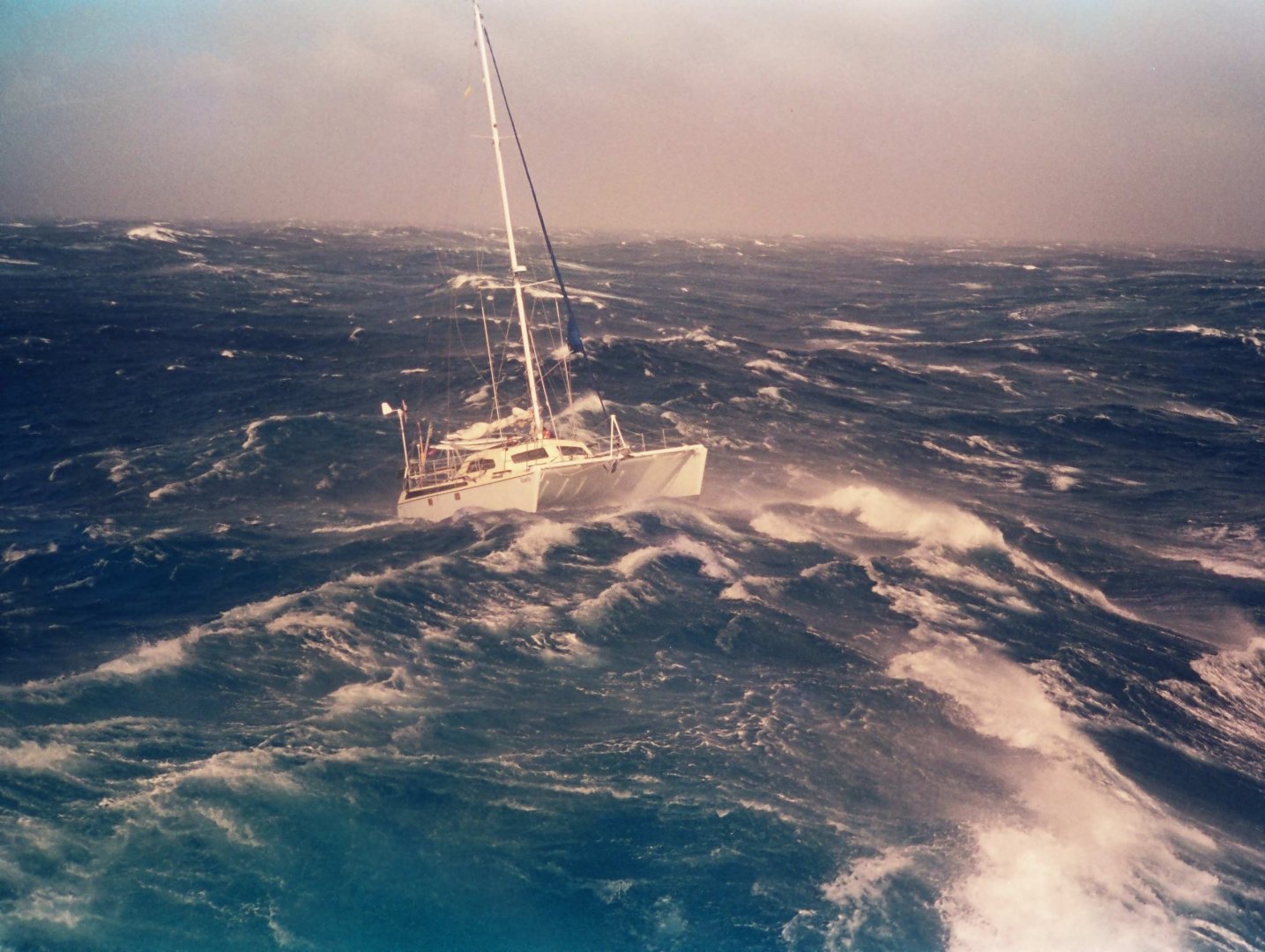

    Here is a shot of a Simpson Ramtha. She has far less clearance than a Slipstream. She was abandoned when the rudders bent and the parachute anchor was lost in the terrible Queens Birthday Storm. She was later found, all fine even though she had no one to help her through a terrific storm, she was towed to Tonga or Fiji and the owners went and got her and sailed and lived on her again. They were very impressed with their Simpson design and made a point of emphasizing its sturdy design.
    Simpson designs are usually reasonably wide, so the hulls will have a reasonable immersion rate - she is not going to go down quickly as you put the shopping in.

    Remembering that waves a wind always look way less threatening when photographed, I always quail a bit at this shot. There can't be many more intimidating cruising catamaran pictures. It looks incredibly terrifying and in real life it would have been many times worse. Great boat and great crew on the rescue ship the Monowai. Go to about 53 minutes in on this video to see the video - watch the whole thing if you feel the need to not go cruising to New Zealand.
