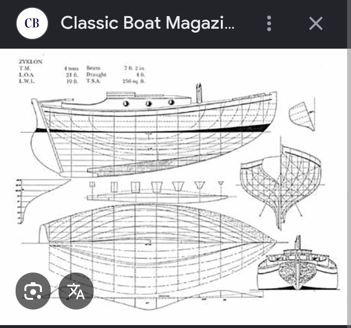

    What does the hull shape look like? To get the centre of buoyancy aft of the centre of floatation, the waterplane aft of the centre of floatation needs a higher water plane loading, or greater average draft, than the part of the waterplane forward of the centre of floatation. The ways I know to achieve that would be lots of rocker in the run, a bustle, or an immersed transom. What is your choice?

    Center of Flotation is the centroid of the waterplane area. CF could be ahead of or behind the CG at rest or in motion.
    If I'm correct, Carlos2K is using it as a factor in a boat's ability to surf or at least tend toward bow-up on a stern wave.
