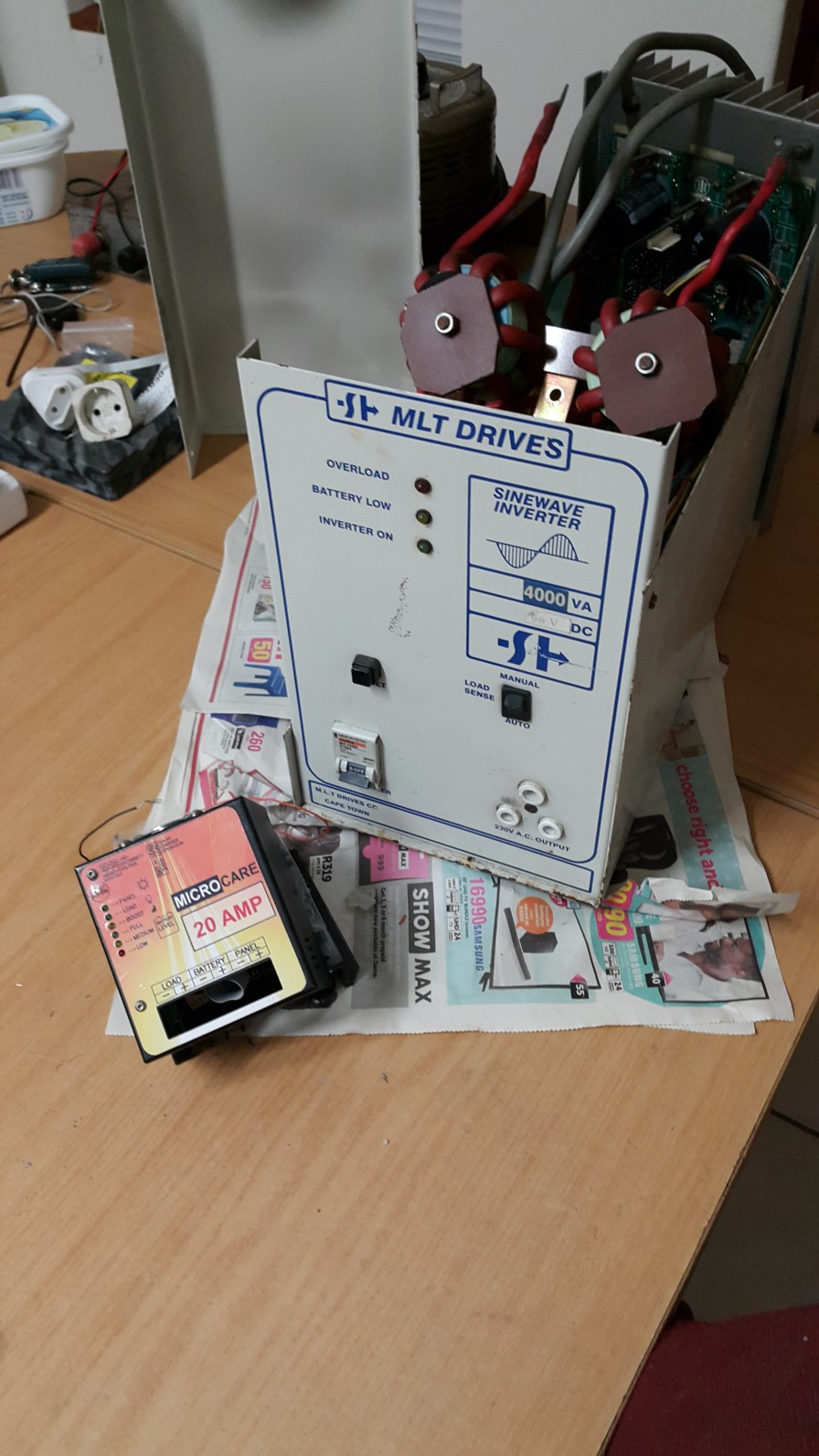

    Personally I like the MicroCare, you connect a load and do not short circuit the solar panel. Much more intelligent, it is a South African product from PE.

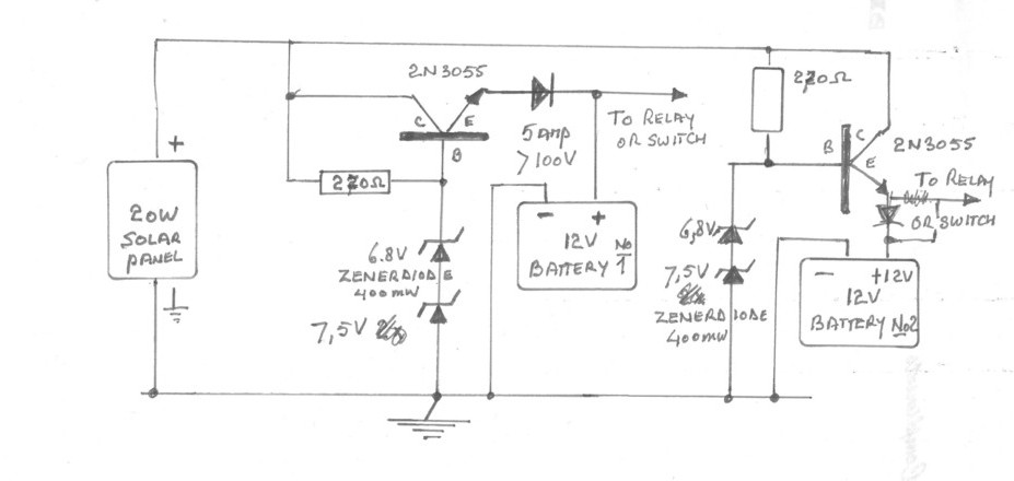

    hobbyist, who could make a voltage regulated unit with a 2N3055 for him. The cost is minute. for 2 batteries 2 x 2N3055 = 2,5 dollar. 4x zener diodes 15 dollar cents each, 2 resistors at 0.01 cents each. A piece of aluminum as heatsink. A piece of printed circuit board from off cuts and a box to put it in. The working is simple. As soon de sun comes up, the voltage increases. The 2N3055 start opening up via the base resistor. As soon the batteries reaches the 13.0 - 13.1 Volt the 2 zener diodes of 2 x 6.8 Volt/400 mw limits the voltage of the transistor to 13.6 Volt. The loss of the base to emitter is approx. 0.5 Volt. which leaves you approx. 13.6 - 0.5 = approx. 13 volt to keep the battery topped up. If the battery is full, the emitter voltage goes up and the zener diodes + base blocks the voltages to rise higher that the 13.0 Volt. As soon the sun goes down, the transistor blocks the battery from discharging over the solar panel The Forward voltage is 60 Volt VCE and if he is concerned, he can place a 5 ampere diode of a few hundred volts to make sure nothing will happen. He must just lift the 2 zener diodes by 0,5 Volt. i.e. 3 zener diodes totaling 14.1 volt. i.e. 2 x 5.1Volt + 3.6 Volt or 3 x 4.7 Volt.
    0.1 volt - 0.3 Volt is not a problem as the overall voltage stays below the 13.8 Volt gassing voltage. Bert

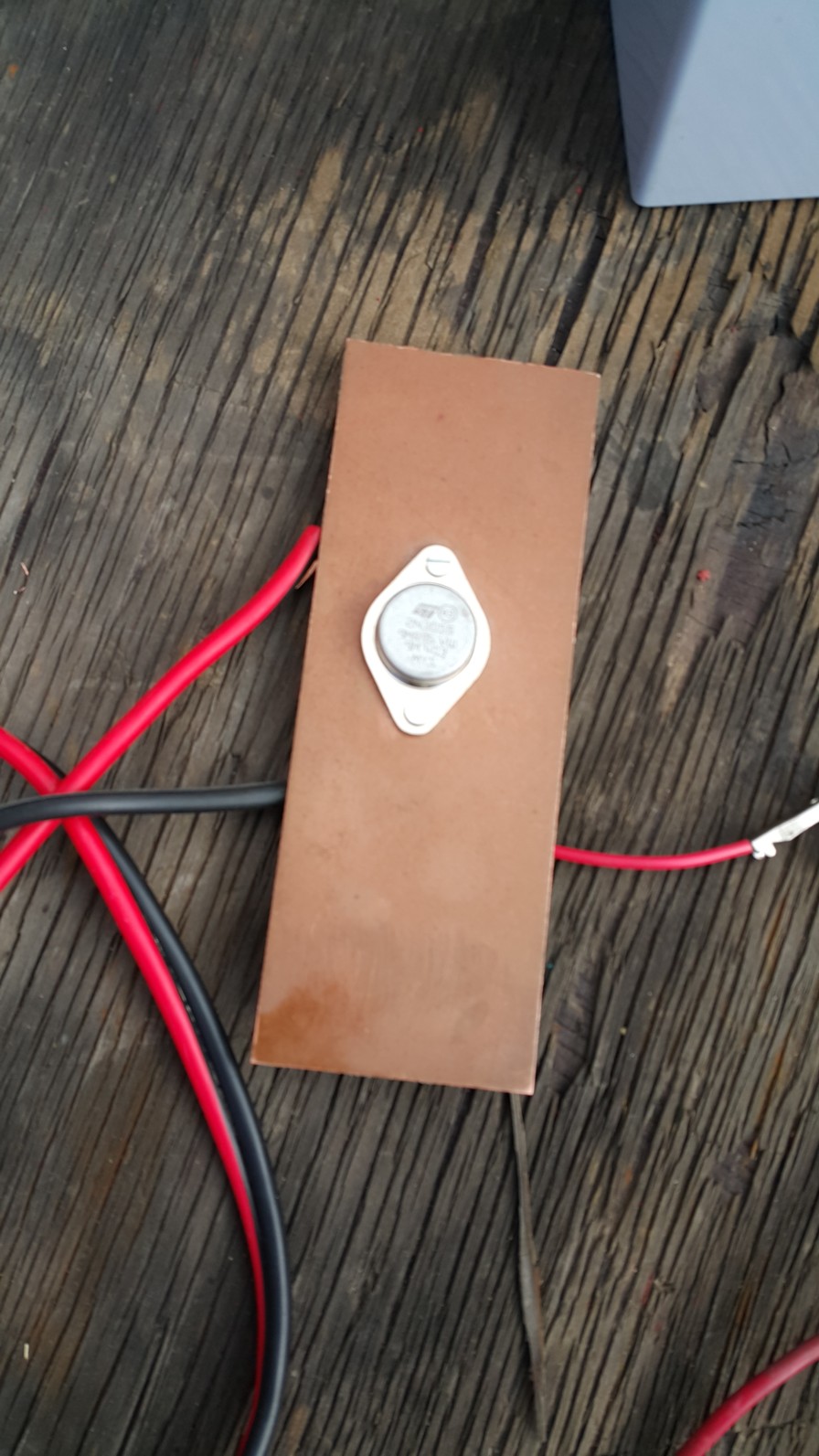

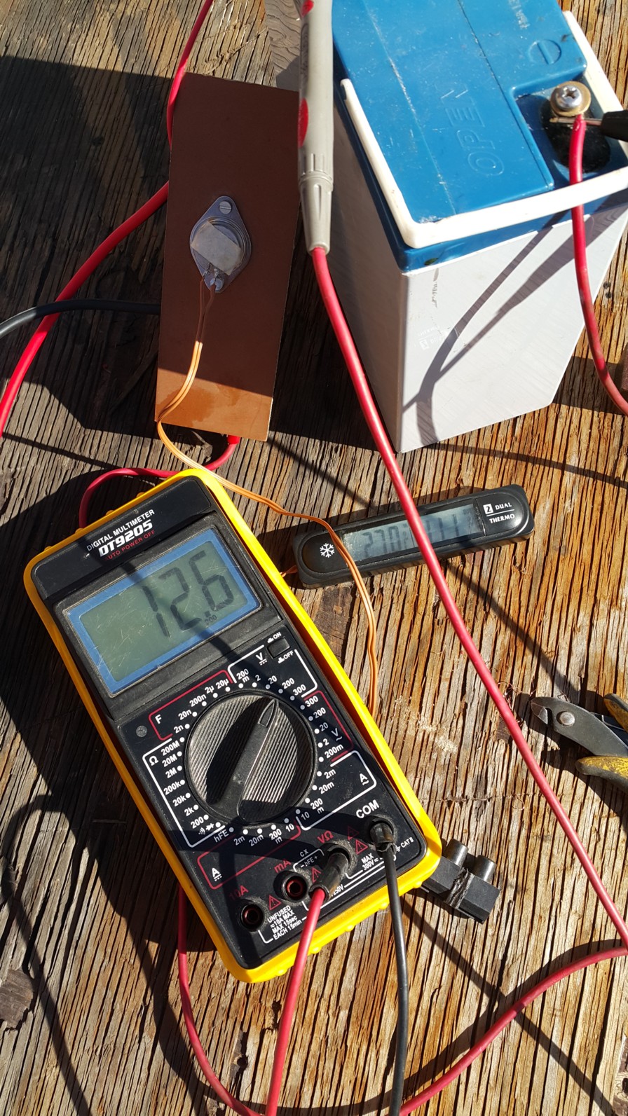

    I had an hour’s time and the sun was nicely shining on this winter’s day. I quickly cut a double sided printed circuit board and cut some groves to separate the various components from short circuiting.
    Please note: One must not short circuit the 2 layers as the one side is the plus of the solar panel and the other side is the minus of the battery.
    I made one change. I decided to place a diode between the battery and the Voltage regulator system. The reason is to avoid unnecessary high leakage current when the transistor is blocking the battery from discharging over the dark solar panel. In the above case, I could have used a 1 Amp diode as my panel has only a 0.73 Ampere short circuit current. If a 20 watt panel is used, it is better to have a 5 Ampere diode. The reason is, if the battery was forgotten to be charged, before going on holiday. The solar panel will charge the battery by up to 1 Ampere shared if only 1 battery is charged instead of 2, or if the second battery was full and the other one get charged with 2 Ampere.

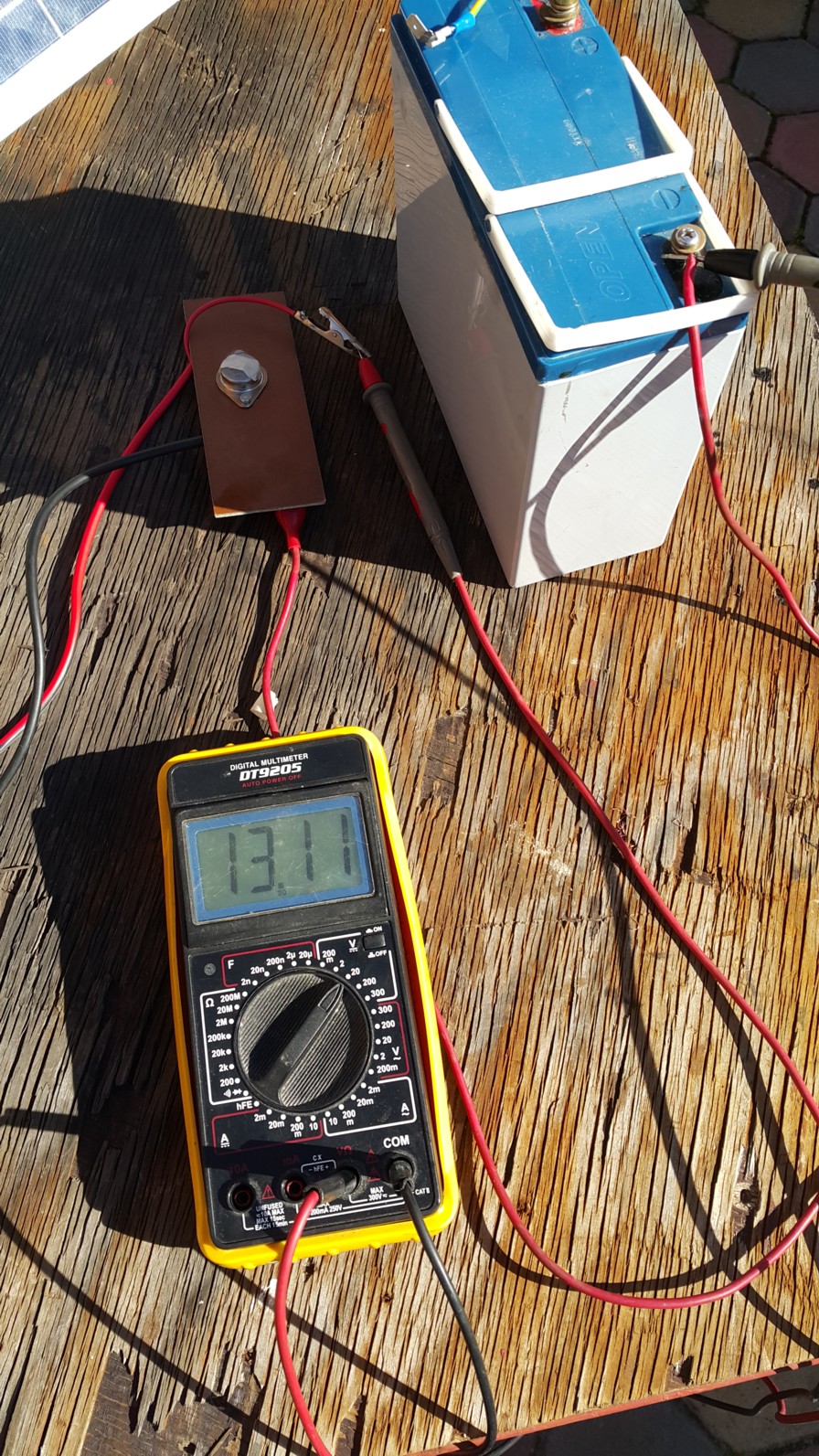

    I did not have the correct zener diodes as per diagram and used a combination to get the end result of 13.11Volt
    The standard range is 4,7V - 5,1V – 5,6V – 6,2V¬ - 6,8V – 8,2V – 9,1 V – 10V - 11V – 12V - 13V – 15 Volt

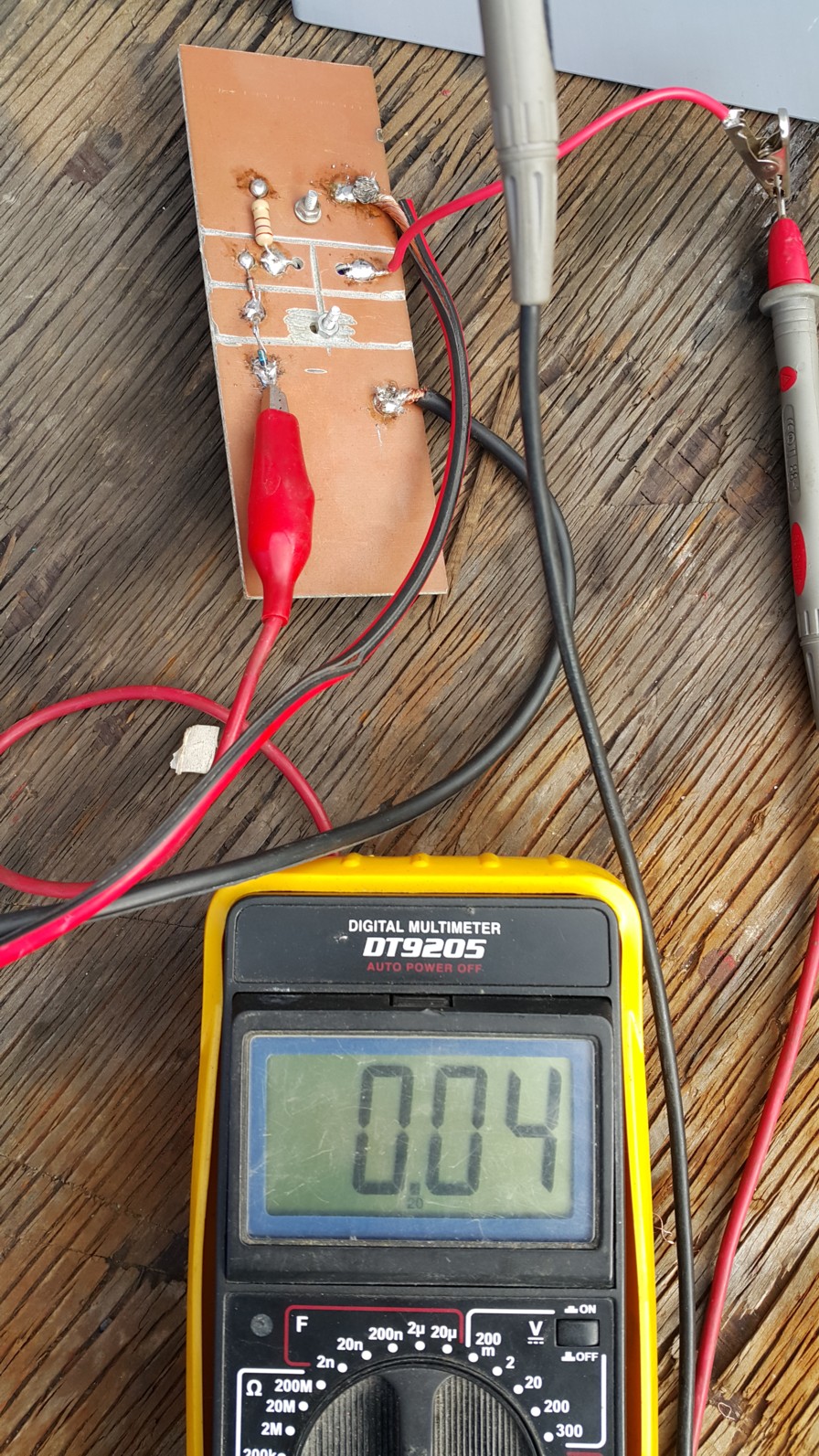

    I used more than 2 zener diodes to spread the power dissipation over 3 devices, but 2 devices will do the job. 270 Ohm and bright sunlight has a current flow of 40 mA through the resistor and the minimum power required at the 14.3 Volt result in a total power used of 560 mW i.e 2 x 400 mW gives enough safety factor. One could use a 1 watt zener diode, but the range does not have a 14,3 Volt type.

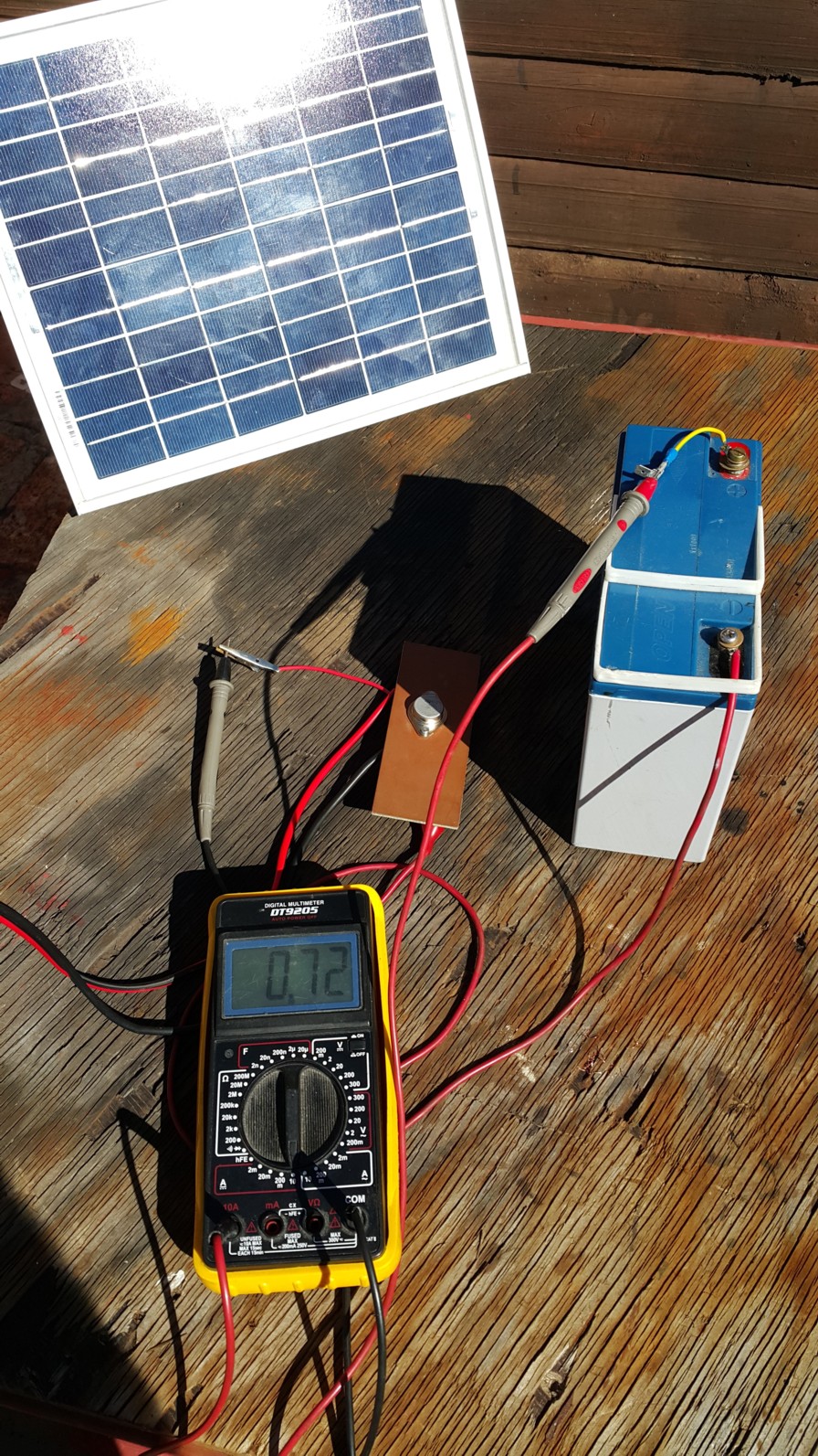

    Photo1 Shows the 10 watt panel and the 12 Volt Lead acid battery setup with the voltage regulator.
    Photo2 Shows the open charging voltage of 13.11 Volt. (do not make it more than 13.6 Volt)

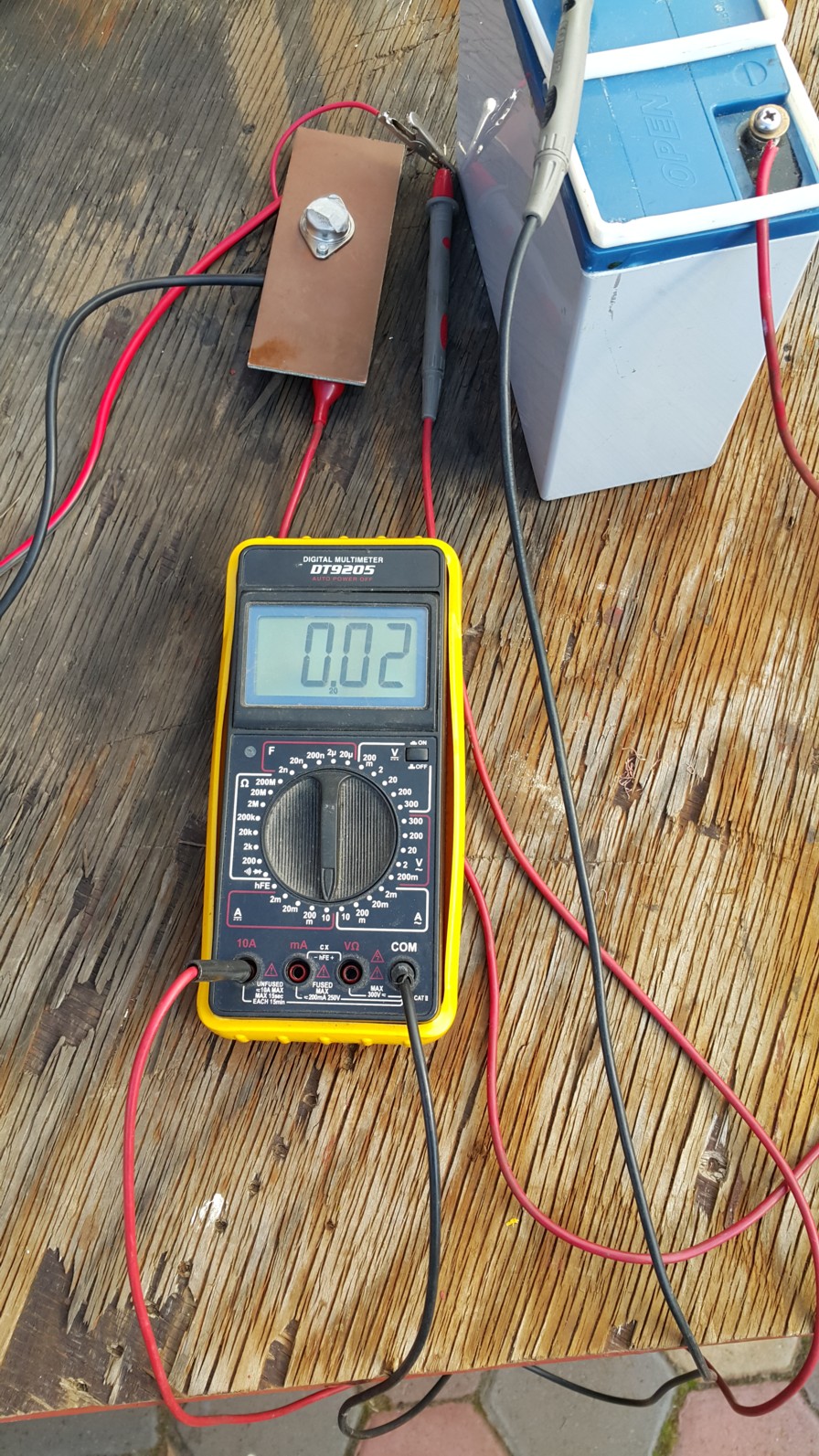

    Photo3 Shows the 2N3055 mounted on a double side pc board.
    Photo4 Shows the zener diode current of 40 Milli Ampere with the pcb and the few components. (without the 5Ampere diode)

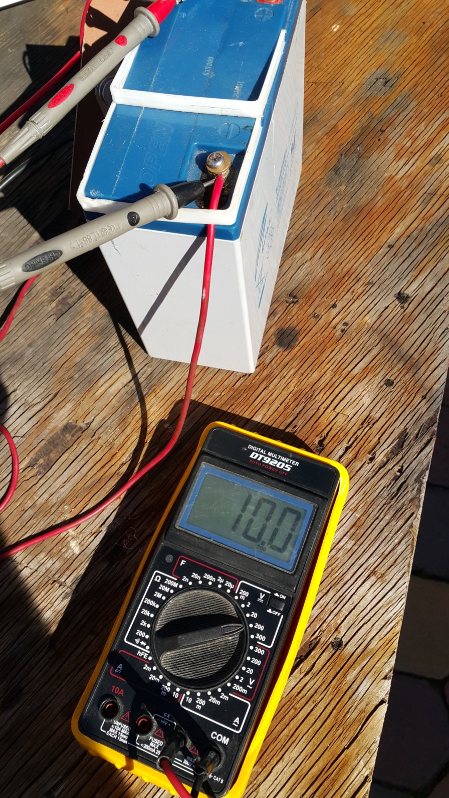

    Photo5 Shows the 10 Volt of the one cell faulty 12 Volt battery. But it even demonstrate the exercise even better.
    Photo6 Shows after charging of 1 hour. During the 1hour the full 0.72 Ampere was pumped into the battery
    Photo7 The leakage current at 12,6 Volt voltage regulation, being 20 mA
    Photo7 Also shows you the battery voltage after charging. Shows you the transistor temperature during charging/leakage current compensation. Way below the maximum temperature of 85degrees Celcius. Ambient temperature during test was 25 degrees
    Solar panel 20.6 Volt open Voltage , 0.73 short circuit current.
    2N3055 maximum 15Ampere and 115 watt power dissipation. At a 10 Watt panel it will only be absolute maximum of 7,5 watt and also if 2 batteries are charged from a 20 watt panel.
    270 Ohm should be a minimum of 1 watt, but preferable 2 watt.
    Good performance during very hot summer (up to 40 degrees Celsius Ambient) and cold winter weather (up to minus 10 degrees Celsius) can be expected.
    Components required
    1 x transistor 2N3055
    1 x 5 Ampere diode
    2 x 6.8 Volt 400 mW zener diode
    2 x 7,5 Volt 400 mW zener diode
    1 x 2 or 1 watt resistor 5% 270 Ohm
    single side pc board with an aluminum heat sink or
    Hope I do somebody a favor with the above circuit and demo.
