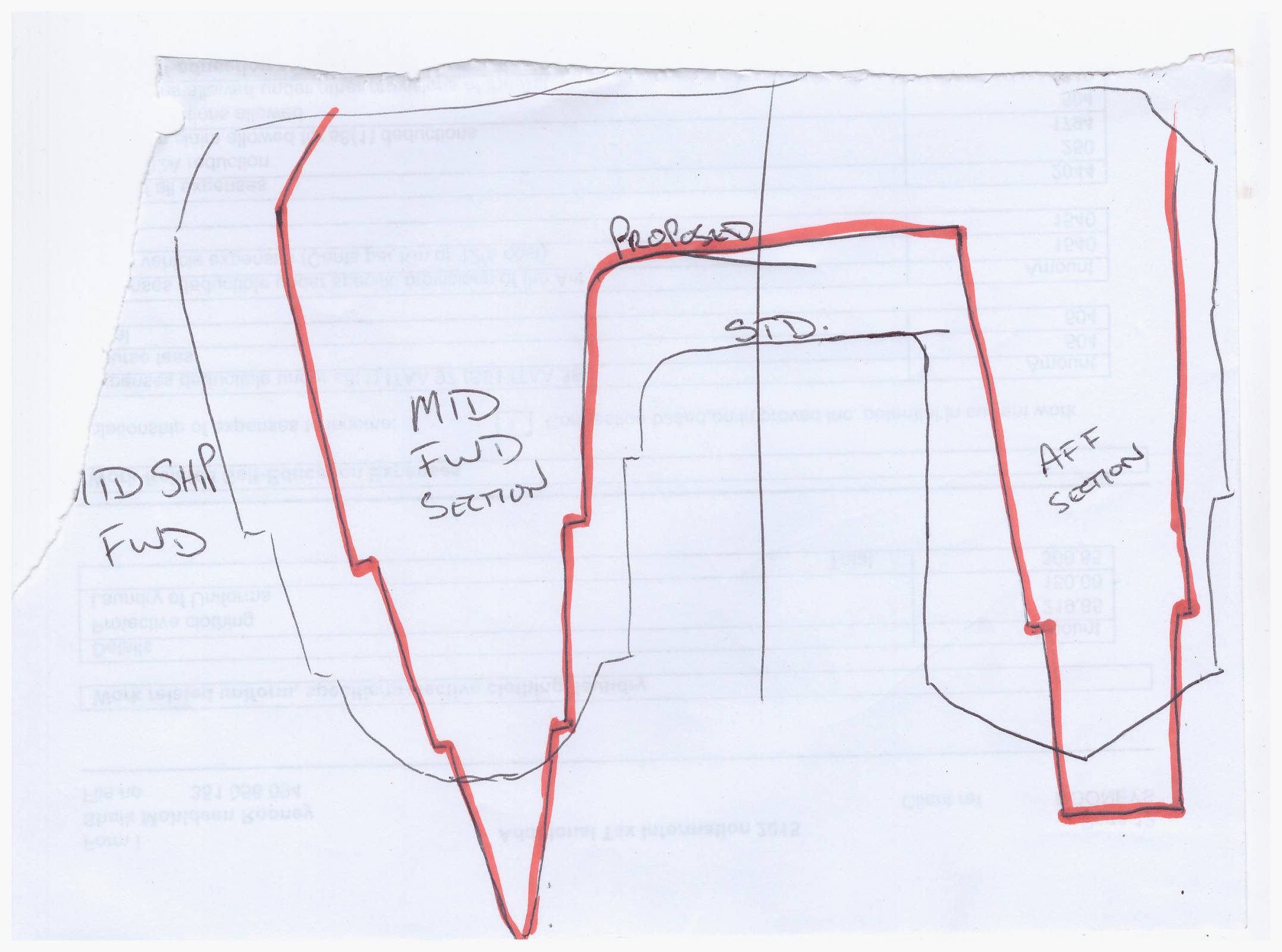

    if i can revive this thread for a question rather than start another thread

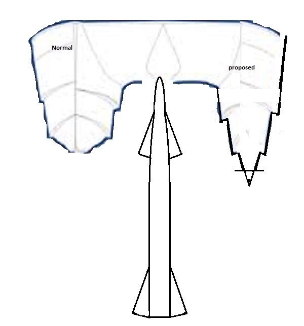

    The hull shape attached the proposed shape and its effects, sorry no 3D modeling here.
    I have tried to show the removal of width and replace with depth as mentioned above as slenderness very slender. so replacing displacement from width to depth
    Proposed say a small boat of 6-7 meters aluminum lightship 1500kg with 200hp
    would this hull have a much higher drag due to the surface area below waterline.
    The aim would be to achieve smooth ride in very choppy conditions at speed
    or is there a limit to this effect with handling please explain pro's and con's

    Yes. Without doubt. The drag would be significant. 200hp on 6-7 metres is not a sound idea. The weight on a 7 meter narrow hull like this would be crazy. I had a 6hp on my 18ft tri, and that was as much as it could carry in some conditions.
    The centre hull was so narrow I had to put "pods" extending to fit myself in it.
    The ride through choppy water was very smooth. I had then to build up the foredeck to prevent taking water on board.
    On the whole, quite successful.
    But, this is all old hat. Every style of catamaran you could ever think of has been tried, and its really down to picking an existing design that fits your "needs".
    Cat/Trimarans have a lot of benefits, but they don't carry big loads, especially heavy motors.

    I'd suggest that you don't slim the hulls high up, slim them in 3 stages so the top third is the same as the normal hull, assuming you are intending to employ hydrofoils to make up the difference in lift.

    The sea conditions proposed would be flat to 1-1.5m seas and or 1-2m swell and try to average 20+knts. yer probably over estimated Power but would see 70 to 90hp a side.
    I want to peirce waves then lift (equalize momentum) thru the middle giving a good AOA to next wave. the foils are mainly for lift and as suspension into the face of a wave, cavitation around the foil is not critical as i dont want hard landings. Foils are set 1-2vdegree deflection and retractable for less effect. 20 foot long and the rear shape much like a standard power cat not too thin.
    As mentioned MrE step/planning/ deflecting stages i agree to be necessary this also adds strength by form.

    You can work out the hydrostatics with something like Freeship, if you have a couple of months "play time".
    Usually also a waste of time. I would go up to 1/3 scale for any kind of testing not in a proper tank, just so you can easily get at least get engine performance characteristics easily. Tank testing is thousands of dollars a day, so that probably isn't going to happen.
    If you are serious, you really need to bite the bullet and get a qualified NA onto the job, or find an existing design to suit.

    Way too experimental to be making a boat like givitago envisages, the odds of it working well without a vast amount of trial and error is not good. You are stepping into unknown territory in too bold a way, I think. And scaling is very tricky, dynamic effects are out of whack with bouyant lift as you scale down
