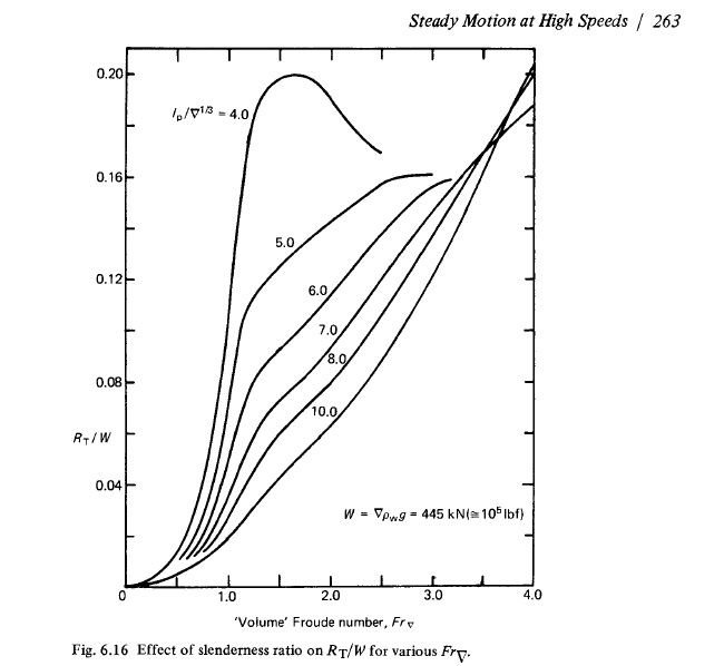

    For an efficient hull, you need a length-displacement ratio (LD) of at least 8.0. Any higher is much better. But, for starters let us assume a value of 8.0.
    Thus L/(D)^3 = 8.0, this gives a displacement of 443kg or 977lbs. That is total displacement.
    Now, looking at typical graphs of resistance and how the resistance changes with increasing or decreasing LD ratio, see below:
    So as you can see an LD ratio of 8.0 is very favourable in terms of resistance. But can you build a catamaran it engines outfitting and you and fuel etc etc..for a total of 977lbs?...well from your responses above...seems not as you are looking at 2500lbs or 1130kg.
    So what does 1130kg mean in LD terms? = 4.2.
    So looking at the graph above where does a value of 4.2 sit....OOOPPSS...not very favourable. In other words VERY inefficient.
    So what are your choices....build the boat with whatever you want how ever you want..and put the smallest least fuel consumption engine in it you can find the speed will be what it is and be happy with it. Since running at slow speed will be your most efficient means too as it shall be just skin friction that dominates, not wave making. But if you want to gain those 5knots....you'll be going into the big hump part of the curve above, not good!
    Otherwise, as noted earlier...you'll be chasing rainbows.
