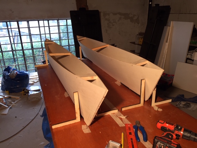

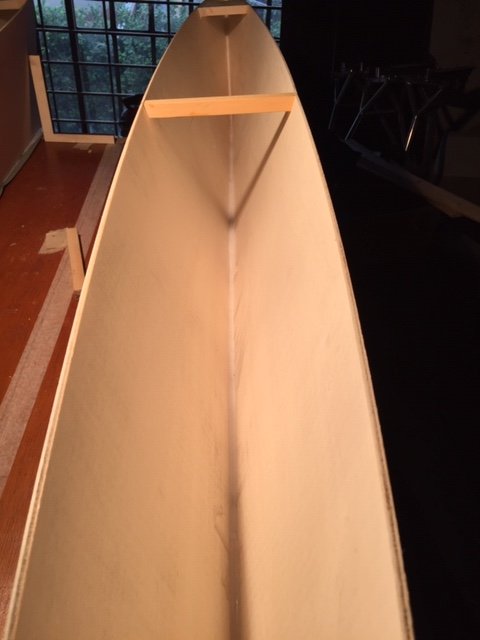

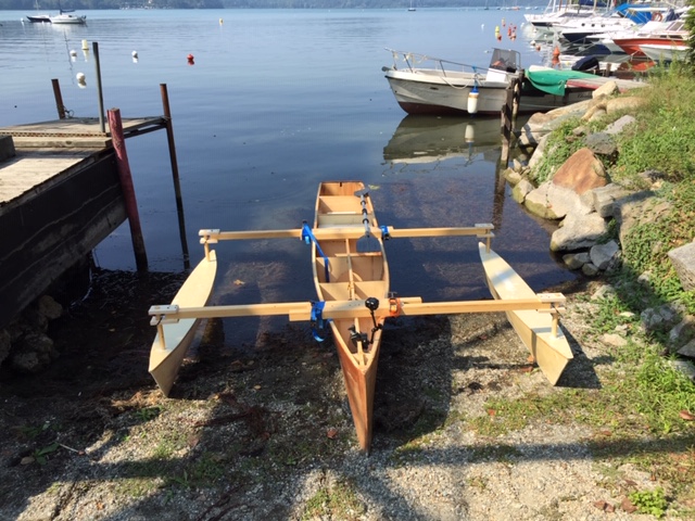

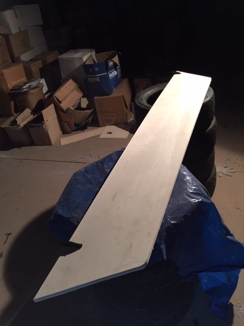

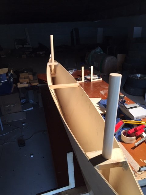

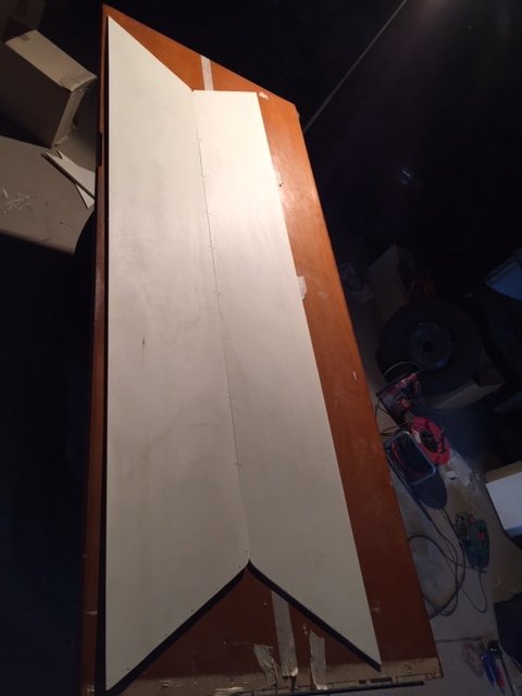

    Your idea is basically what I did a couple of months ago to create an outrigged canoe for double paddling on my local lake ( a 3km diameter almost circular lake). My main hull is made out of 4mm okoume , but for the amas I used 4mm poplar that is the only locally available plywood. Total length of each ama is 2m, width at deck is 25cm if I remember correctly. I made them short because I didn't want them to interfere with my paddling. I think you cannot get simpler than this as a construction method. Here are some pics..

    Owly, BlueBell and Doug Halsey like this.
