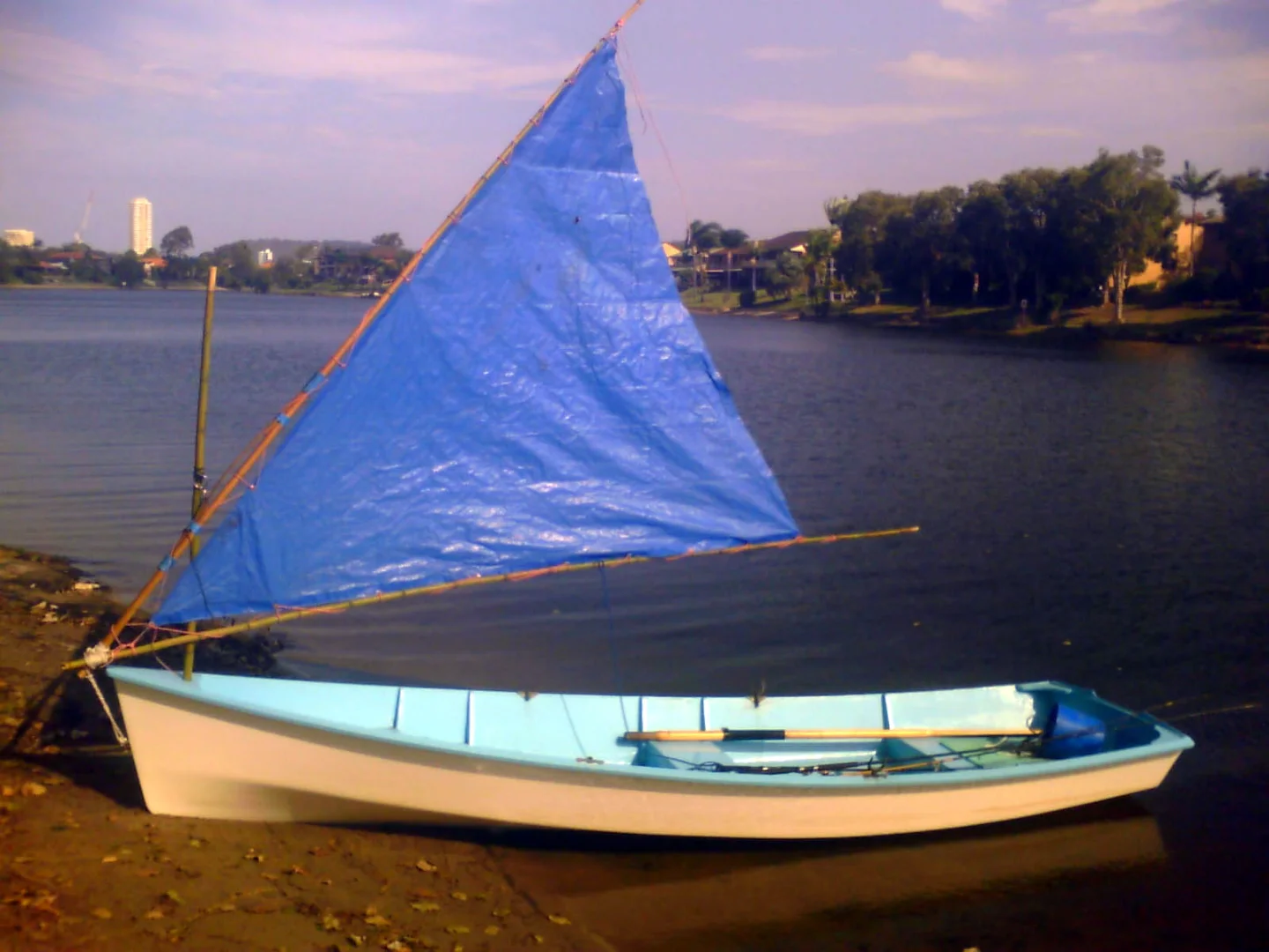

Here is a simple crab claw rig on a Lillistone "Flint" row boat with bamboo spars and a short bamboo mast. This person used an oar for steering and leeway modification, but it would be a better sailing boat with a proper foil board and rudder.
Regarding balance, this little article will give the idea.

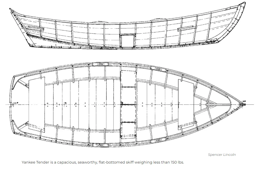

Image and details from Small Boat Monthly:
Yankee Tender Design Plan Details​
DESCRIPTION
Hull type: Flat-bottomed, straight flaring sides
Rig: None
Construction: Cross-planked bottom, lapstrake sides
PERFORMANCE
*Suitable for: Protected waters
*Intended capacity: 3
Trailerable: Yes
Propulsion: Oars
Speed (knots): 1-3
Particulars
LOA: 12′ 4″
Beam: 4′ 4″
Weight: 125-150 lbs
I would start with finding something similar length/beam/shape that has a defined sail plan and go from there. I don't think I'd bother with a headsail. The little boat I am currently working on has a standing lug rig and sail from a boat about 18 inches longer. I built the rig with a non pivoting rudder and clip-on leeboard, in retrospect I should have made them both pivot, or at least the rudder, to facilitate launching and landing on a ramp or beach.
I'd be tempted to use the forward thwart/seat as the mast partner (drill a hole for the mast) and add a mast step step below.
