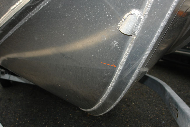

    Like this one we did on lifting the whole vessel:
    You can see the ever decreasing thickness away from the lifting eye. So transferring the applied load to surrounding structure and at each junction you calculate the shear area required. And then internal structure as well, doing the same.
    The other part is selecting the shackle that is required.
    Since you have identified the amount of load required, you select a shackle that is rated to this load, like so:
    Very simply, that's it. No magic..
    It is all about understand how to calculate the loads and how to distribute them safely.

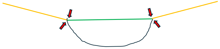

    Some times you are not in a position to add lifting pads to the unit to lift - for whatever reason, so you make a beam that can do it. yet the lifting pad calculation is exactly the same, and then each pad looks the same.
    This is another one I did, as noted here:
    So you can lift the whole boat:
    That's it... simple.
