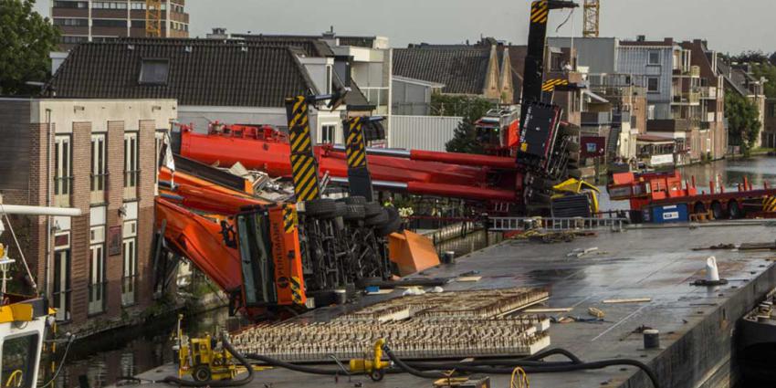

    It looks like the plan was to have the little far-side crane lead the pivot in order to have the load clear under its boom and over its riggers and keep the falls up-and-down. As soon and the pivot begins, the rear barge begins to heel substantially and pitch down. I think it was the pitch that did it in. The lift was clearly not fully counterbalanced - not even close. So when the little crane rotated forwards the whole barge pitched down and the lift height decreased. You can clearly see the lift starts level, but is low on the small far-side crane after the pivot. With the lift being made mostly from the bottom, (the effective lift point appears to be way below the cg of the load) that rolled a lot more load onto the little crane, which sank further and continued the process. If more lift had been on the upper purchase, the load would not have transferred during a rotation. Who lifts a tall skinny object from the bottom using two cranes?

    Got this from the Peinemann website where they also work with mobile land and road cranes stationed on pontoons, but this setup seems to be less sensitive to sideways incline of the cranes making the pontoons list and so causing a self-reinforcing effect leading to the capsize of the cranes.

    I've worked on a couple of jobs where land cranes were used on pontoons and barges. Land cranes are designed to work on a level surface. Any sort of slope, like from a barge listing to one side, introduces side loads on the boom for which it is not designed.
    Same with swinging loads. There should be tag lines with winch tuggers attached to the free end of the load to keep it from swinging.
    Barges with cranes are going to list. What you want to do is position the crane on deck so that the list occurs at the boom end and not to the side of the boom. For a barge of normal proportions, GML > GMT.

    The accident happened barely a month ago. I suspect the investigators are still collecting evidence and testimony about the sequence of events. It usually takes several months to a year to analyze the facts, make tests, determine a cause or causes, and issue a report.

    He tells that the pontoons in the accident were ballasted with free floating water and about the bad consequences of this in combination with list.
    And also about the total unsuitability of road cranes on pontoons.​

    I'm guessing free floating water means no compartment baffles.
    It looked like the far crane operator was going too fast to begin with, and whatever happened to his crane, which started the whole event, happened suddenly with a jerky motion. That could be to do with being land cranes...maybe his outrigger extended support arms slipped, not being fastened to the barge like a dedicated crane would be, and once a large, heavy weight gets out of control, it dictates what happens. An object in motion tends to stay in motion, etc.
