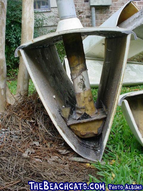

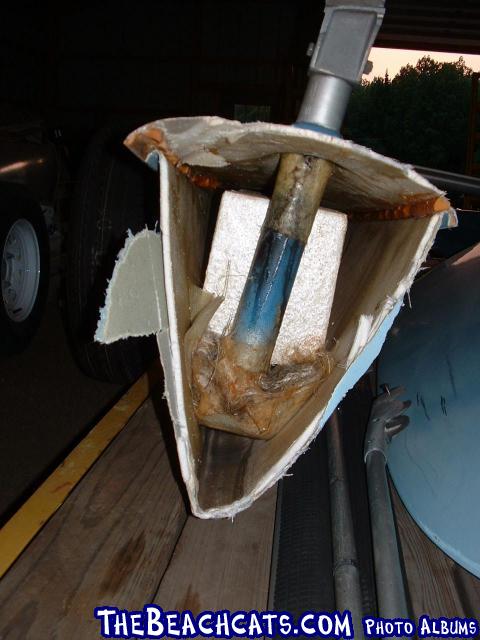

  14. BobBill
    Joined: Oct 2009
    Posts: 823
    Likes: 19, Points: 18, Legacy Rep: 157
    BobBill Senior Member
    To me, composite is soft, unless, a matrix like glass in resin...cured. The hobie hull is thick and will hold bolts...that is solid.
    Will try to post pic of H-16 hull cross section I have. Plan to use the flatter side, post cut.
    I might add the pylons in the pics weigh and replacements are much much lighter.
    Consider weight reduction at 16' will be near 75 lbs with no concerns re moisture, draining, etc.
