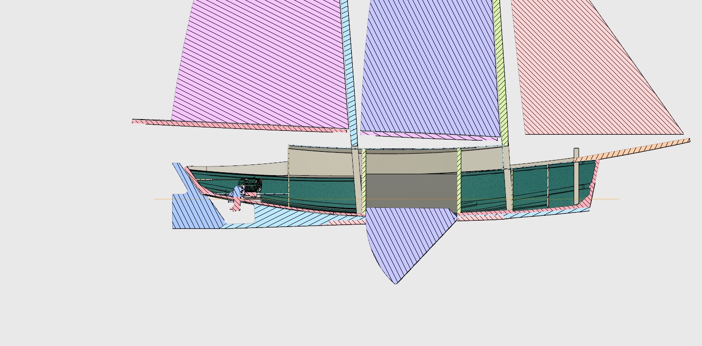

    Hi Valery,
    What's the displacement ? Our last boat was 36' on deck, ~20,000 lbs and it was fine for 2 adults, 1 dog, 1 cat (the captain). We decided to build bigger so we could have more room (storage). We might have gone a bit too big.... :)
    Put those masts on a tabernacle that you can raise and lower easily, and you have a super interesting boat for the first part of your plans ( Cruising and sailing from Montreal, Canada, St-Laurence River, the canals, Lake Champlain, The great Lake area, maybe eventually the great Loop), In my mind for a couple, maybe friends for a weekend or week.... but a family ?? :)
    Not every boat boat is good for everything, so if you really want to venture a bit more offshore with that sized crew it looks tight.

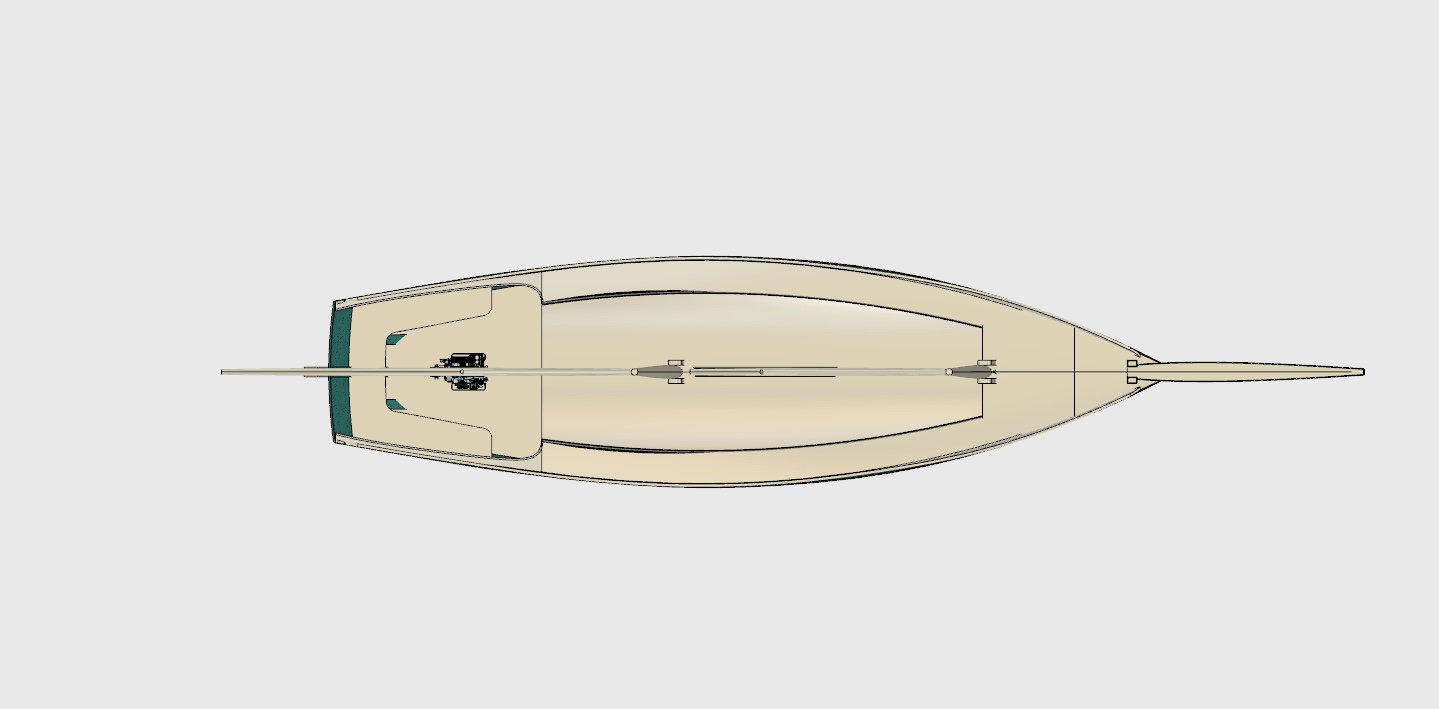

    The estimated displacement is around 20 000 lb.
    You are really afraid that it will be too small!!! Maybe you right, maybe not...
    The thruth is that I am afraid to end up too big!!! If it is too big everything gets more complicated, more time consuming, more maintenance, more expensive, etc...
    I believe that the Sharpie Schooner 42 that I am working on is just as big as a simple sharpie sailboat can be for its intended purpose.
    Will I actually build this sailboat? Don't know, but having fun designing it! If ever a sailboat similar to the one I am designing come up on the market and my life is at the point that I am ready to go on this journey, then I might just buy instead of building. Right now in my life I am not quite ready to go. Instead I dream and I design what seams to be my future sailboat!
    The tabernacle are in the plan. Maybe you can't see them but the mast are on tabernacle. The bow sprit is also on a hinge so it can be lifted up.
    Thank you everybody for all your inputs. It makes me think about all the differents options.

    Well, this is probably the most elegant solution!!! A Beta 38 HP saildrive, that cost 18500.00$CAN.... If I go with this solution the engine will be totally enclose in a box. The box will help lower the noise, it will also act as a table and a pedestral to put the cover over the mainsail. The diesel tank will be right under the cockpit floor behind the cabin bulkhead.
    This setup should give enought space to work on the engine and all the smell and noise is out of the cabin area! I guess I need to start saving...
