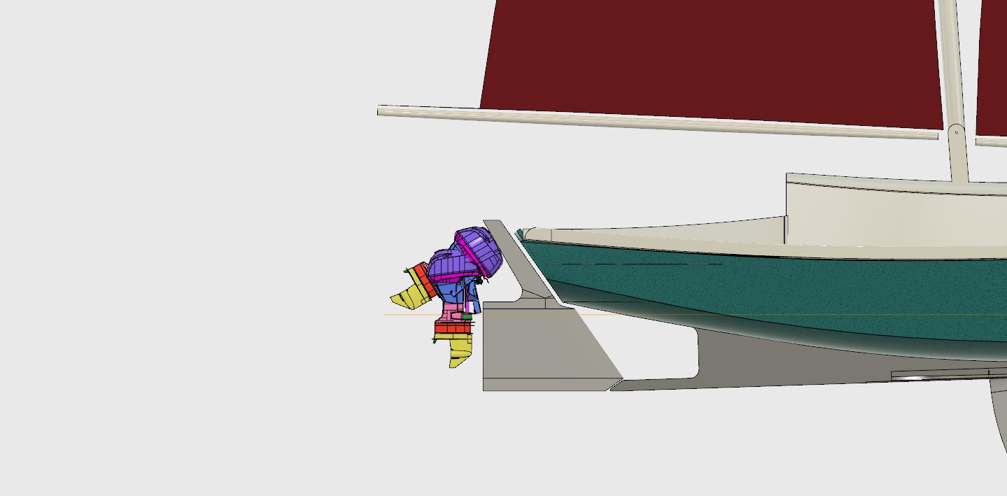

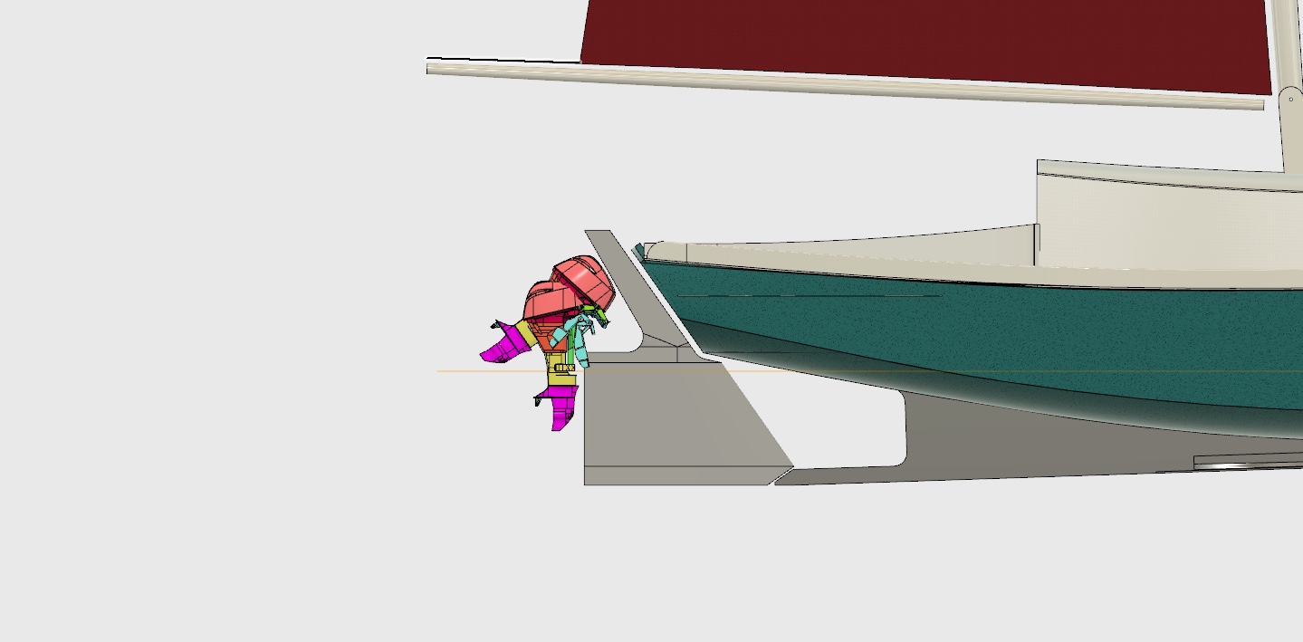

    Is this a bad idea, a really bad idea, a not so bad idea???
    The center of the propeller is about 15 inch below the waterline. I fitted a standard 20HP or a 25HP high trust both seams to fit.
    Remember that the rudder is quite big and there is boyancy helping when heeling.
    Seams to solve a lot of problem from fitting the outboard inside of the cockpit. Will it cavitate badly???
    Need your input. Thank you

    Mounted like that, you'll likely need a full set of controls and power trim as well, because you'd never be able to reach the puppy. Why are you trying to make this harder than it is? As small splashwell, cut into the transom will do and you can reach it for controls, starting etc. With a shaft, coupling it to the rudder itself, it'll remain clear while underway and you'd have vectored steering under power. It would be much closer to the end of the LWL, so it wouldn't vent near as much. Additionally, this splash well could be moved slightly forward (making it a well) and do exactly the same thing, except it would be still closer to the end of the LWL, further preventing venting.

    I give up. If KISS is overiding factor then that is the best you can do (in the well, not the rudder mount- ridiculous in my opinion). Get the 12x7 prop and don't rev past 2/3 throttle. You wont cavitate the prop until you suck most of the reserve power out of your engine . You would get about 50% better mileage if you could stick a 12x8.5 prop on a 15 hsp but you can't because it WONT FIT. A 9x7 prop would fit on a 10 hsp and get you your 6.5 in flat water. You could get twice the mileage if you went with a 12 hsp inboard diesel with a gear reduction drive(with reverse) and sail drive type prop. Just switch to a center cockpit and put a cabin where you outboard well is. Yanmar makes a 27hsp diesel outboard but the prop still too small and way to powerful a set up unless you want to push 8knots+. All of these setups lose to a 7 hsp aircooled chinese throwaway vertical diesel engine with 3:1 gearing on it coupled to the lower unit of a big broken motor outboard - or tohatsu style where its easy to remove prop size restrictions...

    Way better inboard just fwd of rudder, all thats needed is the vertical lift since rudder will steer, looks better, plus all servicing on deck at waist if u build the lift to go that high.

    Overpropping an engine so it doesn't reach its target RPM is a bad idea. If you don't need the total power, then install a smaller engine. Otherwise, the combustion chamber's pressure and temperature will wear out and/or damage the engine.

    No, what you're advocating is impossible to mount in the limited prop mounting space of the outboards on the market, in fact it's no installation option on any outboard with a in height fixed anti-ventilation plate. I've mentioned this in post #25...
    ‘‘ . . . . to mount the larger diameter prop you also need an enlarged prop mounting window on the leg. . . . . ’’
    You're restricted by the current design set up for a max prop diameter on each outboard, which makes that the max to mount prop diameter is limited by the distance (×2) between the center of the propshaft to the underside of the anti-ventilation plate, there's no or almost no room for a larger prop diameter above the manufacturer's prescription.
    Hence there's almost no variation in available prop diameters for each outboard. So the options to alter thrust are near limited to choosing another pitch, and/or another blade area, and/or another number of blades, since the max mountable prop diameter, or near to it, is already the standard in what's generally used.
