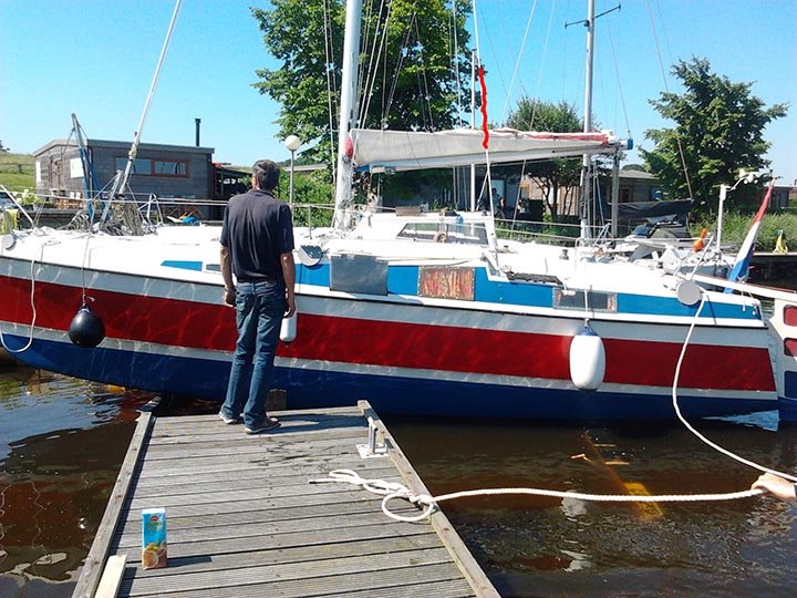

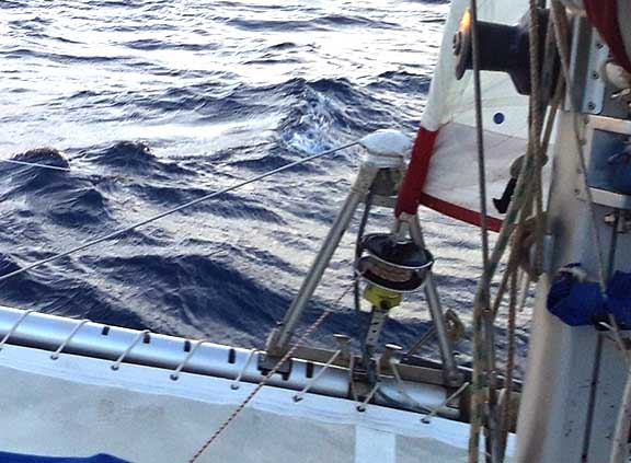

    OK A few images. Best I have to show the position of the 'Shrouds'. PO set up tackle to pull the shroud to leeward.
    Between that and the image here of the sagging forestay I wonder if the rig is tensioned enough.
    And yes, the A Frame is a bit disreputable.

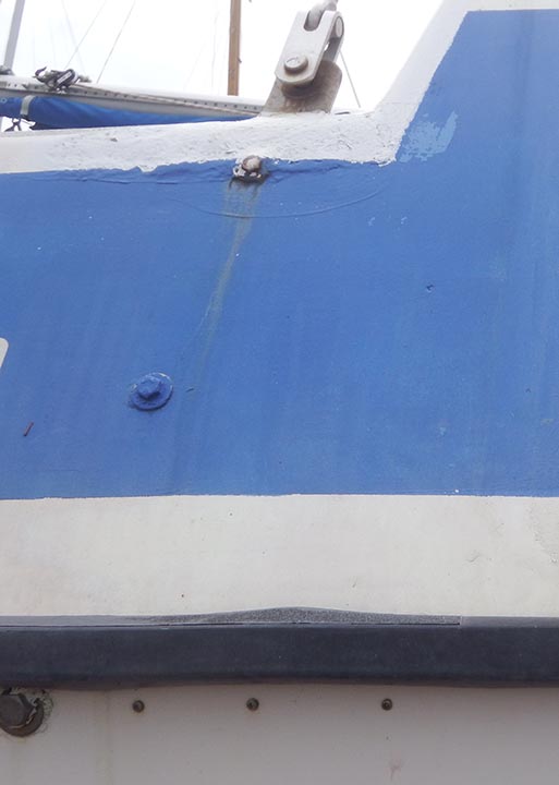

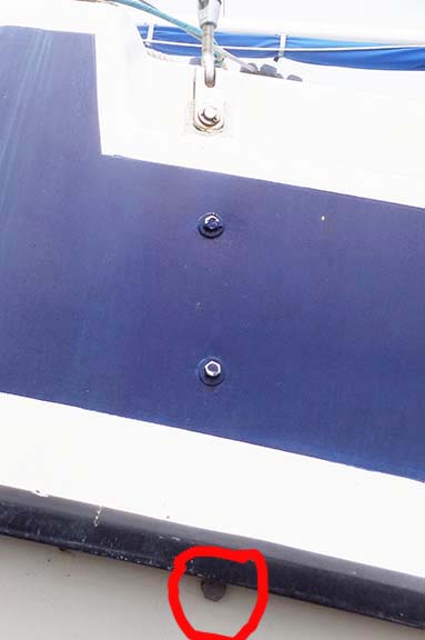

    The Chainplate as it's installed is a bit... 'creative, entering through the deck and in the inside of the hull. I suspect to get around the hull deck joint and the buffer. It has been reinforced, but I feel it needs attention. Another job. There are quite a few.

    Perry,
    I can't say what the appropriate load limit is on your chain plates, they look adequate, if a bit home made. Chain plates through the deck and attached inside the hull are not unusual, only those exposed hex-head bolts lack aesthetic appeal.
    My immediate reaction to your rig is it doesn't look like you have the rake right. I can't be sure from your photos, but it looks like your mast has a forward lean. You may get better luck tensioning the forestay with about six or eight inches of rake aft.
    As far as the terminology goes, I would call those stabilizing stays simply, 'diagonals'. You have the #1 reverse diagonals from the mast foot to the first set of spreaders, then the #1 diagonals from the first spreaders to the mast at the second set of spreaders, then the #2 reverse diagonals and #2 diagonals going down and up from the second set of spreaders.
    I also can't tell what's going on with the back stay. It looks like the only line that comes off the masthead is your topping lift. Is that an adjustable back stay that attaches to the mast at the same level as your forestay? How does that work? How high does your sail raise?

    How much 'sag' do you have in your forestay?
    There does not appear to be much in that first photo of the A Frame and the furler?
    There appears to be some 'pre-bend' in the mast, which is to be expected on a fractional rig, even though it is only very slightly (about 9/10?) fractional.
    If you do need to get the forestay tighter, is it possible to put any more tension on the cap shrouds?
    Or even fit a pair of running backstays again?

    Re how the chainplates are only bolted through the hull (as shown in the last two photos) - I would be happier if there were long backing plates (at least the same size as the chainplates on the inside) in way of the securing bolts, rather than just having large washers under the nuts.
    Can you elaborate some more re how you are unhappy with the reinforcing of the hulls / bulkheads currently? Maybe add some more photos?

    >>> the inside of the hull shows that the chainplates have some fibreglass additions, but god they're messy. Just strips. These pics aren't that clear, but best I have and enough to make me unhappy.
    I'm of the opinion that the straps should be wider/ larger/ a different shape and preferably on the outside, while the inside I reckon needs to have a substantial piece of material glassed on of a similar size at least.
    My feeling is that the whole arrangement needs to be larger to spread the load if I need to put more tension on the stay.
    I am also inclined to suspect that the position of these shrouds might have been placed a little further aft.
    Despite my unhappiness with the job done, however, the boat has an Atlantic circuit to its credit and so I guess it works. I just don't have a lot of confidence in the work that has been done on the boat, the cumulative extent of which makes me uneasy about the quality of all of these jobs and this in particular. Ah. For example PO told me he had redone the mast step by bolting it tapped through the top of the X beam. and that 'in his experience' the corrosion would hold the bolts tight. No Tef Gel. If he had through bolted it I think I might have let the whole idea of buying it go. It was the PO's to do what he wanted, now its mine. An old story.
