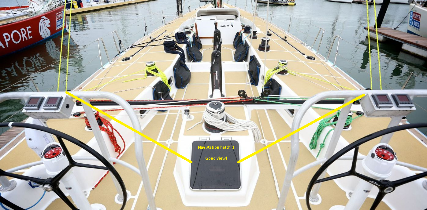

    On the topic of weather and keeping eyes on deck, one sailing configuration I really like is a nav + weather station just below deck and forward of the helm. If you're on the helm and want a weather update, just tap your toe on the nav station hatch and get a wind/weather update. On nice days you can leave that nav station hatch open and watch the nav & weather instruments. I've sailed in smaller ~45ft boats with this configuration and larger ones too. A must for a good design in my opinion.

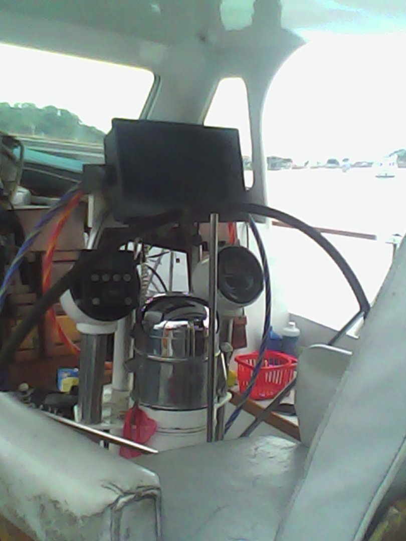

    My last boat had big deadlights in a raised nav area and salon. From the helm you could check the laptop through a 14"x18" window. The boat I'm running now has this... 14982443593772080873455.jpg
    JosephT likes this.

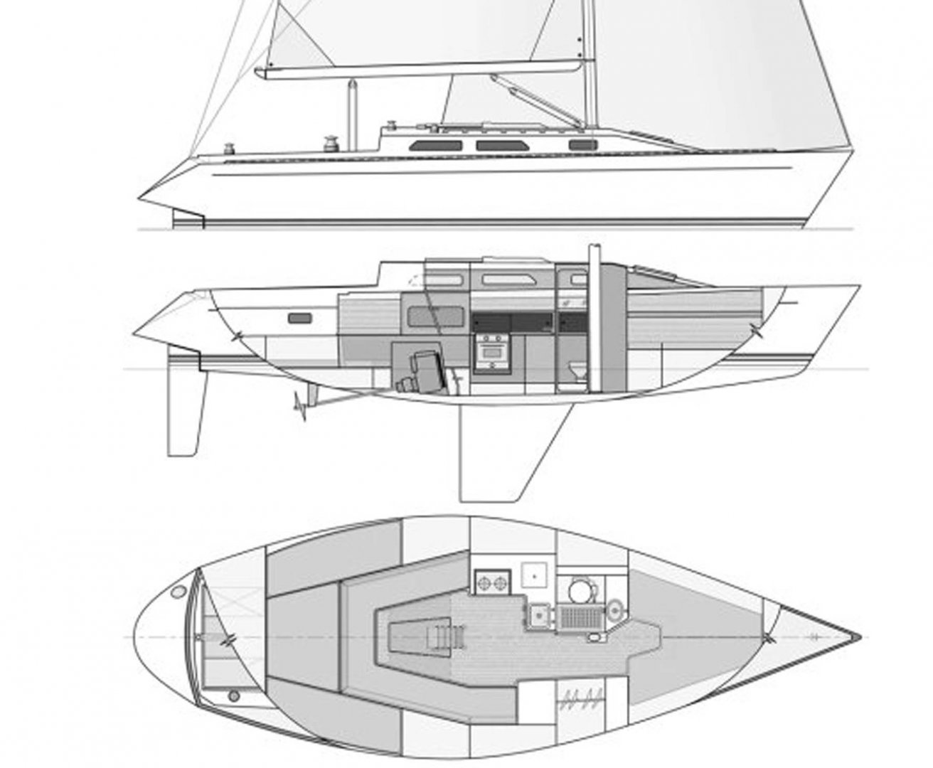

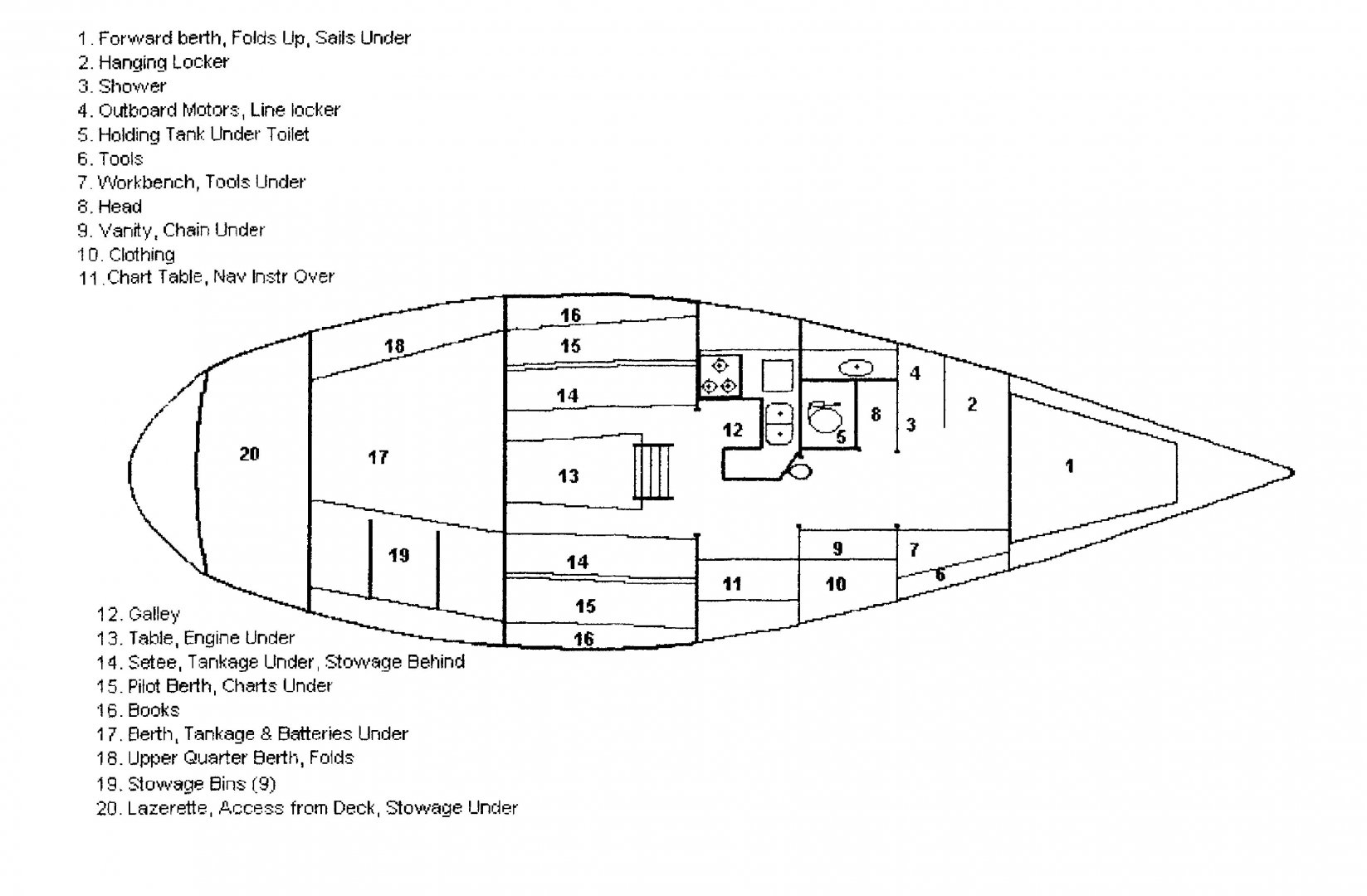

    Not entirely unique. WD Schock NY 36, William Cook design was similar, and a very sweet sailboat.
    My own yacht Serendipity 43 (Wings) also has the Settee and table (engine box) under the cockpit.
    This layout has been excellent for us. In port we sleep aft. At sea we sleep in the settee, (with lee cloth). The watch stander is usually on deck under the dodger while the boat sails by itself on the wind vane. The on-watch person and the off-watch person are very close for easy communication. (Usually the boat is sailed double handed). For more shots of the interior go here <Wingssail Images-Cruising Photos from Around the Pacific> http://wingssail-images.blogspot.mx/2005/06/wings-interior.html. For exterior view and information go here <Wingssail Images-Cruising Photos from Around the Pacific> http://wingssail-images.blogspot.mx/2008/01/wings.html
