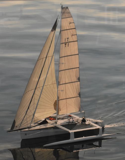

    That is a function of the roughness of the rig on the model. Apart from foiling Bucket List, which is a test bed for the Volvo Proa , all harrys have unstayed masts. There is more on that boat and it's rig at http://harryproa.com/wp-content/uploads/2017/10/volvoproa.pdf
