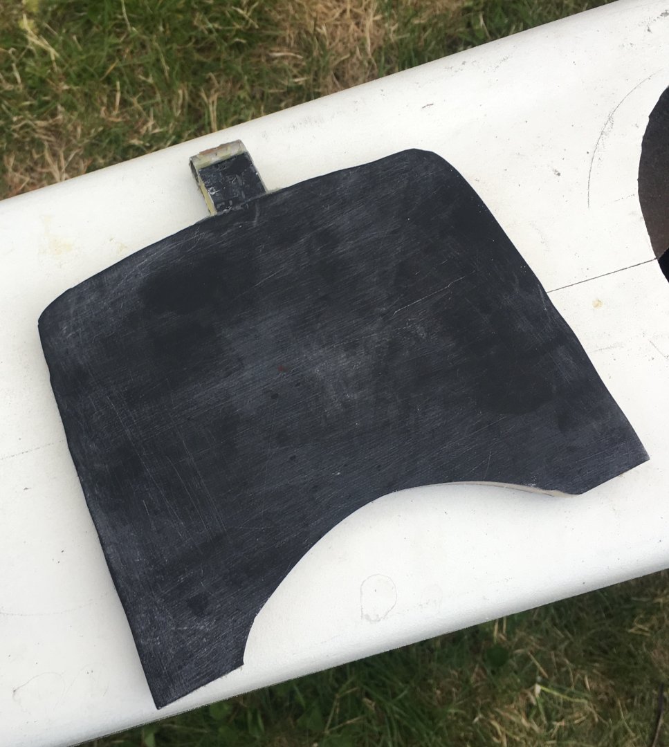

    That one is a little dated, so you’ll have to catch up! The guys at SA Multihulls carried the discussion further to an acceptable solution. Still not decided which way to go. Found a block of 10mm G10 in my workshop that might be used. Will anyway start cleaning up the right inside with the Dremel tomorrow, if weather allows.

    The forestay fitting design went into a completely different direction. This is the bulkhead to be fitted inside the hull with the help of epoxy and carbon fiber. A pair of wooden dowels are temporally fitted to guide the bulkhead. The chainplate will be anchored to the bulkhead with 6 layers of 220gr carbon fiber. The 118gr bulkhead is made from plates of 1mm G10 on each side of 10mm Divinycell.

    That looks good, I'll be interested to see how you go about spreading the shearing force-load,the bulkhead looks like it could act as a guillotine.
    You could glass in Stringers, let them cure, say 600mm long, cut notches in the bulkhead in its corners to take the stringers , then glue the bulkhead to them. I'm guessing this is your intention.
    It's going well, any results from trying to saturate dyneema with epoxy?

    The bulkhead will be epoxied to the hull sides with three layers of 220gr carbon fiber to transfer the load. Will not load the deck very much that way.
    Have not experimented with dyneema and epoxy yet, but will do.
