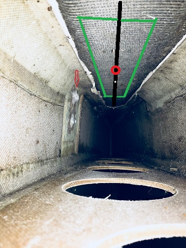

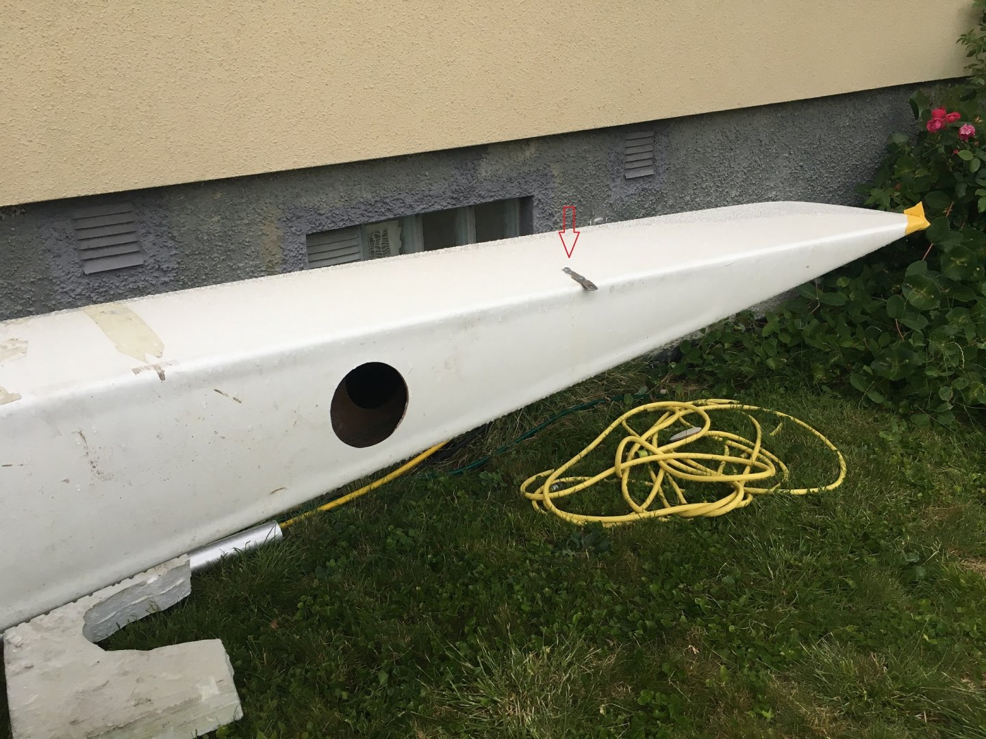

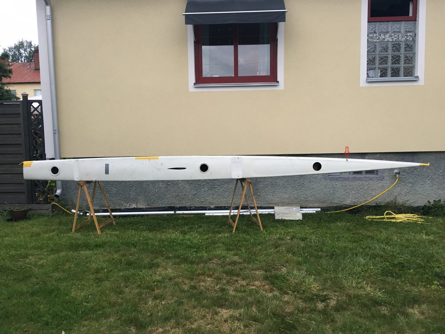

    Cut an opening in the A-cat hull, to be used as center hull on my Windknife trimaran. My idea is to add a second forestay chainplate on the opposite side of the hull.
    I had hoped for the hull sides to be reinforced on both sides, but they wheren´t. Hull is made from epoxy/grp/foam sandwich. Did an ugly simple sketch on a possible solution. Question is if the foam needs to be removed and replaced by injected epoxy in the actual area?
    Hopefully there is a better and simpler solution to this?

    You need to reinforce like the other side !

    A spreader plate the shape of the deck in aluminium, glass or stainless as well as the new replica of the original chain plate set up perhaps. Strengthen the deck hull join longitudinally internally a little while your there, . Not sure about the through bolts ? but I'm no expert. regards

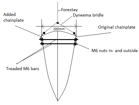

    The force from a 90 degree bridle will result in about the same vertical force in the hull sides as the original A-cats forestays. There will also be an inward force of the same magnitude, thus there need to be something like the bolts or a rod between the hull sides to take up the compression.
    Don´t want to open up the structure. Drilled holes for the new chainplate in the outer layer and removed the ca 3-4mm hard foam from the sandwich in the area surrounding the new chainplate and will inject West Six-10 in the cavity. This together with a G10 plate with a few layers of glassfiber mat upon at the inside going up under the deck, will make the buildup simpler.
    Idea: If using a thick wall alu tube instead of the upper bar, it makes if possible to arrange the bottom of the bridle going through the hull/chainplate. See simple sketch.

    From your diagram it looks like the top through bolt is below the widest point so compression there is unsupported. Oldmulti posts would probably suggest making a fibreglasss foam sandwich transverse deck beam glassed underneath to manage the load, . I'm working on off the beach cat hulls too and have reached the conclusion that access holes have to be made in the deck to be confident that the glassing is done properly. Before replacing the "divet" I'll reinforce the hole

    Access to the inside of the chainplate area is very limited, don´t think I will be able do anything more complicated than what I described earlier.
    The dyneema is supposed to be a sling, with its ends meeting at the forestay.

    Sorry just being a bit silly , it's a golfing term , it refers to the lump of grass taken out with a golf swing. There isn't much room in the fine bow but as long as the hull deck join isn't cut and is added to a little, the overall strength and look shouldn't be affected.. How much extra load do you expect to add to the area above its original design specs is the riding question as to how good an answer can be I think.. Nice diagram by the way, very neat. Aluminium tube is mentioned on Oldmultis thread for through bolts on masts. Where the lyros plastic bends is the point I was concerned with.

    Another, but a litte more elaborate solution. Inside width is in the ballbark of 150mm/6".

    Looks a bit complicated solution. Why not new composite chainplates on both sides? Add a bulkhead inside the hull and laminate carbon fiber chainplates..

    So you recommend to rip up the hull and really complicate things:D? Note, the intention is to do the opposite. I’d like ideas of a simpler solution, not more complicated. My sketches are just results of crazy brainstorming, nothing to take to serious. This one is the latest one, with a dyneema internal bridle, unfortunately leakage would be a problem if this one should be used ;-) .
