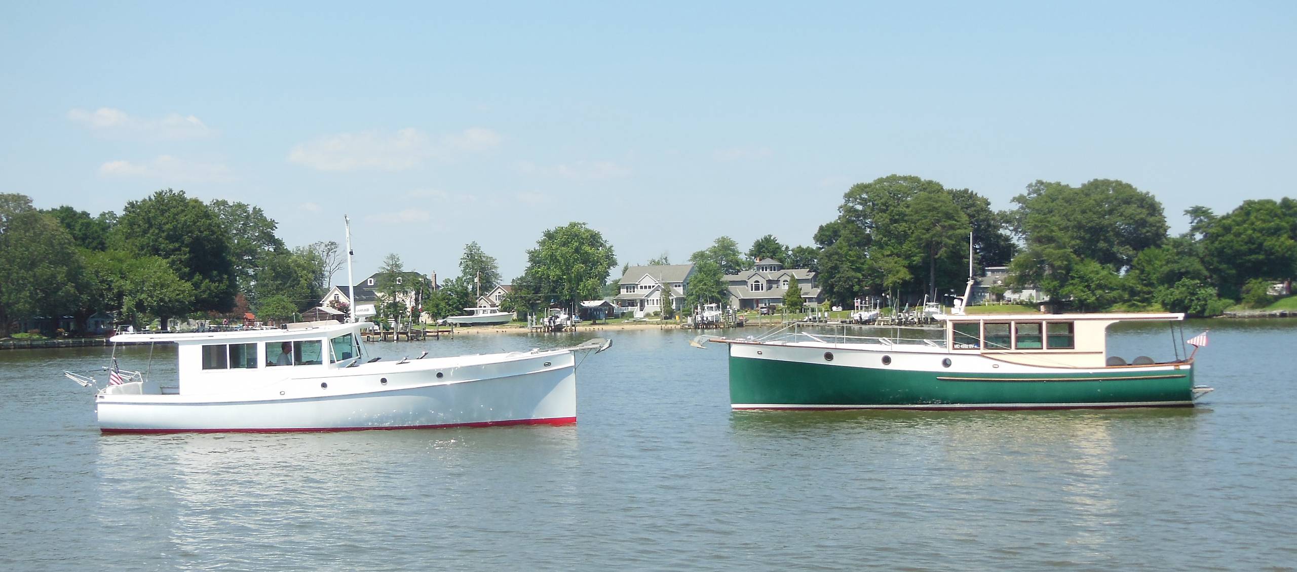

  4. Tad
    Joined: Mar 2002
    Posts: 2,331
    Likes: 241, Points: 73, Legacy Rep: 2281
    Location: Flattop Islands
    Tad Boat Designer
    These are about half the weight and HP of the Pilgrim, with about 2/3rds the accommodation. Burn around half the fuel the Pilgrim uses at the same 7.5 knot cruising speed.
    Photos by Becky Moreland at Swan Creek, Maryland.

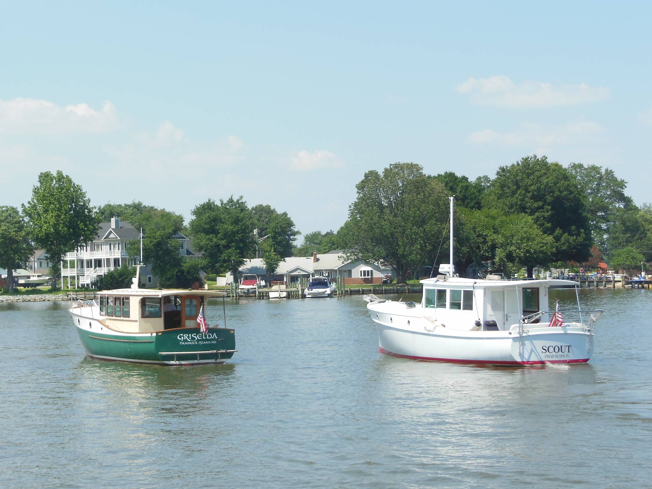

  5. tom28571
    Joined: Dec 2001
    Posts: 2,474
    Likes: 117, Points: 63, Legacy Rep: 1728
    Location: Oriental, NC
    tom28571 Senior Member
    Tad,
    I see a few minor appearance touches that make the Yellow Cedar just a bit better looking to my eye, than the Memory 38. Is there any other significant difference in them?
  6. Tad
    Joined: Mar 2002
    Posts: 2,331
    Tad Boat Designer
    Tom,
    The window differences are the most obvious. The white boat (Scout) was built by Memory and has about 1" more freeboard forward, another inch of crown in the foredeck, and the house is another inch or so higher, all done to gain headroom and get the sole up over the engine. She floats similar to the Yellow Cedar because of more weight I suspect. There's more curves in Scout's roof as well, but their hull forms are supposed to be identical.
