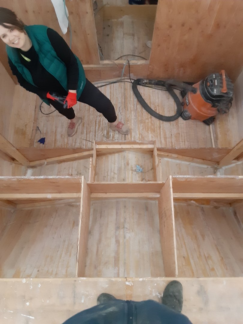

    So I'm soon to build the cockpit sole. I'm in the ironic situation where the hull form and power could manage far greater loads than the sole could ever bear.
    But I'd like to get close...ish. The relevant area is where Anne is standing, and the other side of the low bulkhead right in front of her feet.
    My thinking is to install a series of floors, as watertight bulkheads in 12mm plywood with upper and lower flanges/fillets. With a heavy plywood sole bonded down, the hull would function as the lower chord, the sole as the upper chord, and the ply floors between as the web, or triangulation.
    With a 16mm plus glass hull, and a 16mm plus glass sole, the question I come to is, what spacing to set the transverse bulkheads at. Too close is extra work and weight. The sole (or maybe the hull!!) fails first. To widely spaced and they crush, while the sole still is fine. Actually this is a non trivial question. Very dependent on hull form, web depth, and many other factors. 20210408_194738.jpg

    You have to sample it and decide how much flex you can tolerate.
    The skins add little, so you can test the plywood alone, then the skins just add a wee bit more.
    Don't fall into my friend's fallacy that the other edges support the span...they don't.
    I had a couple pieces here 12mm and I don't like a 19,5" opening, but I do think a 16" opening is okay. Not a span rating. An opening rating, if you will.
    Another thing you can do is make a small i beam. Rip some 12'm stock down to 25-40mm. Bond the 3 pieces into an I. Next day, fillet the channels and lay in a piece of glass about 3" wide.. Next day flip and repeat.
    Then bond those above a small block bonded to the other frames or bulkheads. They split the spans for a bit of weight only. As little as 3" of stock can work. Mine are one inch web, two inch flats in foam. But in ply, you can go more like inch web and inch and a half flats. Make em 30" long or as needed.
