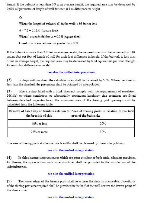

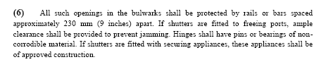

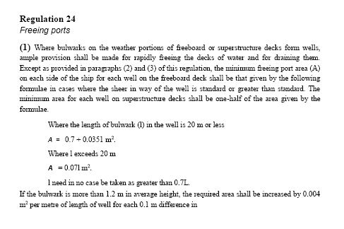

    If you want to go... full on regulations (an over kill), you could use the LoadLine rules:

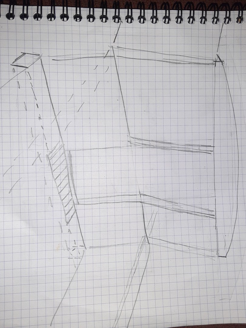

    No, the 32" depth did not include the trough. That would increase drainage rate, since it increases the hydraulic head, without significantly increasing the cockpit volume.
  15. DogCavalry
    Joined: Sep 2019
    Posts: 3,637
    Likes: 1,821, Points: 113
    Location: Vancouver bc
    DogCavalry Senior Member
    Trough like this. Sliding door omitted for hard-to-draw.
