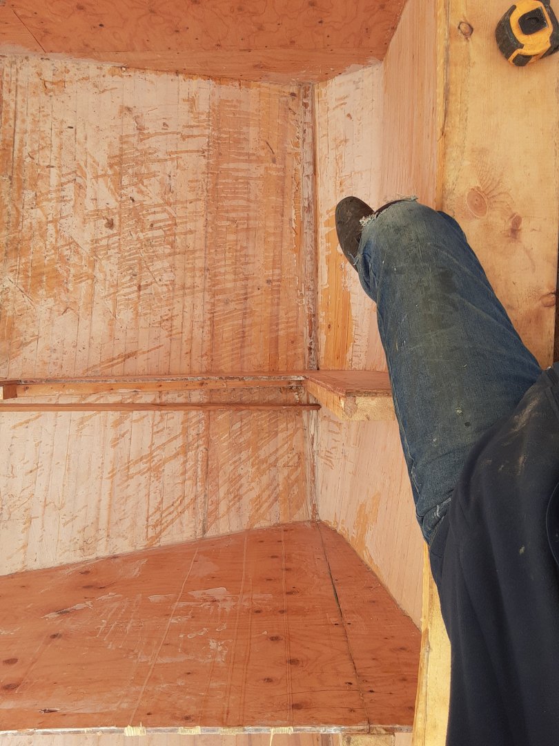

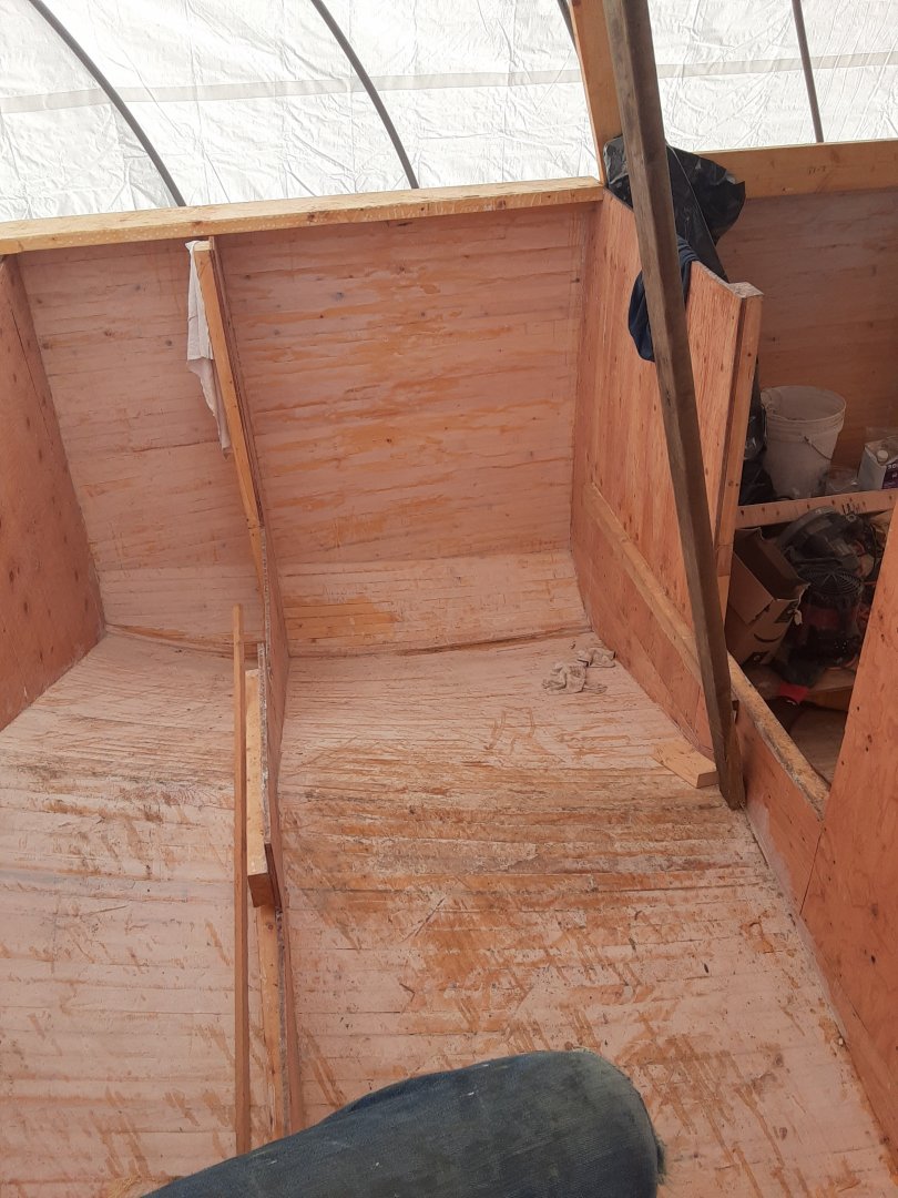

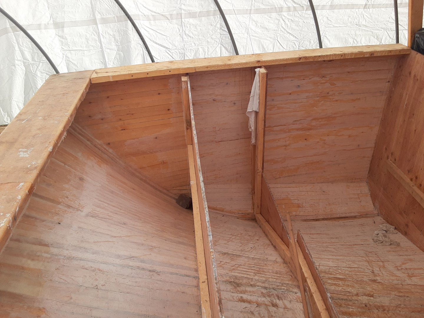

  12. DogCavalry
    Joined: Sep 2019
    Posts: 3,637
    Likes: 1,821, Points: 113
    Location: Vancouver bc
    DogCavalry Senior Member
    A picture is worth a thousand words. 20210306_150455.jpg 20210306_150245.jpg 20210306_150227.jpg 20210306_150216.jpg 20210306_150114.jpg

    Bluebell, can you let Bajansailor know about local sea states? As far as distance to jobs, not generally further than 40nm. But if the client shows us the money...
