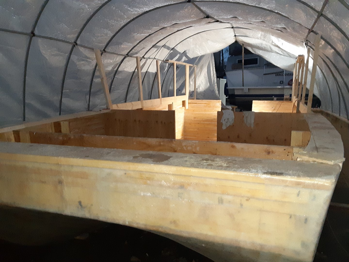

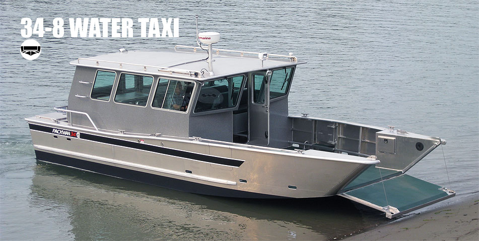

  5. Cajunpockettunnel
    Joined: Aug 2020
    Posts: 330
    Likes: 179, Points: 43
    Location: Franklin, LA
    Cajunpockettunnel Senior Member
    Plumb, its more appealing to the eye. At least mine anyway.
  6. DogCavalry
    Joined: Sep 2019
    Posts: 3,637
    Likes: 1,821, Points: 113
    Location: Vancouver bc
    DogCavalry Senior Member
    Plumb is easier and stronger to build, and slightly lighter. But most boats seem to have the forward leaning posts. Like this. 34-8mainphoto.jpg
  7. Cajunpockettunnel
    Joined: Aug 2020
    Posts: 330
    With all of them leaning forward, including the back of the cab it doesn't look too bad. I still like the plumb look better.
  8. cracked_ribs
    Joined: Nov 2018
    Posts: 160
    Likes: 148, Points: 43
    Location: Republic of Vancouver Island
    cracked_ribs Senior Member
    Full on LOL
    Here's my window thought: I bet 3 squares and one angled window is cheaper than four parallelograms.
    Cajunpockettunnel and DogCavalry like this.
  9. fallguy
    Joined: Dec 2016
    Posts: 8,745
    Location: usa
    fallguy Boat Builder
    Much like cr, I find the raked windows sexy, but not real practical unless you are cutting many of them out.
    DogCavalry likes this.

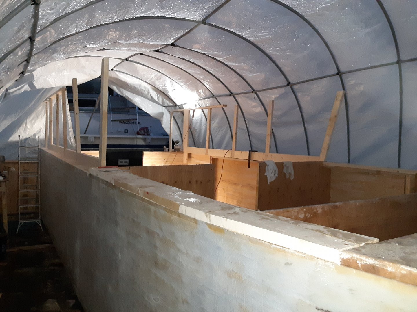

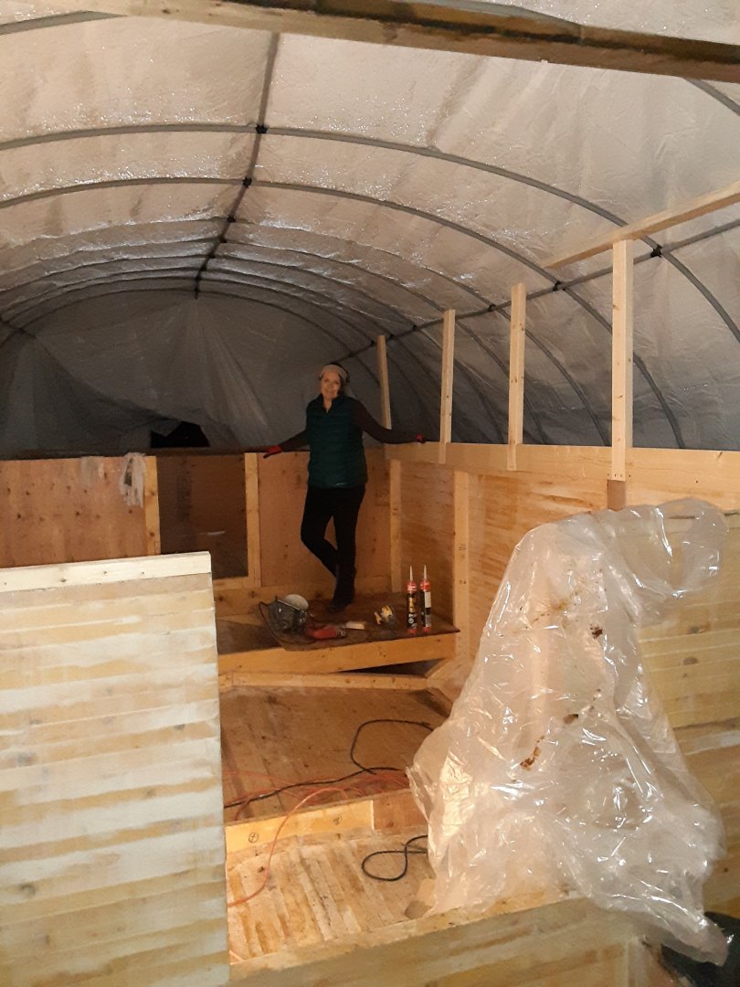

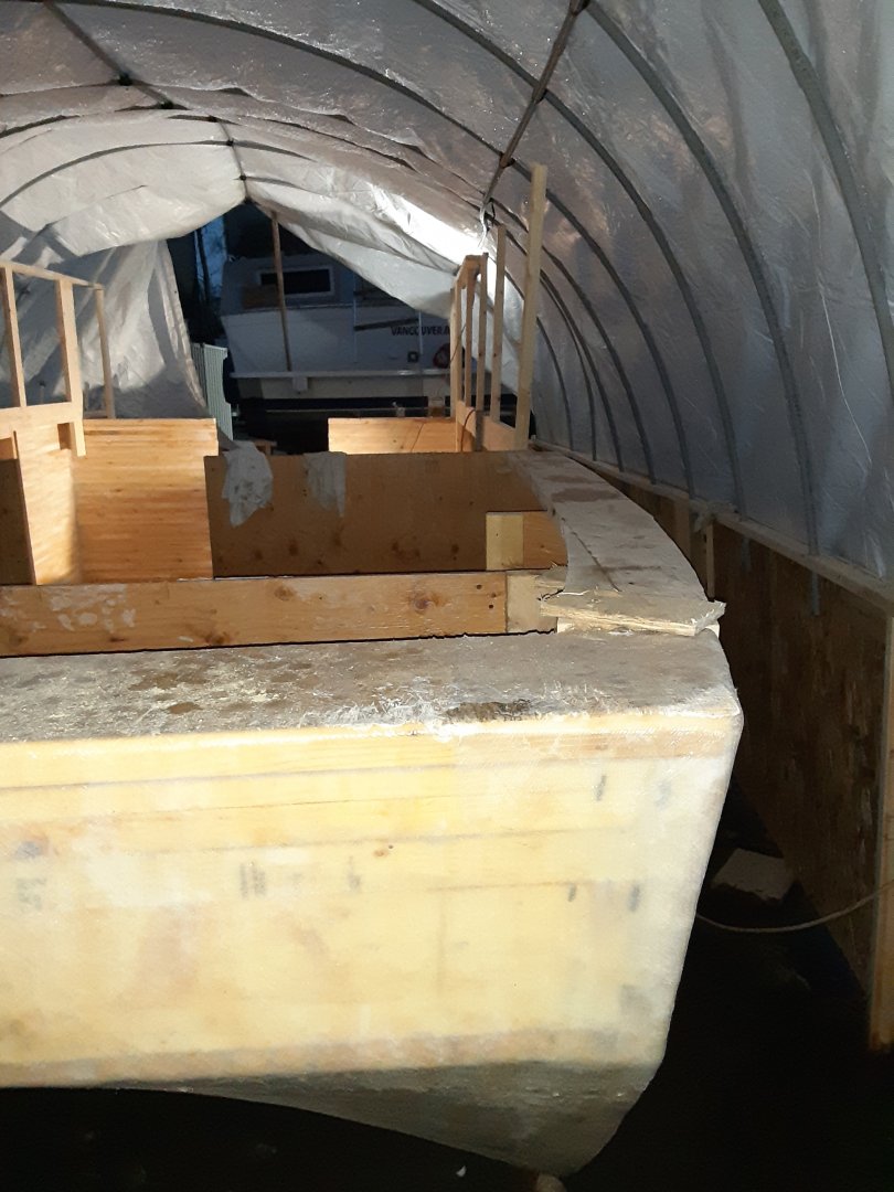

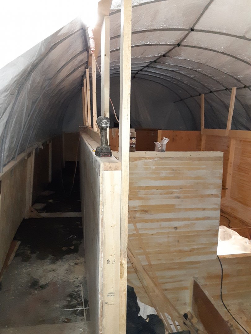

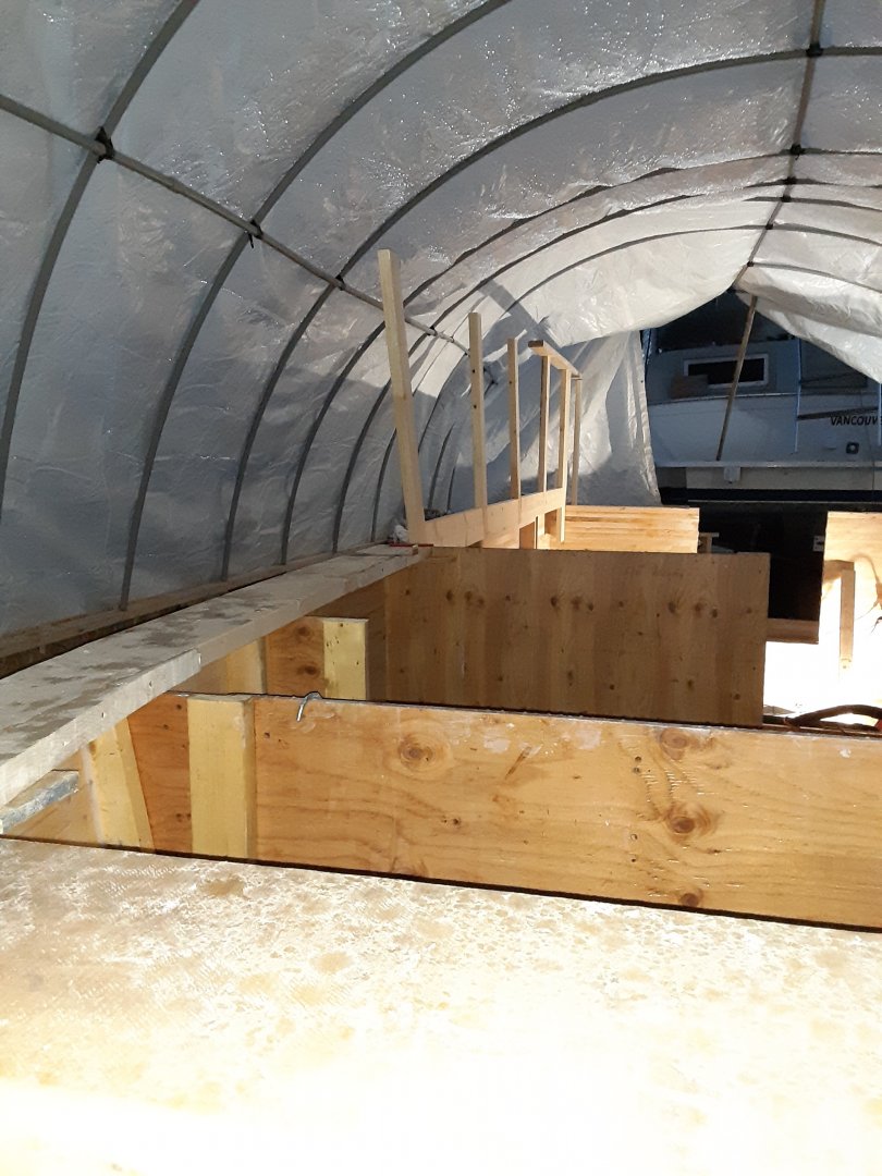

    20201205_170707.jpg 20201205_165843.jpg 20201205_164750.jpg 20201205_164733.jpg 20201205_164637.jpg 20201205_164626.jpg 20201205_164615.jpg 20201205_164552.jpg
    Plumb it is! 2x4 posts, with 2x6 below overlapping onto side deck. 2x4 for header tomorrow.
