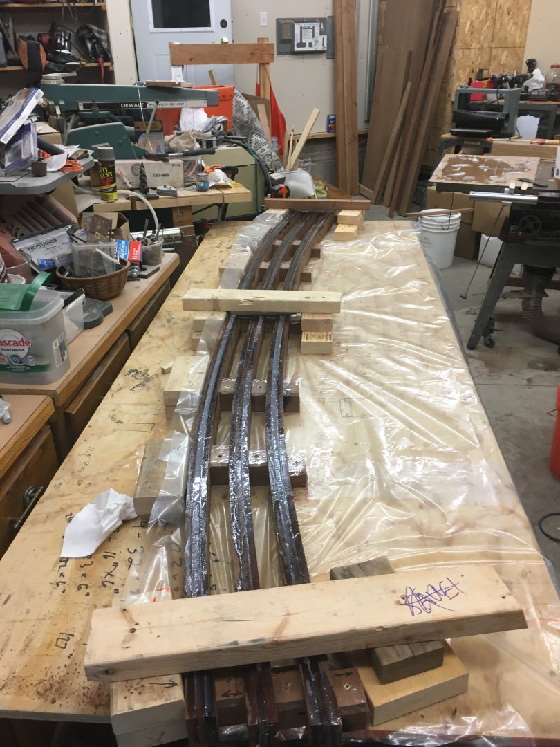

    Wheelhouse roof
  10. fallguy
    Joined: Dec 2016
    Posts: 8,745
    Location: usa
    fallguy Boat Builder
    Curved or flat?
    Two 1/4" roseburg marine panels are nice. Stagger joins. Epoxy them together.
    curved-built laminated timbers from 1/2" knot free timber

    Make curved timbers on a jig.
    use 1/4" okume or roseburg panels
    sheath the top in 1200

    These are redwood. Find some vg clear fir flooring or something like. CE46228A-6D09-4E95-A0CC-60BC05726F53.jpeg
