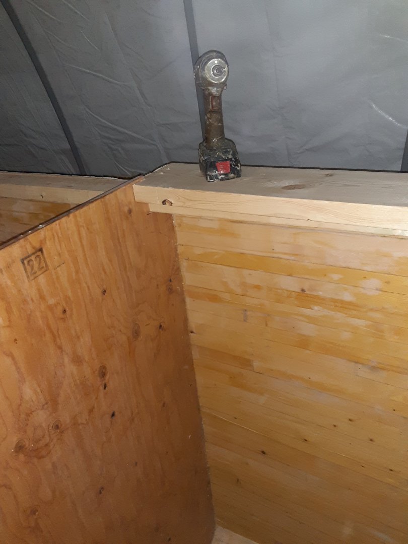

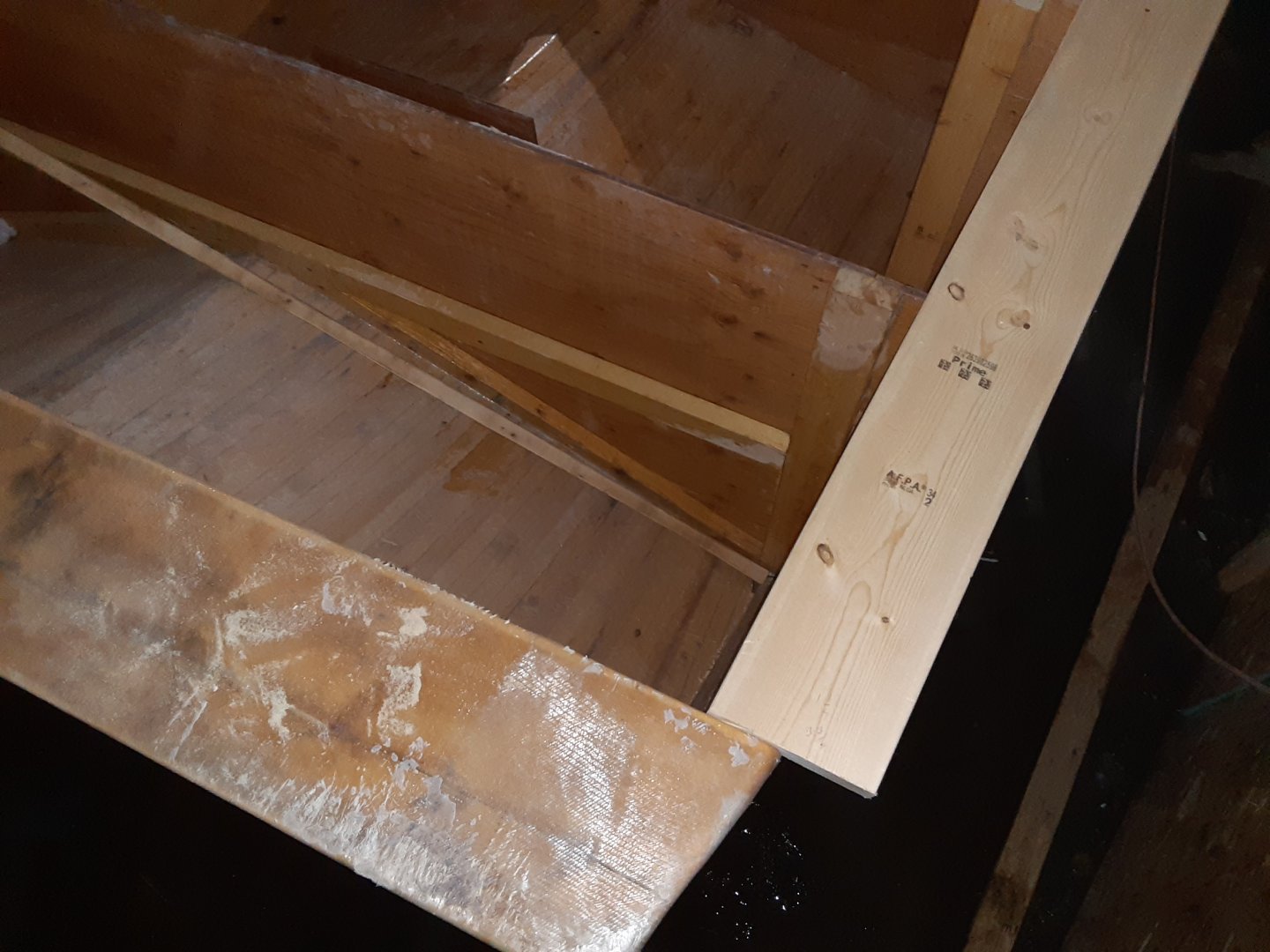

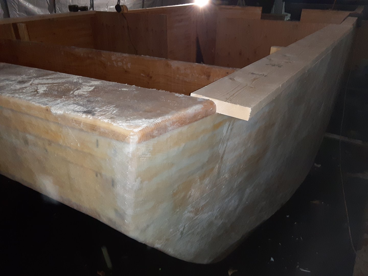

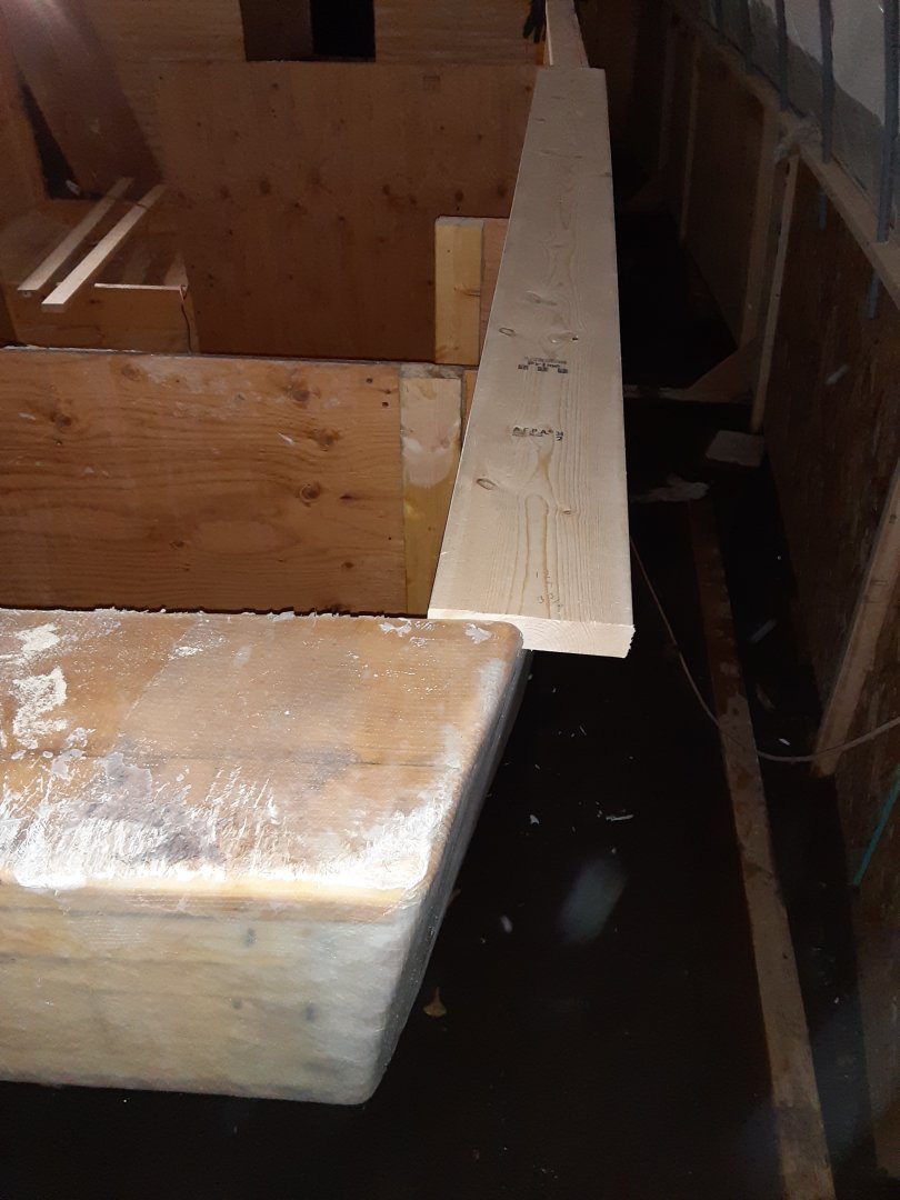

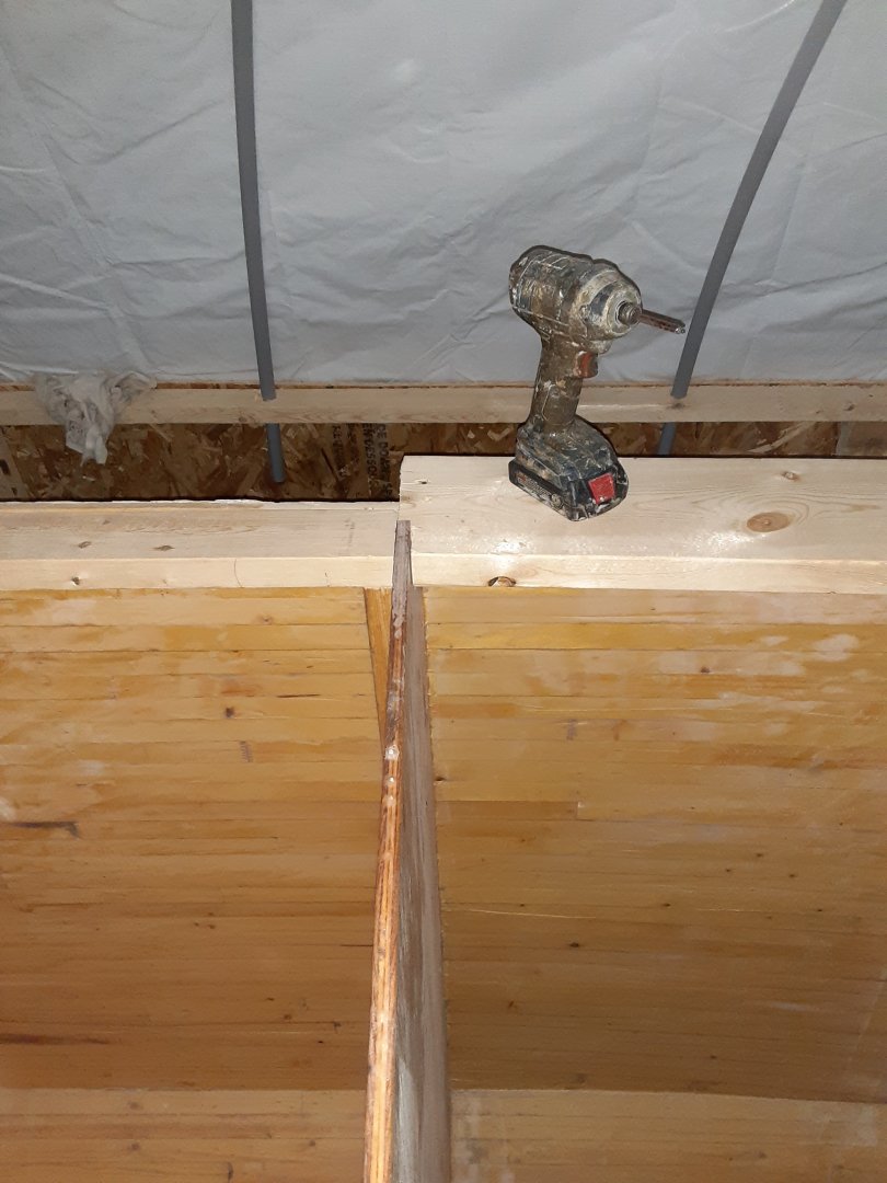

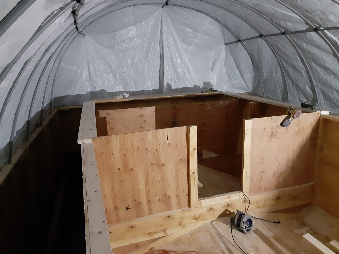

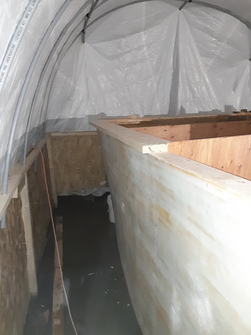

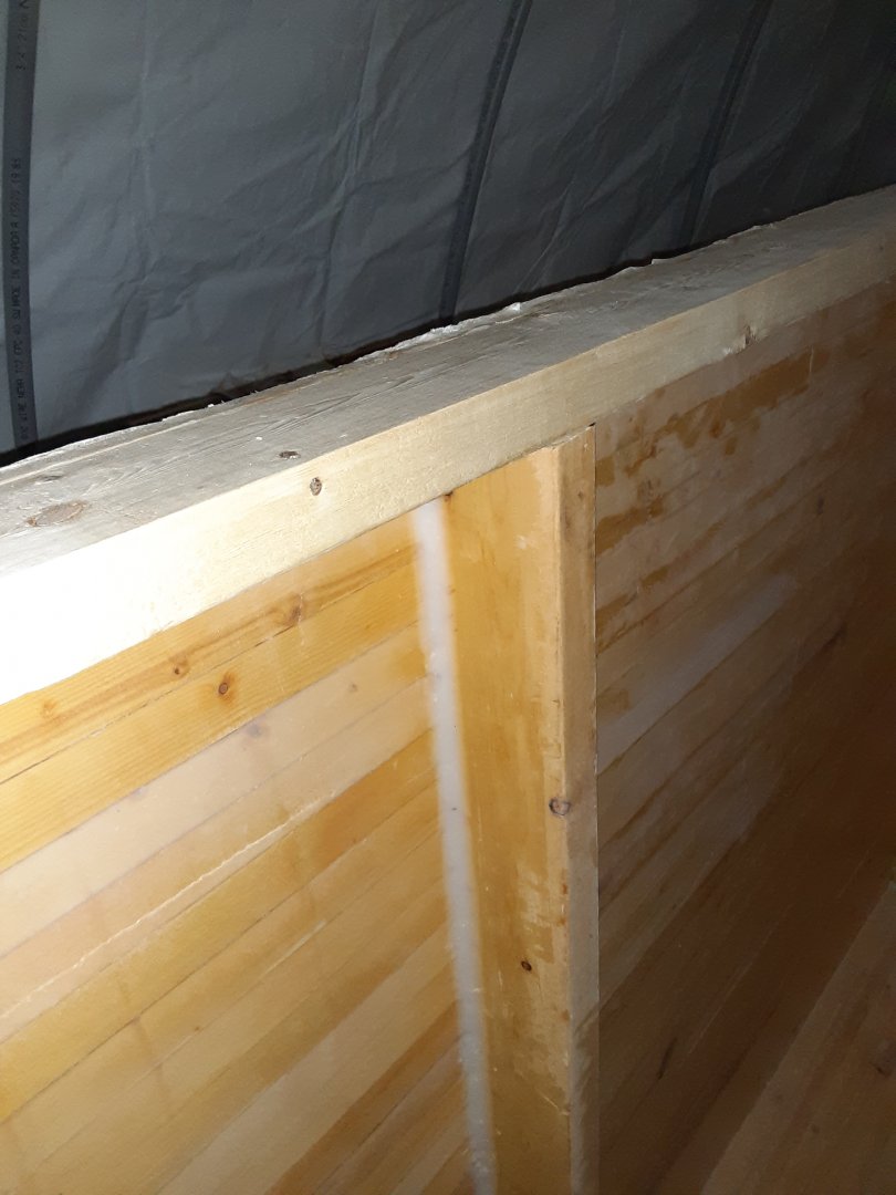

    20201121_175950.jpg 20201121_175901.jpg 20201121_175804.jpg 20201121_175725.jpg 20201121_175551.jpg 20201121_175302.jpg 20201121_175235.jpg 20201121_175215.jpg 20201121_175156.jpg
    A bit of carpentry to take a break from epoxy. 2x4 side decks in way of the wheelhouse. 2x8 forward by the cockpit, up to the ram. 2x8 will shape down some, tomorrow. Planer and sander work.
  12. bajansailor
    Joined: Oct 2007
    Posts: 3,977
    Likes: 1,854, Points: 113, Legacy Rep: 37
    Location: Barbados
    bajansailor Marine Surveyor
    Will the 2" deep side decks effectively form the gunwhales / rubbing strakes now, or will you perhaps make them deeper?
    And re how there is a horizontal 'step' where they butt on to the ram, will this have (eg) a triangular fairing piece on the outboard side of the ram on each side?
    Or will the 2 x 8 be tapered down to meet the ram?
    DogCavalry likes this.
  13. DogCavalry
    Joined: Sep 2019
    Posts: 3,637
    Likes: 1,821, Points: 113
    Location: Vancouver bc
    DogCavalry Senior Member
    The 2x8 will be planed to match the curve of the hull side, then radiused along all edges for continuous glass outside to inside. Inner edge of the forward side deck I plan to leave straight. A small aesthetic sacrifice in favor of uninterrupted wood grain strength. It transfers impact loads from the ram all the way to the stern. I dont know if it's clear in the pics, but the 2x4 side deck carries foreword 2' under the larger side deck, so there's a huge contact area to transfer force by shear.
    BlueBell likes this.

    Get yourself a longboard. Buy some 36 grit floor papers from HD and cut the board to fit. I put some HD wooden table legs about 6"? Long on each end. I think the board is 18"x2-2.5" wide. After some planing, run the longboard up and down the gunnel[sic] on a 45 degree angle out forward in aft. Consider drainage away from versus into the boat.

    Yes, those side decks are dead flat. That's easiest to build, and strongest, but I can put some camber on them without much strength loss.
