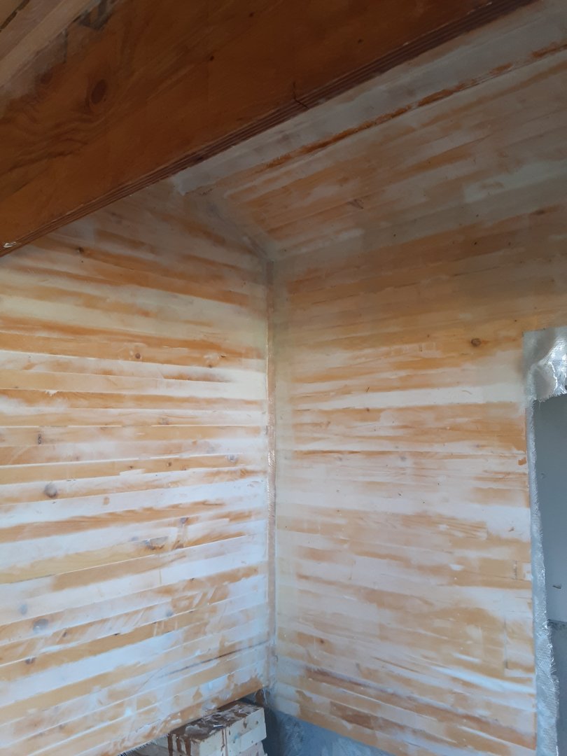

    Too fast. 15 batches in this area, I mixed a batch with the wrong ratio. That's twice in just 300 batches. 20200920_132047.jpg
