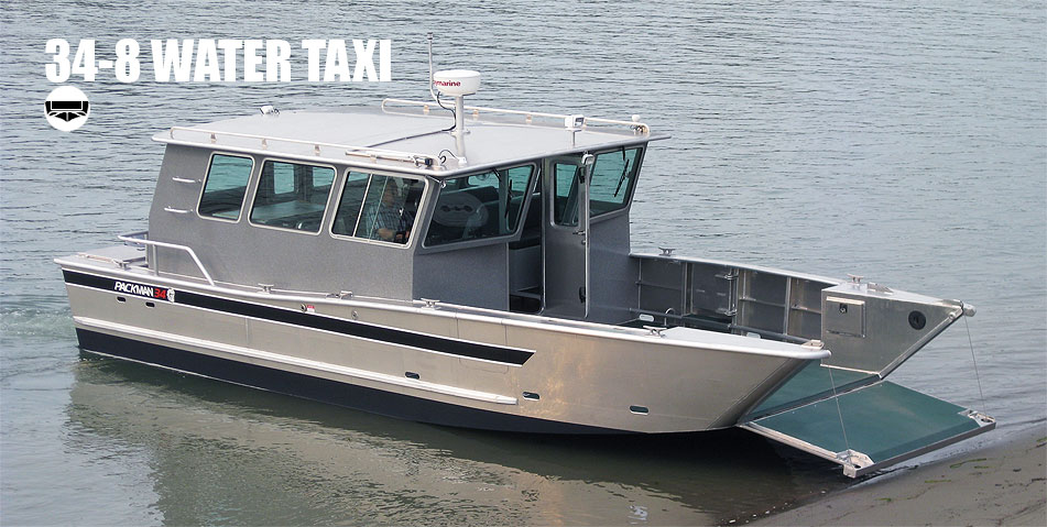

    A few more days of basic fairing, then I'll turn it over. And then I have to design and build a superstructure and foredeck area. I'll be actively soliciting input at that point.
    Ad Hoc sent me a link by email to Munson boats a while back. I think I'll do something like their medium walk through wheelhouse. But arranging the forward cockpit and foredeck area is a little more up in the air.

  8. DogCavalry
    Joined: Sep 2019
    Posts: 1,299
    Likes: 711, Points: 113
    Location: Vancouver bc
    DogCavalry I aim to misbehave.
    Along these lines. No drop bow. More structure in the forward area than a simple box.
