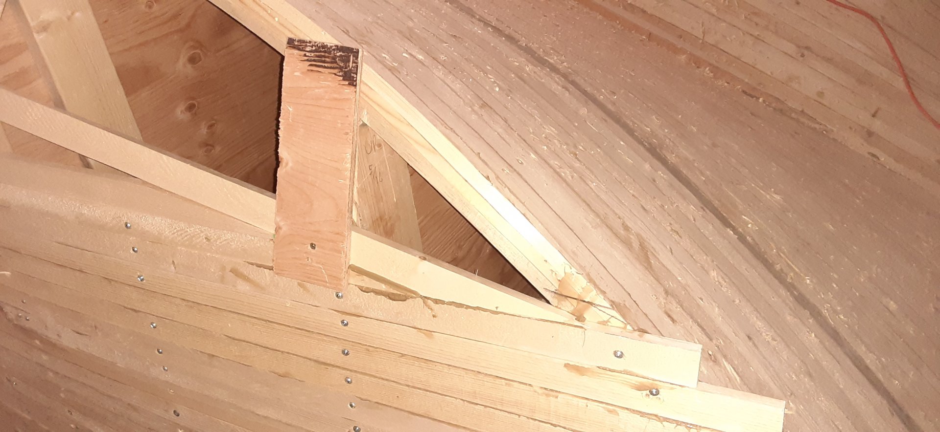

    When I started this, I knew I had one window of opportunity. I live in Vancouver BC, which is, as far as I'm concerned, the best place I've ever lived. But its damn expensive. Last fall a friend offered me a shop, for a year. And my partner Anne, told me: "Now. The time is now."
    It's been 28 years since I have built a boat. And those were 40-50' carvel construction ketches.
    I wasted the first month and a half frantically studying and relearning engine compartment design, before simplifying and going with outboards.
    Another month lost on the lines, layout, assembly details. And then I had my revelation: there isn't time to learn everything before I start. There's barely time at all.
    I lofted her on the shop wall, and started building bulkheads. I would have loved to run those lines through software and tweak them. No time! Get it right when I get there.
    Work 8-430 outdoors in the winter, then drive to the unheated shop and work 5-10. Get home and sleep with sawdust in my hair. Anne at my side. Love.
    Bulkheads built, figure out a strongback with what I have on hand and assemble them. How to plank? Not now.

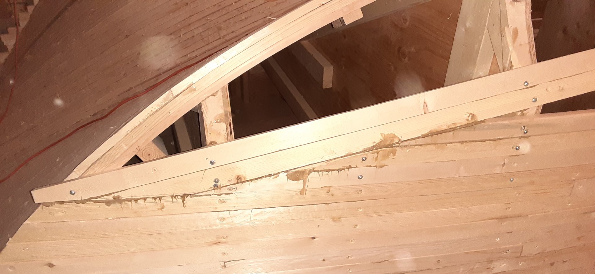

    Planking bulkheads. How will I make the intersections of chines, hull sides, and curves of the keels? I'll figure it out when I get there.
    I made a mistake lofting B1 and B2, but that didn't affect the tunnel, so I planked the tunnel. And then I spent a day with battens and a pencil and solved the problem. Sawzall to cut down B2, a little extra fillet material on B1.

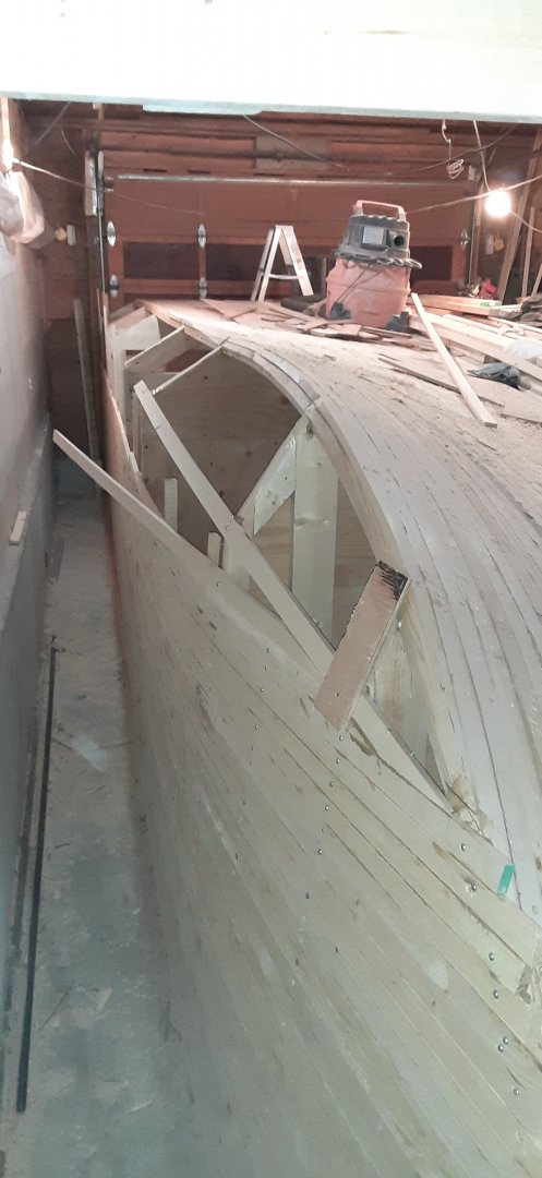

    Yesterday I planked up to the chine, and drank a coffee, while I figured it out. (Starbucks Grande Americano, black. If you put cream and sugar in it, its undrinkable when you come back to it 3 days later.) So I'm 5 planks past that problem.
    And you guys, my friends out in the world, figured out my next problem, just in time.
    This was my revelation: I just don't have time to figure it all out at the beginning. I have made a leap of faith. I'll learn each skill, when I need it. Find the answers when I get to the question.

    How many rolls do you reckon? I was thinking hull perimeter is 30', by 26' long. With 3 layers outside, and 2 inside, that's roughly 4000 square feet of glass, not including tabbing, built up layers at chines, and layers on bulkheads, transom etc. So with a 50" roll, allowing 2" for overlap, I make it 1200 square feet on a hundred yard roll. 4 rolls if its 50". 5 rolls if its 38". Unless I've made a math error, which happens.

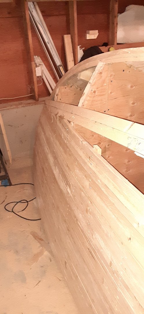

    Today's

    Are you having trouble at that chine or you gor a plan?
    You might want to build a beltsander mount so you can form the ends into each other easier. Otherwise, a small fixed sander works better, but they cost 150-200. Holding the sander works, too, but harder.

    No, no trouble. It takes me around 10 minutes to fit a plank. Sharp chisel, decades of experience.
    In answer to your previous question, no fiberglass experience at all.
