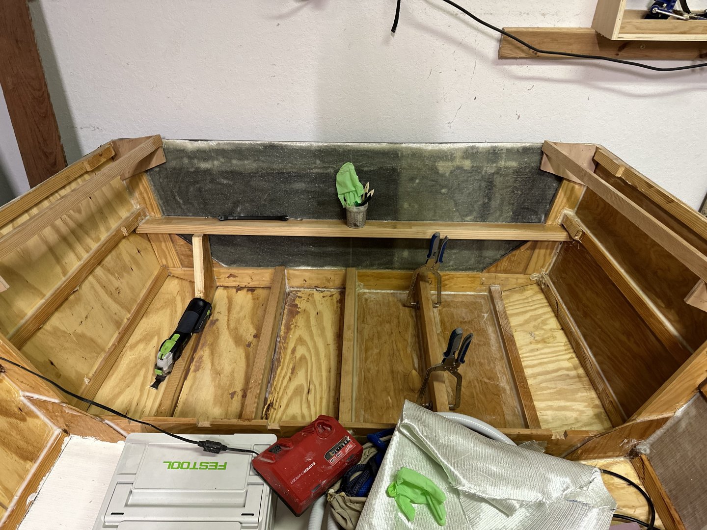

    69534566597__28A93621-AAE3-4CDA-A95B-B911725D3012.jpg 3E81F1F7-5AE1-4FE7-B242-BCC35FA45B48.jpg
    I figured that i might as well hop on your thread... I am building a 18' Hickman sea sled I started in June of 2022. I have most of the framing fully complete I'm just working on the planking and updating my drawings and weight study.
