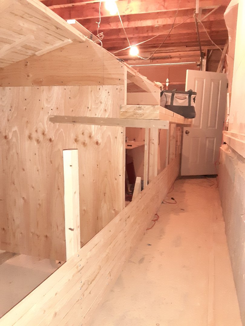

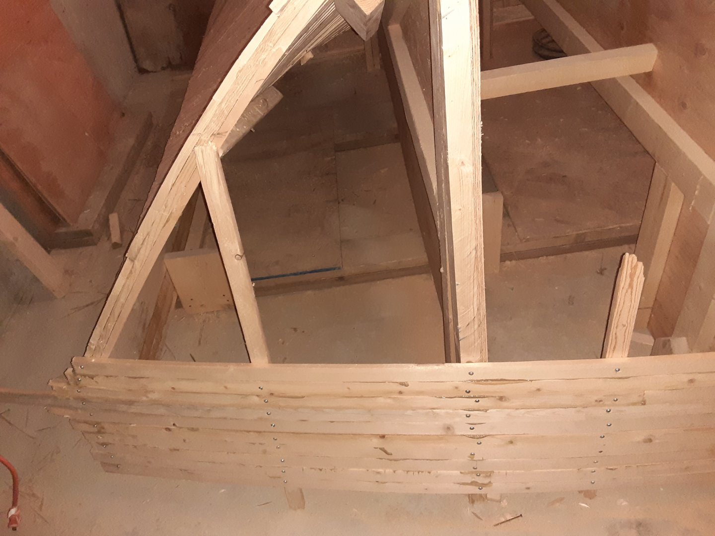

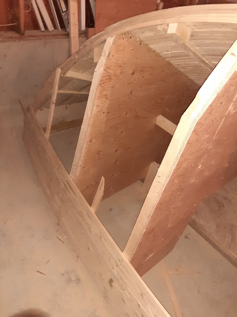

  3. DogCavalry
    Joined: Sep 2019
    Posts: 1,312
    Likes: 721, Points: 113
    Location: Vancouver bc
    DogCavalry I aim to misbehave.
    Planking the sides is a lot faster and easier. Number 2 shows just how crowded the shop is.

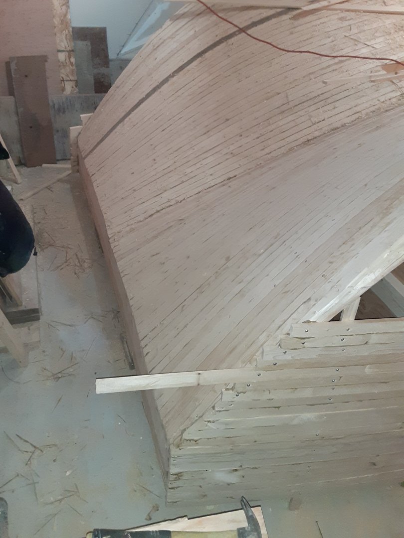

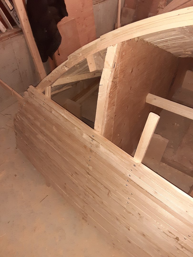

  10. DogCavalry
    Joined: Sep 2019
    Posts: 1,312
    20200322_200646.jpg 20200322_200713.jpg 15849331848159132871610998519886.jpg
    The day's work. Well, and rebuilding another skillsaw.
    My concern is that Gerr calls for ⅝ plus glass. My wood has dried down to ½ in places.

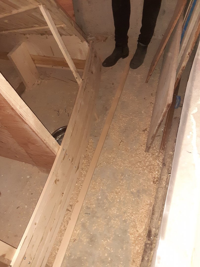

  13. DogCavalry
    Joined: Sep 2019
    Posts: 1,312
    Not much to report. Putting on planks, evenings and weekends. Like I have been for the last 2 months. Yawn. 20200328_192158.jpg 20200328_192057.jpg
