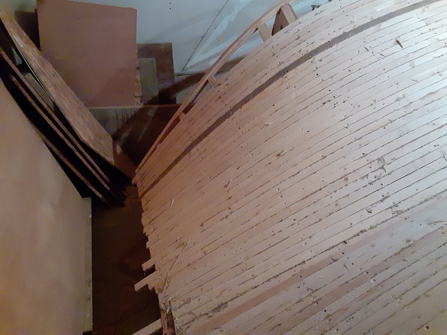

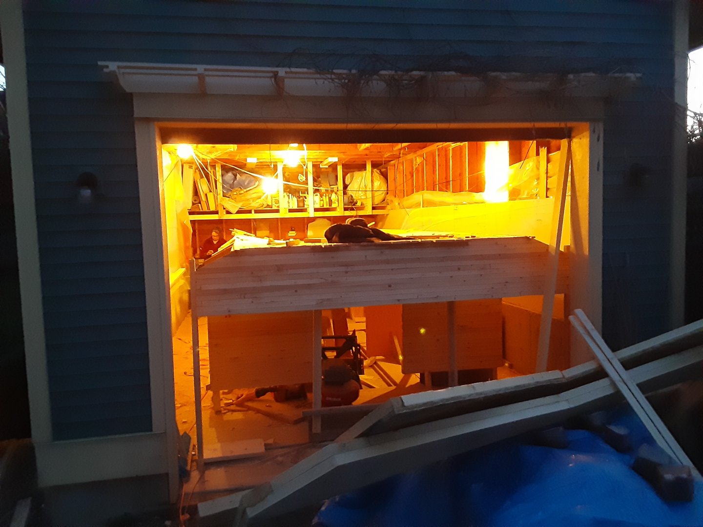

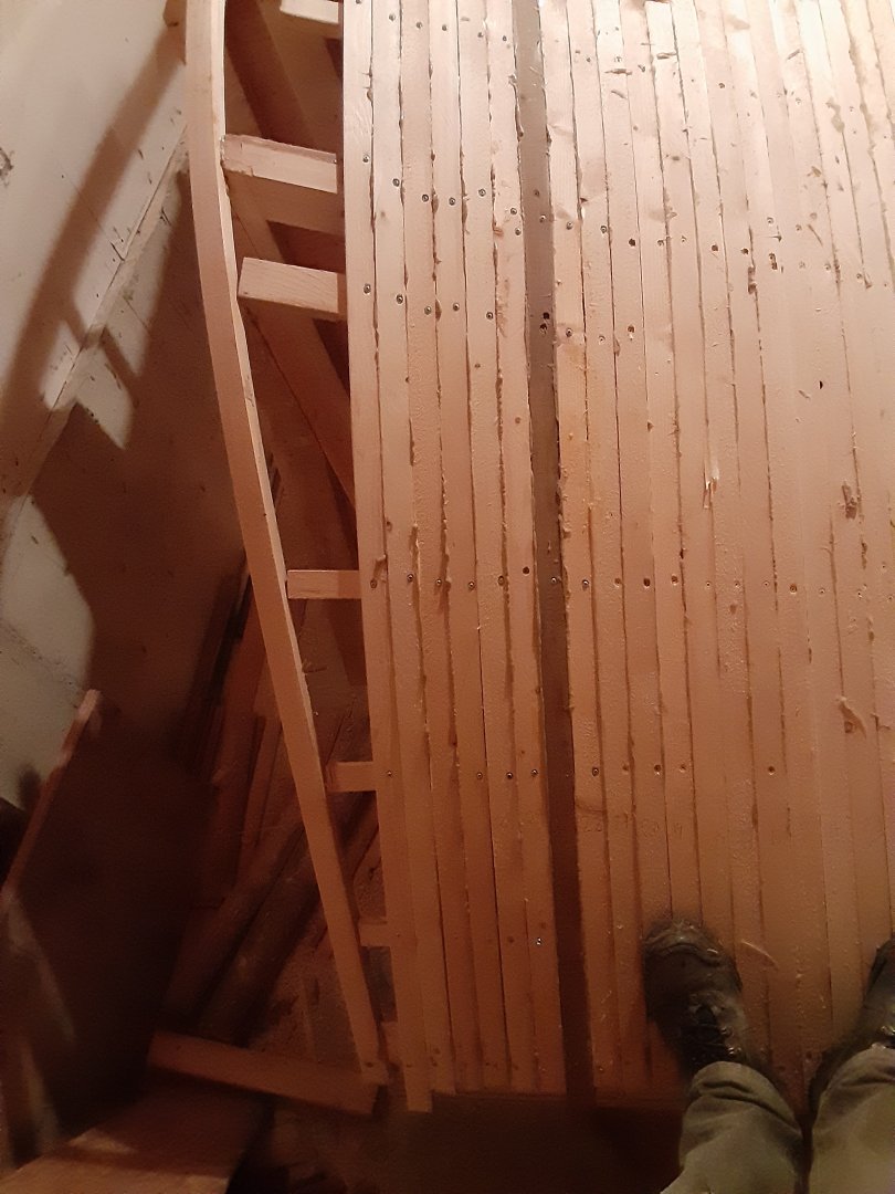

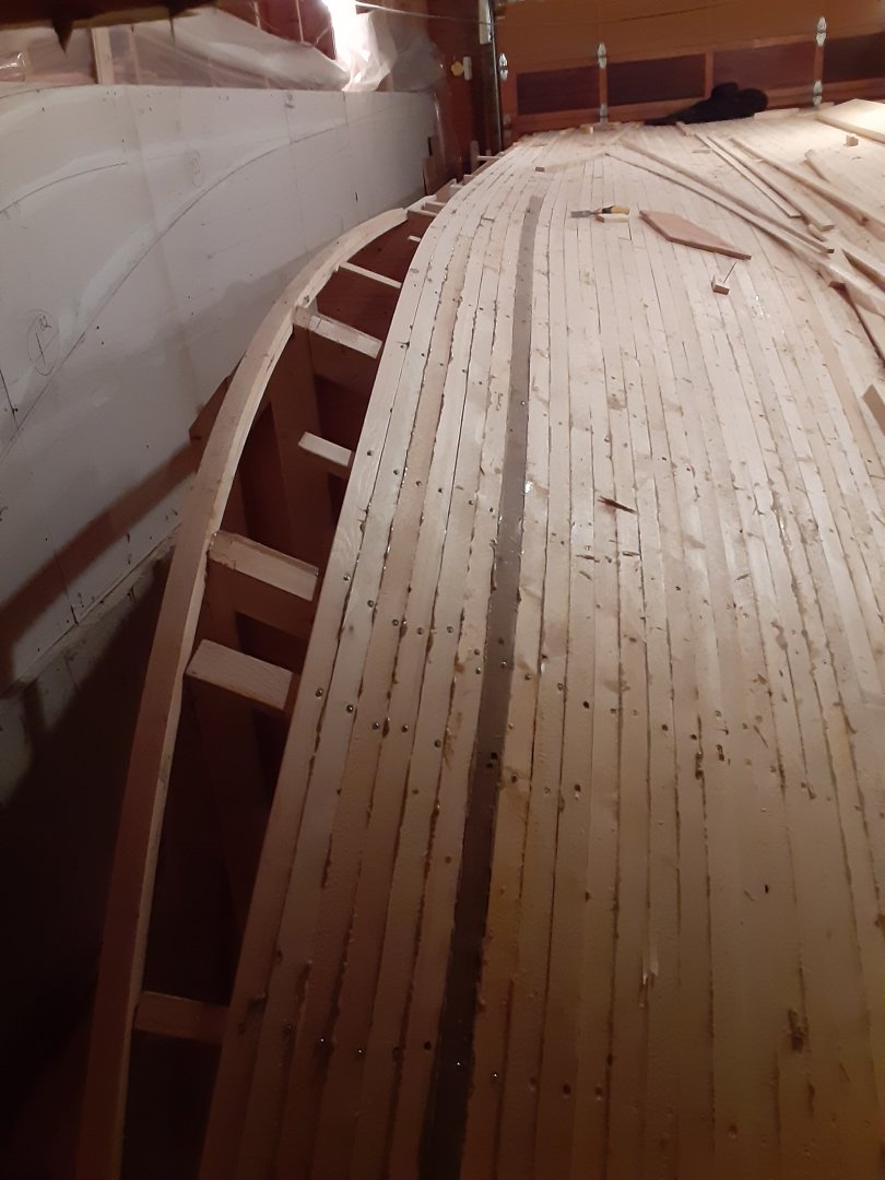

    So close to finishing the tunnel.

    +1 - she is looking very impressive.
    Will you now be using 'stealer' boards (is this the right name?) for the wedge shaped aperture that is remaining?
    DogCavalry likes this.

    No. The chine logs are solid enough I'll just run the planks off the edges and plane them back. Stealers was my first choice, so I could use liquid joinery at that chine, but I felt the changing stiffness would have made them hard to manage.

    Right. I see why the question. The chine logs are still square in section. Tomorrow evening I'll plane them down so the planking can run smoothly across them.

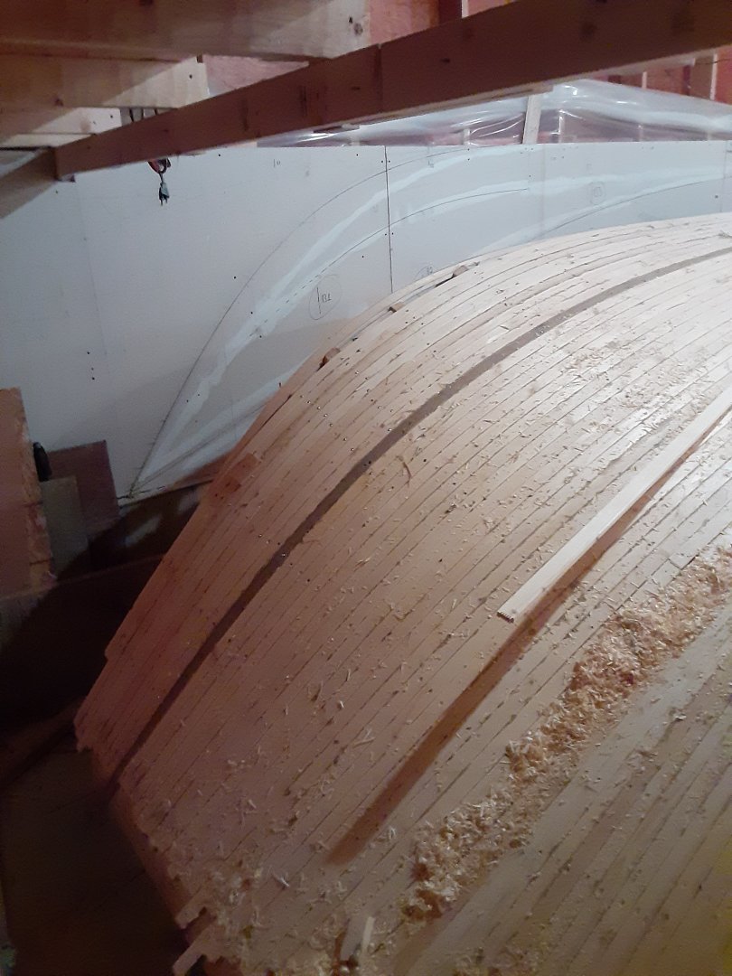

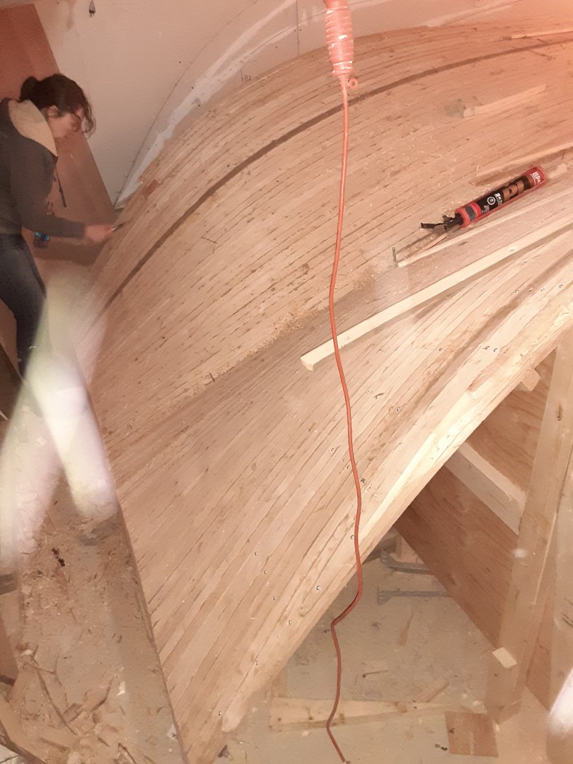

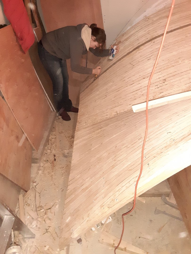

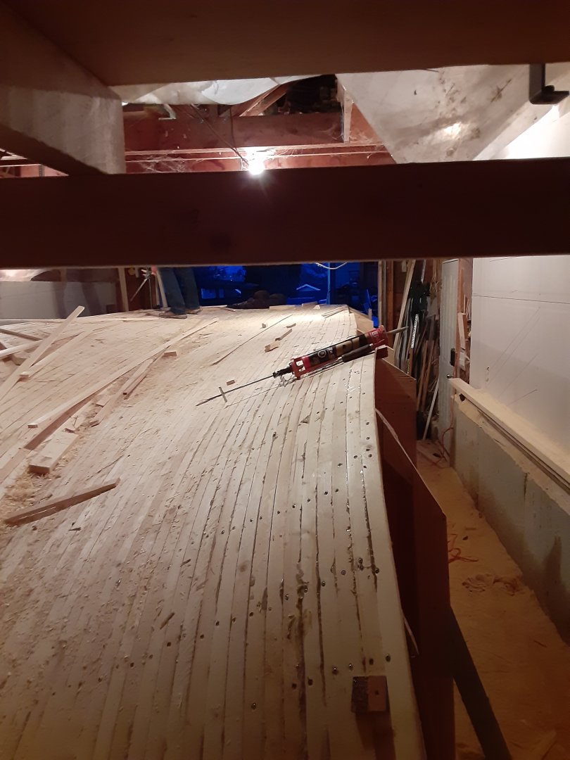

    Finished the tunnel. Chine logs a success: only 2 broken planks. 20200229_164100.jpg 20200229_181625.jpg 20200229_181629.jpg 20200229_181632.jpg 20200229_181646.jpg 20200229_181936.jpg 20200229_182019.jpg

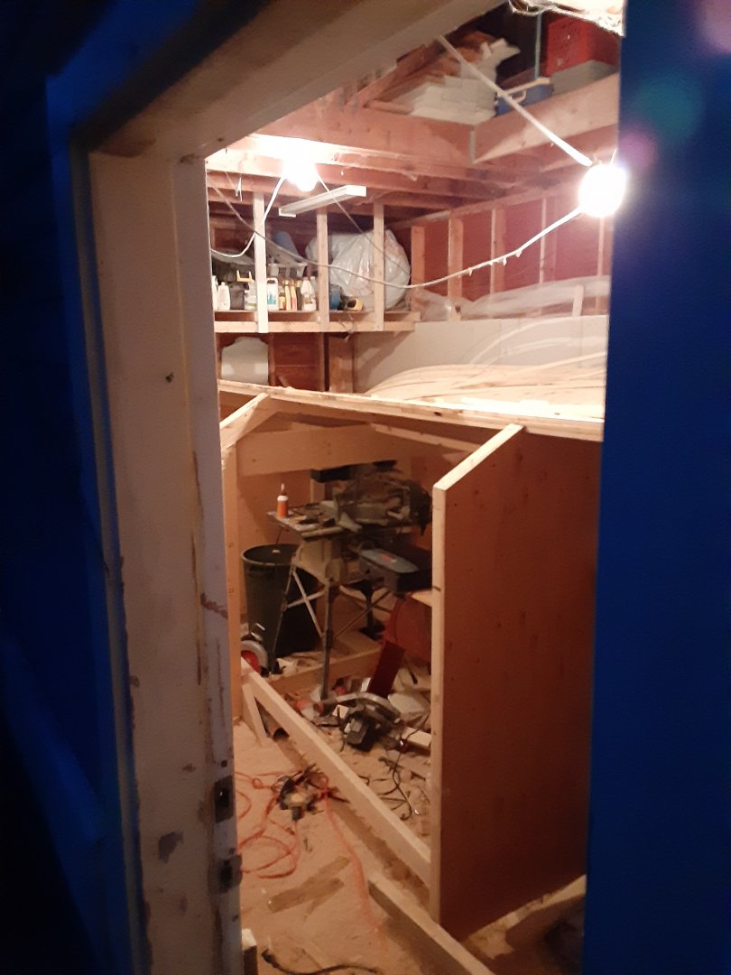

    20200229_181917.jpg This is a great shot. Really captures the shape of the boat, and how crowded the shop is.

    That is definitely a tight fit for sure!

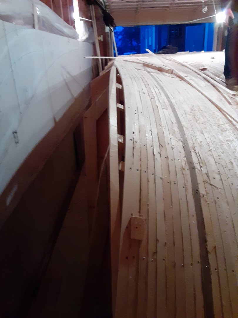

    Tunnel is done. Time to define the sheer line, then plank sides. I'm thinking end of March. 20200312_211421.jpg 20200312_211450.jpg 20200312_211501.jpg 20200312_211522.jpg
