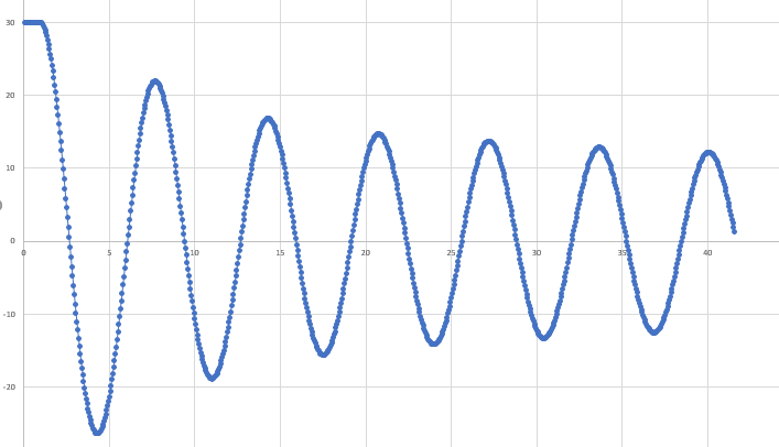

    Thank you Dolfiman for your super help, however I think I am a bit lost here due to the fact that I do not have the Bq coefficient. The only data that I have at the moment is the time dependent motion signal of the evolution of the roll amplitude.
    As far as I know the [​IMG] equation for example where B1 is the linear damping coeff B2 the quadratic DC and B3 is the cubic one, is solved using the P-Q diagram but then in the formulation where B1/c=PT0/2Pi^2, B2/c=3QT0/32Pi^2 and B3/c=RT0^3/6Pi^4. Where c is the restoring term of the vessel (in function of GM). My problem arises when I need to retrieve T0 (the natural rolling period)...because it is again another approximation and I would prefer not to use it.
    So making the long story short I would like from the signal retrieved (see attached graph) to calculate the damping factor to use for my strip theory calculation. A standard value I was give long ago for a 43 mt vessel with BK and @T=3mt and BOA=10 mt is 0.076.
    I apologize if I may have misunderstood any of your explanation so far.
    My peaks are [deg]:
    MAX
    X0 30.00
    X1 21.92 @7.7 sec
    X2 16.82 @ 14.25 sec
    X3 14.67 @ 20.75 sec
    X4 13.72 @ 27.2 sec
    X5 12.86 @ 33.65 sec
    X6 12.18 40.05 sec
    min
    X-1 -26.35 @ 4.3 sec
    X-2 -18.84 @ 11 sec
    X-3 -15.59 @ 17.55 sec
    X-4 -14.15 @ 24 sec
    X-5 -13.29 @ 30.4 sec
    X-6 -12.56 @ 36.85 sec
    Thank you again!

    I think you have your answers in this document : "Dynamic of Marine Vehicles" by R. Bhattacharya, chapter 10.3 Non linear damping
    (pages 214-215) dealing with a rolling motion with a damping type : b1 phi + b2 phi abs(phi), where b1 and b2 can be evaluated from a declining angle curve (of which method is itself described page 80). So then, if you want to deal with full linear equation, I think you have just to replace b2 by the equivalent b1 as described above.

    With regard to obtaining the damping factor, can't you use a least-squares estimator? You can set this up easily in Excel. Calculate the response for the points in your graph using an assumed value for the damping. Take the differences between the calculated response and the graph and square them, then sum those to get the total squared error. Use Excel's Solver add-in to vary the value of the damping factor so as to minimize the sum of the errors. You can also estimate other parameters at the same time. FWIW, I think you'll find you get better estimates by using many points in the first period or two, than using the same number of points spread out over many periods.

    30 degrees roll? Your GZ curve will be non linear.
    At your smaller angles (the last few oscillations) it is starting to stabilise...
