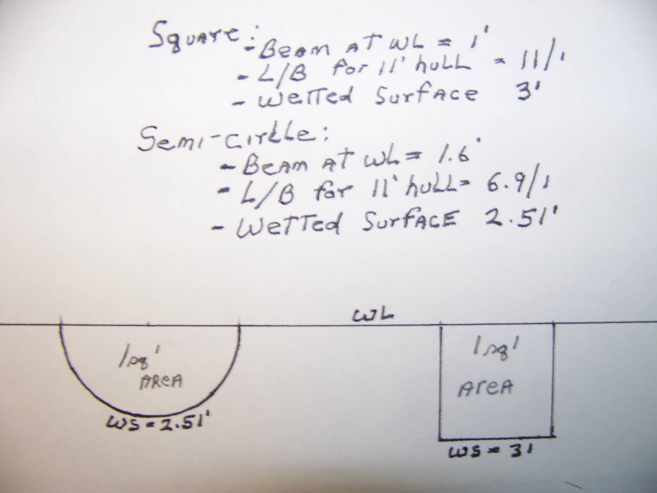

    Slavi, in the early Moths a lot of different hulls were tried-the one that worked best was squarish instead of the lower wetted surface semi-circular shape because the L/B ratio of the square shape was higher-in other words the waterline beam was narrower. The narrower waterline beam reduced wave making drag and trumped the higher wetted surface.....
    A rough, but accurate sketch from years ago. The Moth hulls were pointed bows of a conventional type:

    I am not sure it works the same in this case, Doug.
    This is not a high-slenderness ratio hull. This looks like a displacement-speed boat, where the wave drag has pretty much the same importance as the viscous drag.
    Hence, a decrease in one drag component implies an increase of other drag forms. Hence, I don't see a clear advantage of this hull form in terms of drag, at least in the displacement speed range.

    I don't know, Slavi-I can't find dimensions to check the actual L/B but it looks to me to be near to or narrower than a Moth hull. The problem,if any, is the bow in any waves-at least to some extent. I think it is very likely that the L/B ratio will offset the greater wetted surface, as far as speed goes, depending on how much negative effect the bow has(if any).

    LWL = 4.2 m (from the 4th pic.)
    Displ. = 650-680 kg = 0.634 cu.m (an estimate based on smaller models), hence D=0.317 cu.m per each hull.
    hence:
    Slenderness ratio SR = LWL/D^1/3 = 6.1 (approxim.)
    With these data I estimate a B of 0.55-0.60 m.
    Not a particularly high SR value, but one cannot make miracles on such a small boat.
    However, it is an SR ratio where residual drag makes some 30-40% of the total resistance at max. speed, hence wave drag is still the dominant one.
    Hence, your note might be correct, though the improvement in resistance with this hull form is IMO barely noticeable.
    I still believe that the principal reason behind this hull form is the recovery of the internal volume, which is precious on such small boats - especially if it has go provide berthing for the crew.
