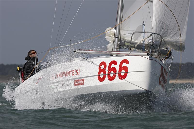

    I've been looking at trailer sailer trimarans recently, and was thinking that they look great except that they really have almost no space. So I was thinking it might be interesting to do a scow bow trimaran to maximize interior space, while keeping overall length within trailerable limits. I read (skimming, except for the last couple pages, which I actually read) this thread:
    Round full blunt bow on a cruising catamaran https://www.boatdesign.net/threads/round-full-blunt-bow-on-a-cruising-catamaran.57120/page-4
    Seems like you could get away with a relatively "blunt" bow (e.g. something looking more like the nose of an airliner) to get enough interior volume to manage something seaworthy that you wouldn't mind spending a few weeks living on as opposed to something that is pretty much only good for an afternoon (or maybe one night).
    The impetus is that I've been looking at stuff to putter around the Bahamas. I like multihulls for the stability under way (not as much heel for the missus and kiddos) and at rest, but also for the shallow draft.

    Yeah, think F-27 except with a center hull shaped more like this:
    Again, the idea being to get as much interior volume for a given length as possible.

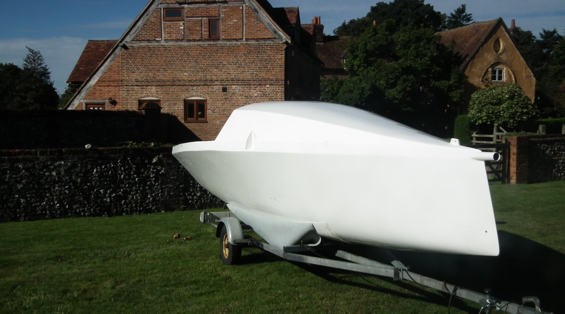

    Bit like this then,

    When you bloat the main hull it destroys some of the reasons for a trimaran.
    Have you looked at a Horstman? Older, it defined the term roomeran.

    I think "destroys" is too strong a term. There's certainly a diminishing returns thing happening. But where and how this transition happens seems poorly understood to me. That the scow-bow has been as successful in the mini-transat as it has been in the comparatively well documented land of monohulls suggests to me that it's understood even less in the comparatively poorly understood domain of multis. In any case, your return on investment for weight in building amas versus ballast

    I bet that can work very well, as the main hull fate is to be flush with the water surface,it is in coherence with a scow bow. Another potential advantage, a lot less spray from this bow. Upwind, the slamming issue should be less important than for a beamy monohull sailing nose-down with a scow bow.
