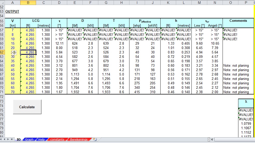

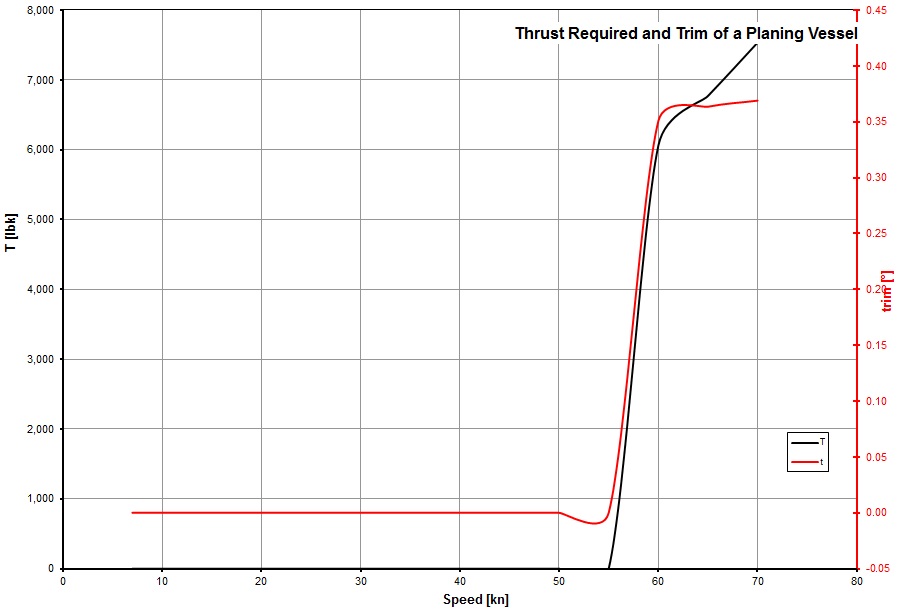

    Hi Dingo and folks,
    Firstly, thank you to Dingo for sharing your amazing work.
    I have tried to calculate the speed a planing craft by using your tool but I think it didn't work well since '#VALUE' appeared on the row of 7 - 55 kn. Hence the graphics starts from above 55 kn (please find the attached file). The excel worked fine with your default parameters.
    Did I miss something important? I am curious to find out my mistake.
    The parameters of my planing craft are:
    Lwl: 10.33 feet / 3.149 m
    Beam: 4.79 feet / 1.46 m
    VCG: 2.40 feet / 0.73 m
    Displ: 2,315 lbf / 1050 kg
    Deadrise at transom: 24 degree
    Deadrise at midship: 26 degree
    Angle of thrust line: 0 degree (since I would like to use outboard engine that the shaft is 5 cm below the keel)
    f: 2.59 feet / 0.79 m
    LOA: 13.78 feet / 4.2 m
    Bmax: 6.23 feet / 1.9 m
    Z: 2.46 feet / 0.75 m
    Hss & Bss are 0 since I don't have superstructure.
    N:1
    I wouldn't utilise trim tab. But I read previous post that using outboard engine should set shaft and strut to zero while setting small number for rudder. Hence the rudder parameters are:
    c: 1.84 feet / 0.56 m
    t: 0.59 feet / 0.181 m
    A rudder: 3.21 feet^2 / 0.298 m^2
    Xc: -0.05 feet / -0.014 m
    Yc: -0.87 feet / -0.266 m
    Thank you
    Kind regards,
    Raden

    Your displacement is what ?
  5. Radenpm9
    Joined: Jun 2015
    Posts: 26
    Location: UNITED KINGDOM and Indonesia
    Radenpm9 Junior Member
    The displacement is not 2.315 lbf , it should be 2,315 lbf or 1050 kg. Thank you for pointing out, I'll correct it soon

    Sounds way high to me, 2315 lbs.

    I second Mr Efficiency's opinion, the displacement seems rather high for a planing craft of this size.
    But something else comes to my mind: Where is your lcg? I cannot find anything about this in your particulars. Did you leave it at a default value that is much larger than the overall length of your boat (I have a copy of Dingo's spreadsheet that I believe still contains the "original" data, with lcg = 29 ft)? If yes, this would explain why the calculation did not work.

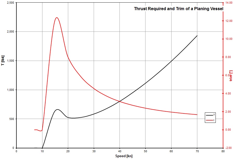

    Okay I missed that point, thank you for noticing it :D
    the LCG has been set at 4.265 feet / 1.3 meters
    However, I still haven't clue about the '#VALUE' for 7,8 and knots of speed. So the graph is still untypical, I believe. (please check the attachments)

    Remember that the Savitsky method is all about finding an equilibrium for all forces and moments. With a boat with such a high bottom loading I reckon there is no solution for the slow speeds, as the required trim angle for the necessary lift would be too large (i.e. > 15 deg as indicated in the spreadsheet).
