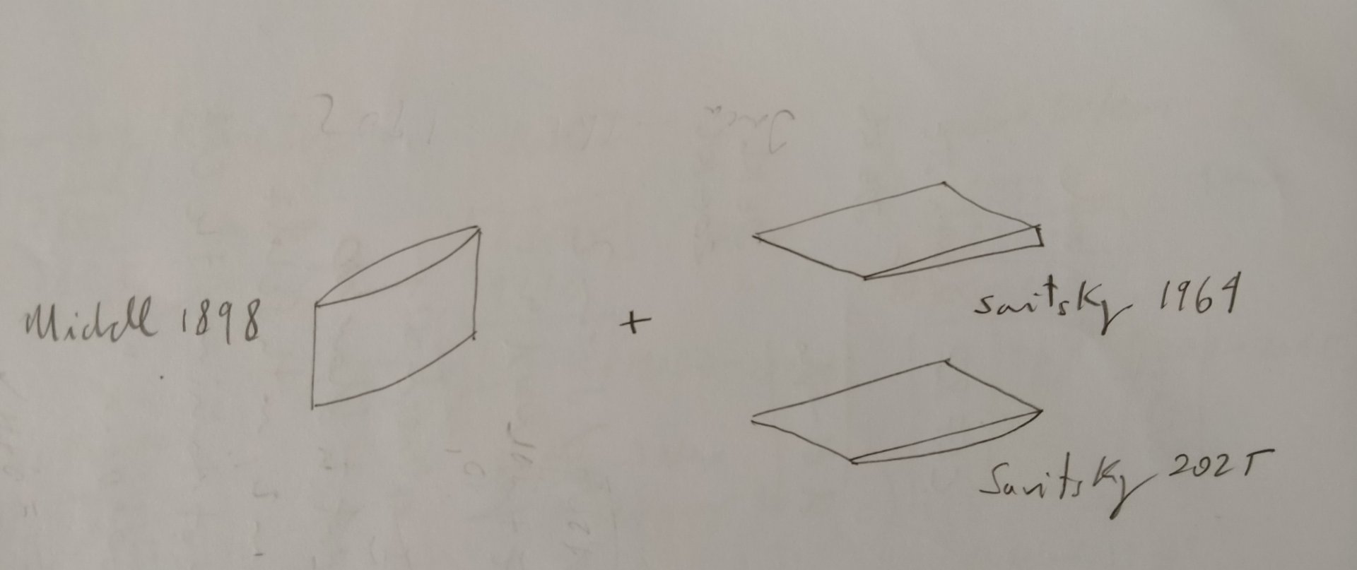

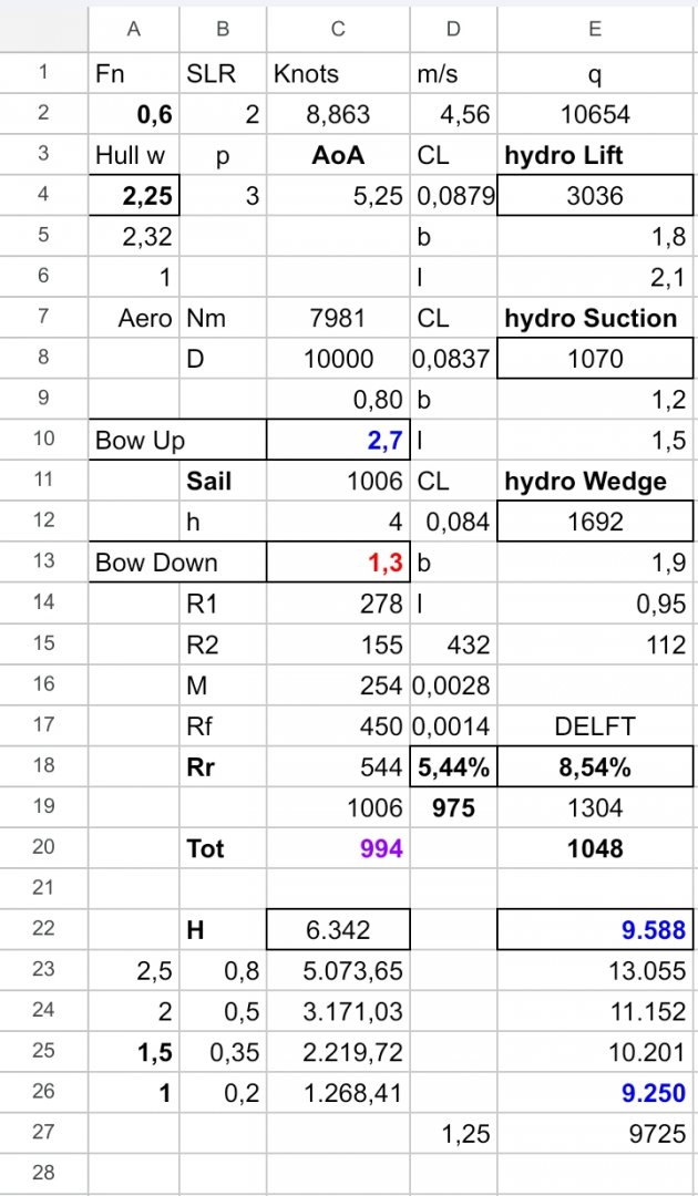

(A) Up to 0.45 Froude we have Delft and "the main part of Michell"
https://www.mdpi.com/2077-1312/8/6/400
(B) From 0.45 to 0.75 we have this Savitsky-2 (1973) to have bifocal vision with other estimates, and beyond that
(C) the classic Savitsky-1 (1964)
Problem solved, And everything fits together by adapting Savitsky to the profile of a sailboat hull, an adaptation I call Savitsky 2025
With bifocal vision from two points of view... the suspicion of being trapped in a tunnel is dispelled, and the beautiful sensation of feeling reality emerges; how wonderful scientific knowledge is!
1 Ton WindSurf Board Plywood Epoxy, Total R @ 0.60 Froude
- Delft: 1304 Newtons
- the clue that Dolfiman gave us: 0.7 Delft: 1048 Newtons
- my model: 994 Newtons
- Savitsky 1973: 975 Newtons

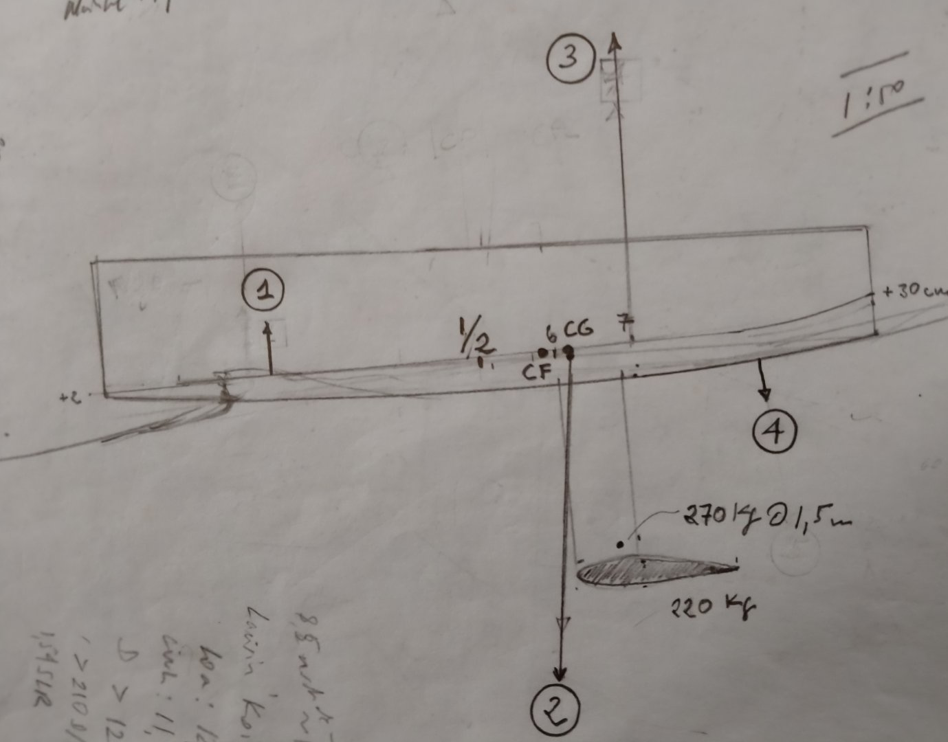

The effect of raising the bow out of the water combined with a gigantic wide stern is spectacular.

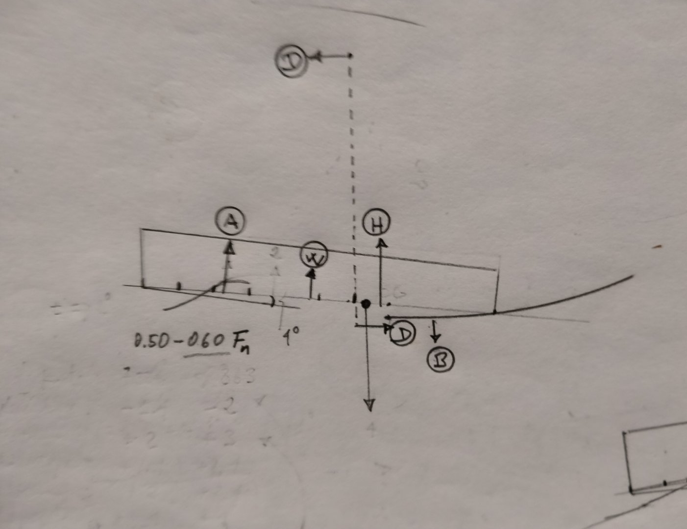

i) By raising the bow out of the water, drag (Froude => 0.60) is greatly reduced.
ii) The wide stern also reduces drag
iii) The wide stern eliminates the destabilizing low lateral pressures at the stern, which, combined with a bow out of the water, means we can send Mr. Max Michael Munk to a peaceful nap, much to the delight of the autopilot.
iv) The large, wide, and difficult-to-sink stern interacts hydrostatically with the angle of attack, controlling it like the flaps or interceptors on a motorboat.

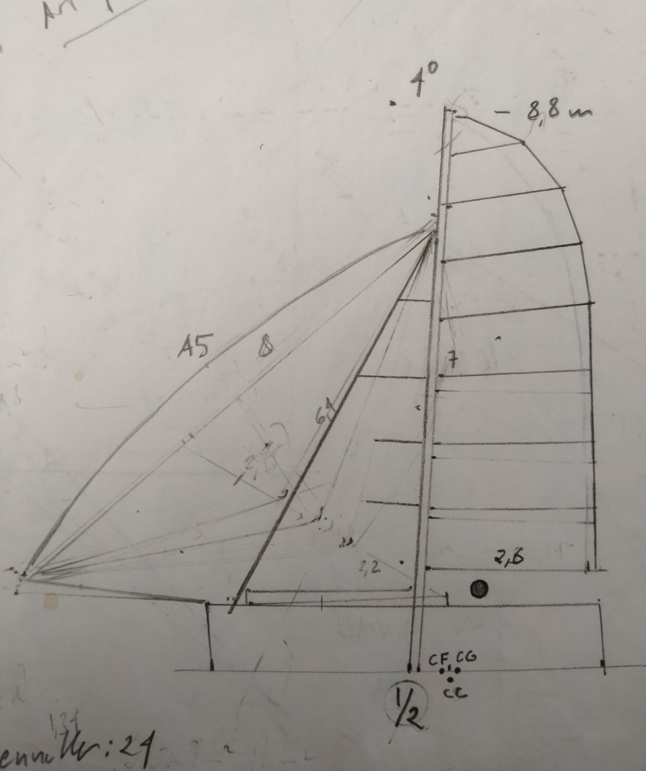

The enormous difference that is often forgotten between a motorboat and a Surf-glider is that the propeller raises the bow, while the sails, with their enormous leverage, sink the bow.
And the major difference in the hull design of a 1-3 ton sport sailboat and a dinghy is that the dinghy sails upwind at 0.40 Froude instead of 0.35 Froude And ... And that Downwind the crew can trim the hull, in a 1-3 ton sport sailboat the hull trim must be hydro-Dynamic
+ A deep cockpit offers safety, comfort, and functional pleasure. Furthermore, the ballast tanks are located below, above the chine, and drain through simple plugs in the cockpit floor
+ The mast is 40 cm from the cockpit
Climbing on deck is strictly forbidden; it's madness on a small light sport sailboat.
+ And since there are no cables or stainless steel on deck, the bowsprit rotates aft to launch and retrieve a beautiful small A5 gennaker
Of course, the sailor has to get off his confortable seat. A cruelty by the designer.
And the magic carpet sails away on the Wave, Surf-gliding at the speed of the Wave: 12-14-16-18-20 knots

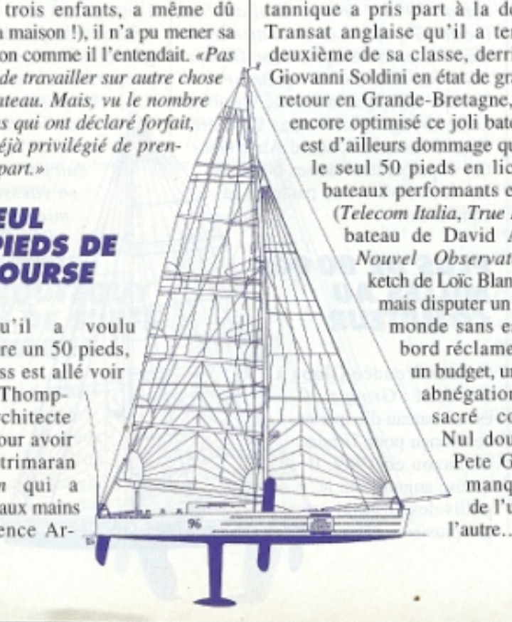

JPK 1050 - IRC racing machine https://www.jpk.fr/en/gamme/jpk-1050/
"Carène scow, déplacement très léger et grande surface de voile"
(maybe 300 K Euros)
Note how we now have to cite the now ubiquitous "scow" that is: wider bows

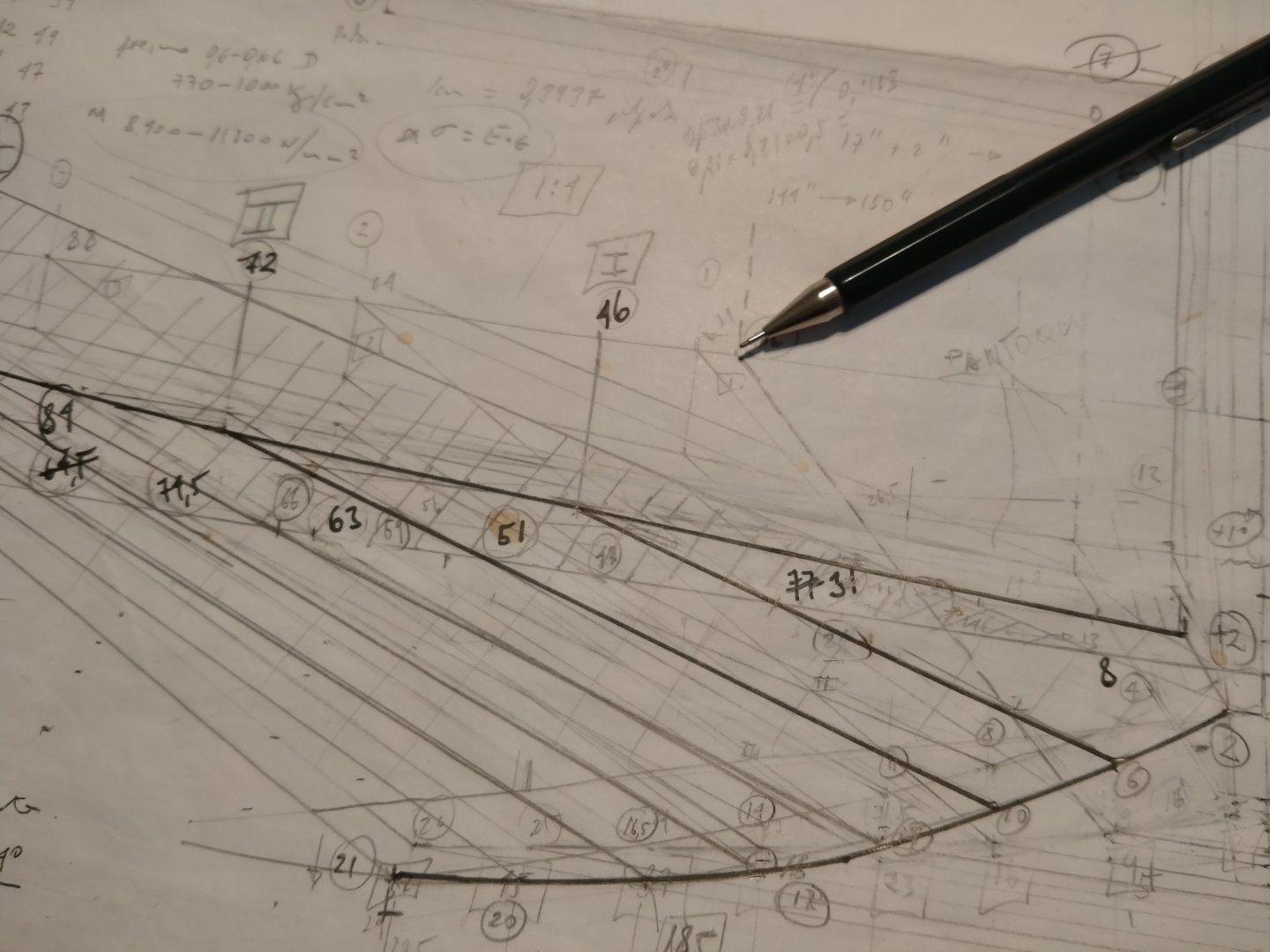

The pencil marks the first chine position in S1.
A lower chine and a wider nose allow for the construction of a larger, more efficient wing.
To quickly get the bow out of the water in a fast transition in the 0.50-0.60 Froude zone
And
And a high chine at the stern and very very low chine at the bow, along with the reconciled longitudinal positions of the fundamental centers (CF, CB, CG), allows us a semi-classical longitudinal balance, and ...
even that when heeling, the center of Flotation moves forward as if was designed by Herreshoff

JPK 1050
A fully equipped one might cost perhaps around 400,000 Euros
Let's suppose the genie in the lamp gave me that 400,000 Euros sailboat, question: - would i enjoy hoisting a gigantic A3 gennaker all by myself?
Nah, 3-3.5 ton sports boats are for two-person racing.
And the scientific thing is 1 sailboat, 1 man.

3.5-ton 300K sports sailboat (the first estimate was better) with a gigantic 120-square-meter gennaker, and we assume a Displacement of 3.75 tons = 43 square meters per ton
0.85-ton 60-70K sports sailboat with a small 24-square-meter A5 gennaker on a swiveling bowsprit, and we assume a displacement of 0.95 tons = 47 square meters per ton
I mean, the Savitsky-64-73-25 Surfboard can carry food and drink for 90 days for 1
For example, for a 20-day Atlantic crossing east to west
+ 850 kg (= 375 Hull + 270 keel + 200 kg)
+ 100 kg, 1 man and things
+ 75 kg, food for 90 d
+ 90 l, fluids
= 1.115 tons
40 sqm per ton

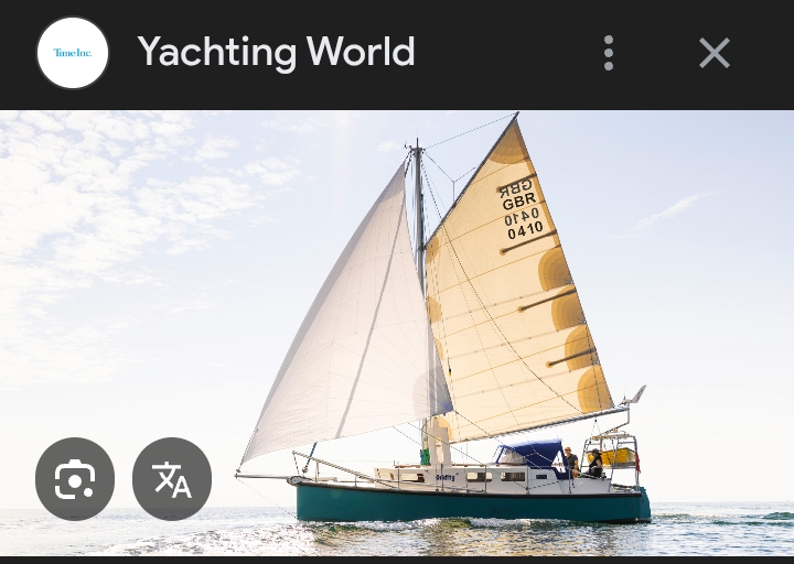

Pete Goss new/last boat
Pete Goss: a new mini-exploration yacht that’s a bit different - Yachting World https://www.yachtingworld.com/cruising/pete-goss-a-new-mini-exploration-yacht-thats-a-bit-different-143376
