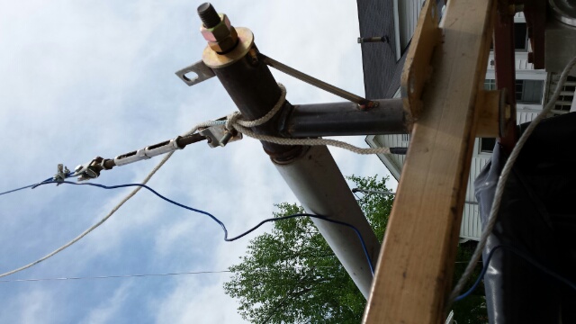

sail rigging points. With cabin in the way.
The old bolt rope track for the sol cat trampoline. And a wisker pole reused from a Hobe cat tramp frame. These are proto types until I take it to the lake again for some trials.
The wisker pole will be attached to the mid ship steel rib. It will be to swing 270 degrees and lift up over the cabin. Kind of a snatch block rigging solution.

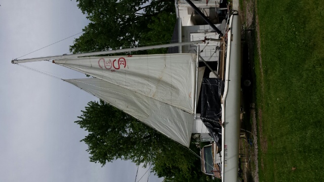

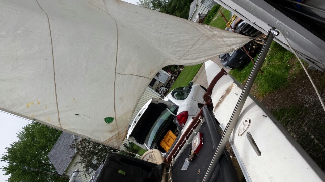

lawn sailing
Sail configurations are endless. The spirit pole on the bow is about 3 feet long. As I go it gets complicated. As the jib stay length is adjustable. Once the back stay is set at the hounds the jib stay tension is set with the worm gear winch that raises the mast.
The middle stay sail has a bolt rope foot that is attached to the boom. It will auto tack. And be infinitely reefable. Tacking with a sail on the bow stay. Will be slow as the foot is 14' and 10 '. I Will be able to full furl the middle stay sail on the boom. Take the stay off. And use the boom as the jib Sail clew anchor. Then also be in auto tack mode. With a 10' footed jib sail.
The Genoa is 26 'X 14' and the cabin is in the way. It will only be used in flat water.

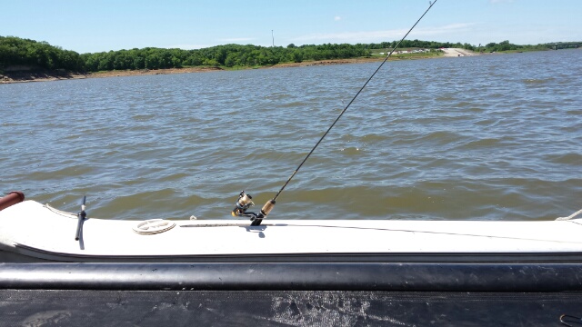

Lake trials 2
Went out memorial day. 18 mph wind with 30 mph gusts. Flew the small main sail only. The single Lee board worked very well at keeping a slight weather helm. Still need some rigging anchors for it. Top speed was 6 mph. Up wind was slow as the beating waves can really slow it down. Hiking out on the down wind Ama , back ward I know. Is enough to almost fly a hull. The bow am as are too high for pitch poling.
I am almost certain that a head sail would have brought her up to planing speed. I did not want to risk my 30 year old Hobie cat mast this early in the summer. I'll let it bend 4 inches. Above the hounds.
The sail boom worked well although the reefing mechanism needs a spacer as is binds up in high winds.
It took less than an hour to set up and launch. By my self

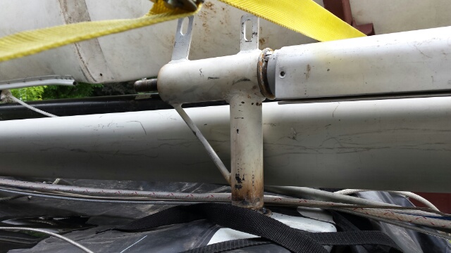

reworking boom pivot mount.
The first one had the base break off. (Bolt snaped) from not being seated. It wobbled when the sail was eased. When reeling in a fish.
The rebuild has a bolt that serves as a cotter key.

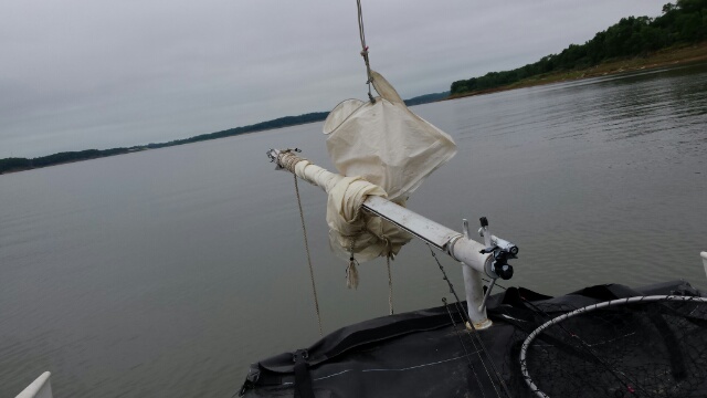

Lake trials 3 wind 5mph. 2 mph
The boat weight is 1500 pounds fully loaded.
I used my medium Genoa and the boom. The sail was giving me too much Lee helm until I pivoted the Lee board forward. Then pulled the whole sail back a couple of feet. Actually can tack forward like a boat is suppose to. Verse a leeward 270 degree U turn. Top speed was 2.3 mph. Fished about 8 miles and caught 18 fish.
The first picture is the Genoa pulled back to balance the helm. The second was a quick rolling of the sail around the boom when motoring to the boat ramp.
