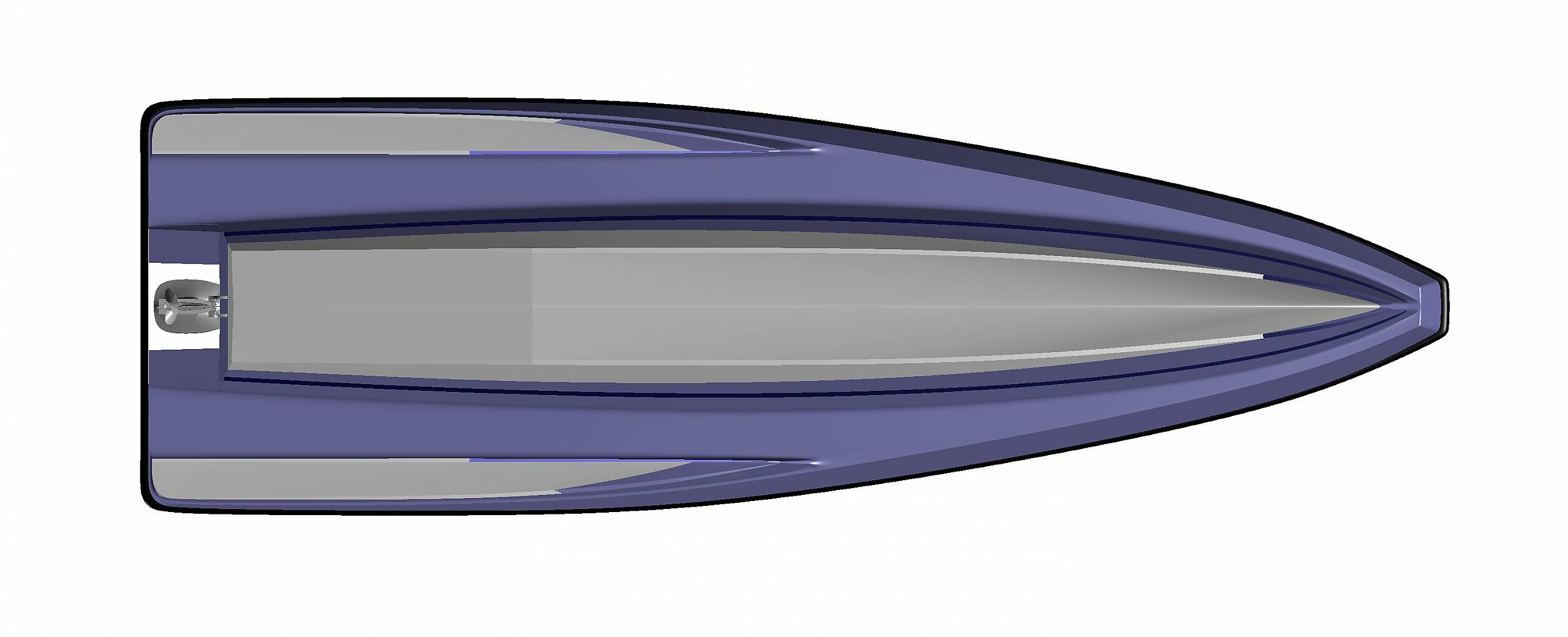

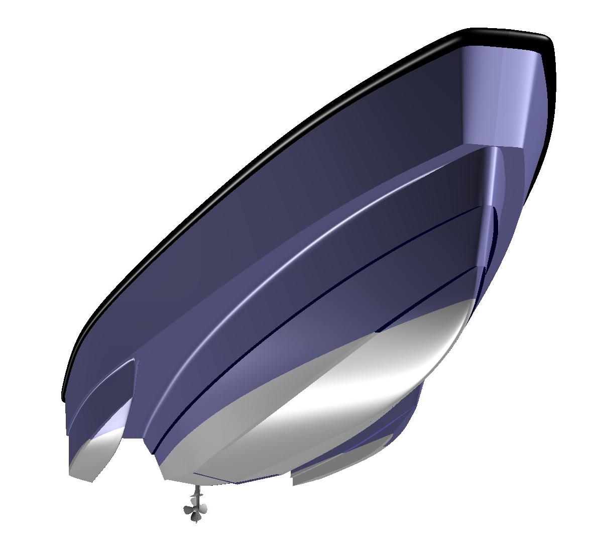

    The greater width means also that the power catamaran get too great stability, which makes it very inconvenient in a seaway. This leads guaranteed to seasick for most. :mad:
    That's why they do not run passenger catamarans on some exposed routes. This applies mainly cats mowing in so-called displacement speed or semi-planing speed.
    Therefore it is better to choose a trimaran.;)
    js
  14. Ad Hoc
    Joined: Oct 2008
    Posts: 7,987
    Likes: 1,860, Points: 113, Legacy Rep: 2488
    Location: Japan
    Ad Hoc Naval Architect
    The picture of the trimaran that you posted, is actually a whole lot worse.
    The aft WPA is very large as such any stern or stern quartering seas shall pick up the stern and with little to no buoyancy and WPA up fwd, it shall either nose dive or broach.
    If you are that obsessed with a trimaran, then you need stabilised monohull, not a trimaran. Your picture is nothing like such a vessel. An example of one is here.
    I think you need to understand the effects of buoyancy, WPA and added mass on natural periods of motion before making such wild claims.
