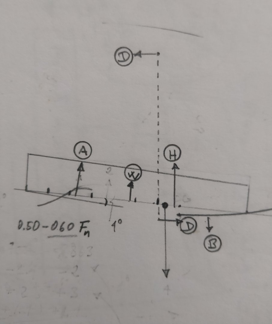

    Your issue is the shape of the duck tail (the extension)...the water flow is inconsistent with the speed. in relation to the hull, simply.
    You need a vertical transom and no rocker/hook.
    As noted HERE and HERE.

    "Eliminating drag" is more accurate. Thank you all for the quick response and disection!
    A stepped hull was considered as was a straight extension. But I'll add rest of the story here...I gained my of target of 1200 lbs. buoyancy aft and it actually trims nicely with 800 lb jetski and water tanks full. CB and CG righ where I want them.
    But in order to turn and maneuver well with current prop/rudder position I need the tapered shape inward and upward to surface allowing clean flow under stern as the vessel gets longer. Those features are a huge success. The drag underway is not...but I'll overcome this with a workaround.
    Thank you Ad Hoc for quantifiing the resulting forces from this shape. I understand why the fine shaped double enders achive wave speed so easily...the drag is mostly on the deep, rounded sides...as the water comes back together astern the force is horizontaly outward on hull instead of pulling the vessel downward. A clean, natural apex having achieved a near pefect wave form...evolved like a duck has over millennia.
