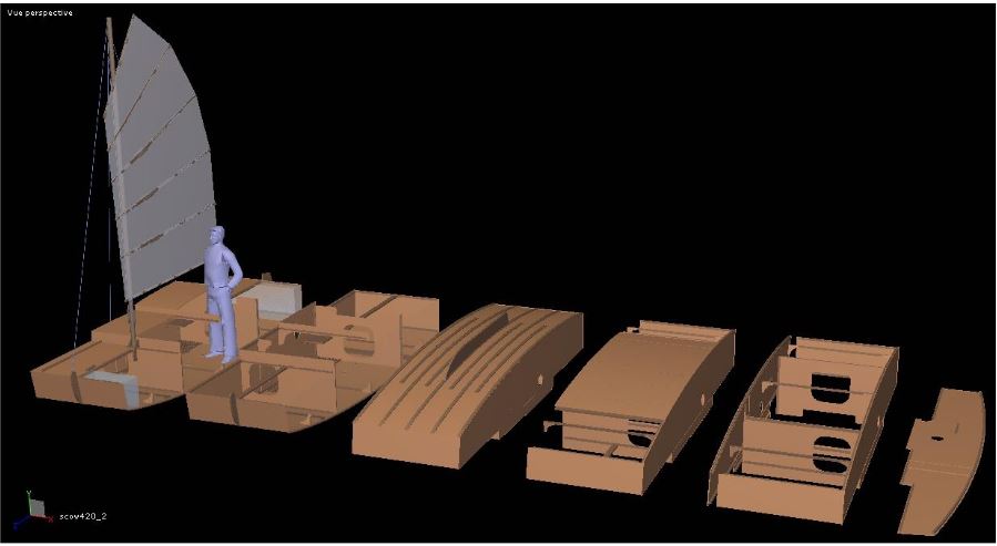

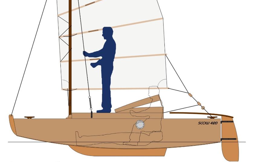

    I found a set of free plans on the internet for a 14ft x 4ft "box" called a scow 420. I'm thinking that I would like to scale it up to 16 X 4 to get a little more stability and room for sailing protected bays. The idea is to use this primarily as a 2 person dive boat and thinking that the flat front (kind of a plumb bow) may be a great place to hang a ladder and store dive gear.
    The keel runs about half the length of the bottom and the mast looks to be quite close to the front. What I'm hoping that the scale-up may be a simple matter of just lengthening the keel and moving the mast proportionally.
    Since the mast in the plans looks to be approximately 3 ft from the bow, this would move it back to about 41 inches for the 16ft scale-up (The numbers I'm kicking out here are just approximate from eyeballing the pictures).
    i.e. 36 * (16/14) = 41.14
    Will a simple scale-up like this work or am I oversimplifying it to much?

    If you scale up from 14' x 4' to 16' x 4' you will get more longitudinal stability, and in theory you might get a bit more transverse stability (depending on how full the hull is), but I wouldn't count on it - you are effectively making the boat even more skinny (and she is already quite skinny, at only 4' wide for 14' long).

    I think so, that you oversimplify things. The total weight and the distribution of weights, and therefore its center of gravity, will change, the position of the center of thrust will also change, as will the center of gravity of the drift area. Greater weight will require a greater sail area ....., that is, it would be convenient to study the thing in a little more detail. And I agree with @bajansailor in that the boat does not seem the most suitable for diving.

    Mast placement will depend on where the sail's center of effort is, and where the boat's center of lateral resistance is.
    I'm not thrilled by those plans; it should have leeboards instead of that keel, and a kickup rudder. Also, it's a waste of plywood to deck the whole thing for your purposes, but I think they did that to save on internal supports.
