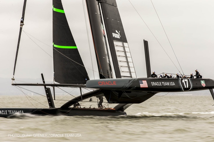

    There has been some recent discussion of cutting back the sail at the deck. It was popular in the C class in the 1970s, especially when aerodynamic engineers were involved. Patient Lady I was the most extreme, but Scimitar had a similar sail platform. I think the issues were sealing the sail to the deck, getting the area higher into stronger wind, and creating a space for the crew to cross when tacking.
    Why isn't this seen more, especially with wings and single sail rigs?

    It depends on how much lift carry-over you can achieve between the wing/sail and deck/hull. If you could get 100% of the lift to go down to the water, then you'd want a planform like a half-ellipse to get the least drag for the height of the rig. But that's not possible because the wind drops off at the surface, so the lift is going to decrease there even if the rig goes to the water.
    The technical answer is the rig produces lift by deflecting the wind to windward, and you want the deflected velocity in the wake to be uniform along the span for minimum drag and taper linearly from foot to head to get minimum drag for a given heeling moment. You want the combination of planform, twist and camber to get this result.
    The near-triangular shape of a conventional sail rig deflects the air more at the foot, and this results in a self-created header that reduces the lift at the foot compared to what you'd expect if the lift was proportional to the planform shape. So the lift per unit area is less at the foot than elsewhere in the rig. If you have an area limited class like the C class, this is bad news. You'll want to cut away the area at the foot, while still creating the same lift there, and put that area where it can do more good.
    You can start with the kind of wake you'd like to achieve, calculate the spanwise lift distribution that would produce that wake, and then design the planform shape, camber and twist that will give you the lift distribution. Ideally, you'd have all parts of the sail loaded equally so no section was near stall when others were only lightly loaded, and the planform will have the same shape as the spanwise lift distribution. If you do this with the simplest theory (the same theory that says an elliptical wing has the least drag) and a uniform wind, you get the following shapes as you vary the size of the gap:
    That theory exaggerates the effect of small gaps, but you can see the pattern. The smaller the gap, the more bottom loaded you can make the rig. Bottom loading allows you to generate more lift for the same heeling moment. You can use that edge in heeling moment to make the rig taller and reduce the drag. The tradeoff looks like this:
    If you compare the latest C-class designs with earlier boats, you'll see the rigs are a lot taller. They are finding that the reduction in drag due to the larger span is worth the loss of lift that comes from being heeling moment limited with a higher center of effort.
    So the short answer to your question as to why more boats don't cut away their sail at the foot is it depends on what kind of lift carry-through you expect to get at the foot, how bottom-loaded you want the rig to be, and whether or not you need to have the clew at maximum chord in order to control the twist using leech tension.
    There are other boats that have used extensions of the wing below the deck-level to increase the span of the wing instead of cutting the planform away at the foot. One is Macquarie Innovation,
    and another is 17:
    But to make this work, you have to have the wing completely sealed to the deck so there's no gap.

    Groupama did a clever thing, by shortening the foot chord from the front element. This way they can keep the foot depth lower downwind, when hinging the 2 elements for more power. Down low the wind is weak and app wind comes more from in front, hence you don't want lots of camber there. Apparently neither of the AC72s came to think of this, as judging by eye their camber was way too large above the deck, while trimmed for downwind.
    Groupama's trampoline would be pressed to a hollow on the windward side and bulge upwards on the leeward side, so there was effectively a lift carry over to the trampoline.

    I wondered what the purpose of the below deck faring was on OTUSA was. I assumed it streamlined the below deck rigging. Does this actually increase the rig's aspect ratio? I would assume that interference from the hulls would make this faring ineffective unless the apparent wind angle was very small.

    The apparent wind angle is small. Typically 20 - 25 deg.
    It doesn't increase the aspect ratio - it increases the effective span.
    The beams and fairings acted as winglets, too.

    I looked up for fun during the cup and got something like 14 degrees at 10 m height. At 1 m about 11 degrees. And it did not change much for the downwind legs...
    I remember you telling that the aft fairing was there to guide the foot vortex under it, to extend the effective span too. Very clever.
