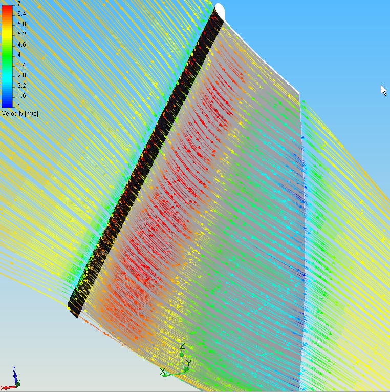

    Not much separation on a properly trimmed A-cat sail on the leeward side, at least... some on the edges around the foot & the head, but that's it, all leech most of the time attached. On the windward side there may be a large bubble (vortex) especially downwind. But as the illustrations from a study about 10 years ago show, you will not learn much about a 2D-study - the separation will be highly 3-dimensional.
  6. markdrela

    Thank you very much Mikko, for posting your A-Cat research,
    So the main separation to address is in a low velocity environment and probably accounts for little in the global section drag ??
    Is it correct??
    Can you disclose the freestream velocity assumption for this A-Cat simulation ?
    I guess it is between 1m/s and 7 m/s
    Always fascinating to run the simulations you post on a regular basis
    Regards
    EK
