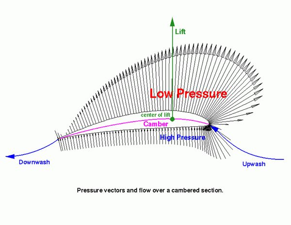

So I looked back at this posting of yours, and I still have a question.
1) Is this lift force you are talking about here primarily a force that would act perpendicular to an aircraft wing giving it lift?
2) Would much, or any, of this lift force at the rear of the sail's airfoil be driving a boat forward?
Perhaps what I am having trouble visualizing is how is the lift force that is being generated by the cambered sail getting transferred to the vessel. That force has to act upon something to transmit its force to the vessel. In the case of an airplane its the wing, in the case of a sailboat its the sail itself that's the initial element acted upon. I had asked related questions here:
Sail Loading on the Rig, Rig Loading on the Vessel
I assume there are a whole lot of little lift forces generated across the surface of the sail, that taken in total add up to the sum-total lift force. But those little lift force elements at the leech of the sail do little for forward drive of the vessel in my opinion?? Maybe this image I visualize very often has confused me?
It's not very useful to consider the loadings on the "leech" and "luff" regions separately, or on the mainsail and jib separately, because they always interact very strongly. The mainsail generates a big "drag", but in doing so it causes the jib to have a big "thrust". Of course what matters is the overall load, which is completely defined by the lift force perpendicular to the apparent wind, and the drag force parallel to the apparent wind.
In the 2D airfoil pressure force vector diagram you show, some of the arrows have a large "drag" and some have a large "thrust". But since this is a 2D inviscid flow, you can be 100% sure that the "drag" and "thrust" forces cancel EXACTLY, and the net drag is zero. It's not worth considering further.
Similarly, to determine the drive of any sail rig all we need to worry about is the overall circulation (which is determined mainly by the "leech return angle"), since this is what determines the overall lift. Twiddling with the jib shapes, slots, overlaps, etc., merely spreads this given lift among the various sheets, but it cannot change the overall lift.
The jib, slots, etc., are important only in that they affect the overall viscous drag of the rig. Redistributing the loads will also affect the yawing moment and the helm trim, so that's another but probably secondary consideration.
Remember that changing the shape near the leech affects the flow and pressure distribution over the entire sail.
Also, lift is defined as the force component normal to the approaching free stream, not normal to the local surface.
